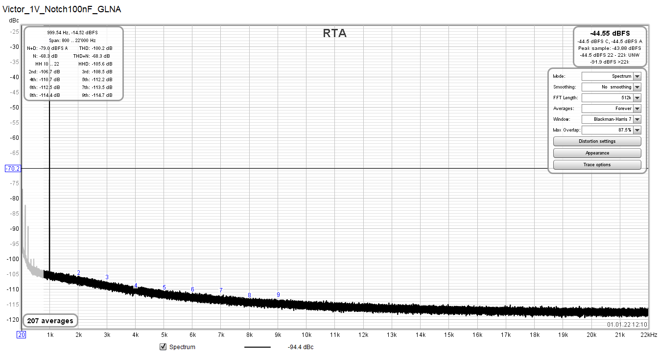

Victor's oscillator is normally delivered with an output voltage control.
I'm attaching a THD measurement of my example of the Victor's at an output level ov 1Vrms. The signal was passed through a notch filter and the residuum was subsequently amplified by a 60dB LNA.
Assuming that the 2nd harmonic is within the noise floor at -106.7dBc (as displayed by REW), and correcting for the 10dB attenuation of my notch filter at 2kHz, the 2nd is apparently at about -156dBc.
Similar values are customarily reported in this forum.

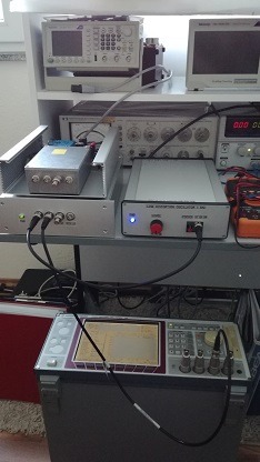

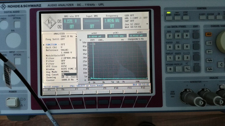

First I ask for your forgiveness for my bad English. I live in Germany. You're right. My Oscillators have all passive resistore attenuators in 10 dB steps at the output. The Pot for seeting the output level is conductive plastic and is located between the output buffer of the Oszillator and the Output Amplifier which drives the output resistor attentuator. I have made a lot of measurments to verify that the THD contribution of this conductive plastic Pot is negligible.
The measurement setup can be seen in the picture on the left. The device with the blue LED is the 1kHz oscillator. To the left of it the passiv twin T notch Filter (green LED). On the ground the R&S UPL Audio Analyzer. The Output of the oscillator is 2.5V RMS. The transfer function of the notch at 2 kHz is 0.3511 (--9.091dB). The gain of the post notch amplifier is 51 (34.151 dB). When you look at the FFT Output of the UPL you see the Fundamental at 1.00146 kHz with a level of 0.1591 V. The notch attentation of the Fundamental is about -58dB and with 34 dB amplification the result is 0.1591 V. The y-axis ist scaled in uV. At 2 kHz you can see a very small peak at about 2.5uV. To calculate the real level of the 2. Harmonic of the oscillator you must do the following calculation : 2.5uV/(0.3511*51) = 139.662 nV. The THD of the Oscillator is then : 20*log(139.662nV/2.5V) = -145.06 dB.
