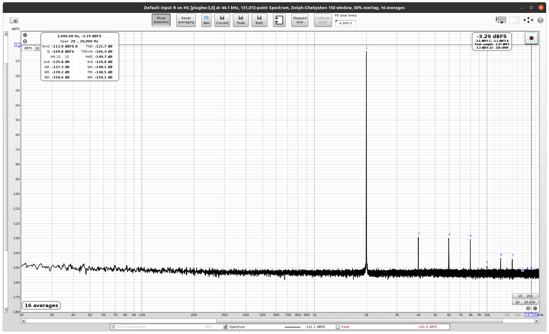

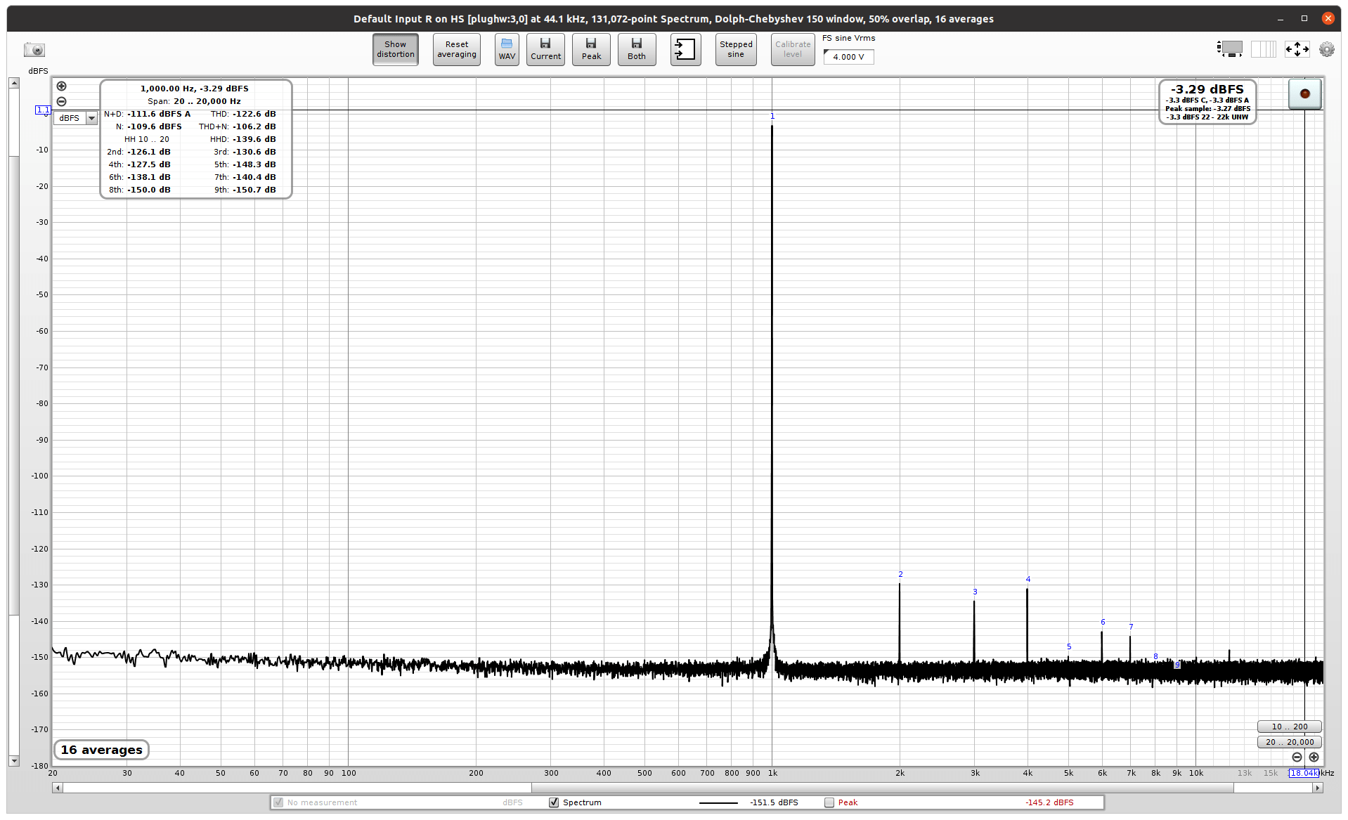

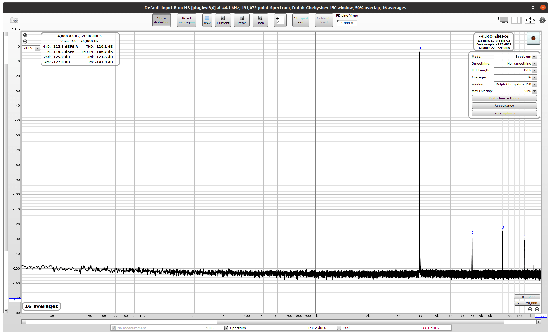

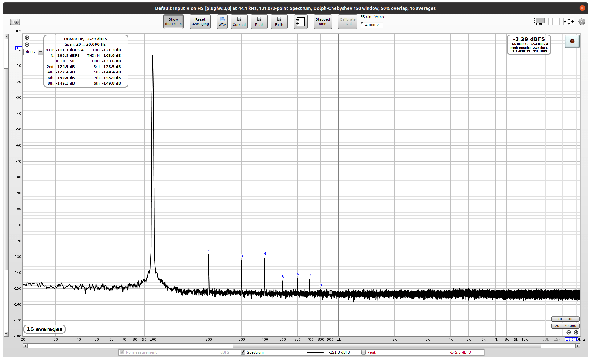

Is this with loop cable without notch filter?It is possible to get reasonable results without AP or low-distortion oscillators. DAC is AK4490 and ADC is AK5394.
Yes. No gimmicks (e.g. thd compensation) used. ADC and DAC are synchronized through my STM32F7 USBI2S bridge.Is this with loop cable without notch filter?
< -130dBc H2 and higher harmonics even lower look to good too be true for an AK4490 @ -10dBFS generator level (?).It is possible to get reasonable results without AP or low-distortion oscillators. DAC is AK4490 and ADC is AK5394.
Care to give some details, what's your secret? Are the result consistent when using a notch filter? Any checks on an AP or similar?
Yes, I agree my measurement seems too good. However I have built 2 of these AK4490 DACs and both measure about the same on both channels. I do not have access to AP but on another thread I have posted measurements of my ES9038Q2M DAC. The measurement setup was the same. Those results look fairly ordinary to me so I do not believe the measurement setup produces overly optimistic results. The random artefacts on those graphs are most probably caused by running DAC and ADC asynchronously. I have also made measurements of the AK4490 DAC using other ADCs. In all cases H5 and above were buried in the noise floor. H2-H4 were a bit higher. So it is possible that I have hit some sweetspot or some harmonic cancellation takes place. But it does not matter much to me as these DACs were meant as "listening DACs" (as Markw4 puts it) since AK4490 does not perform properly above 192kHz.< -130dBc H2 and higher harmonics even lower look to good too be true for an AK4490 @ -10dBFS generator level (?).

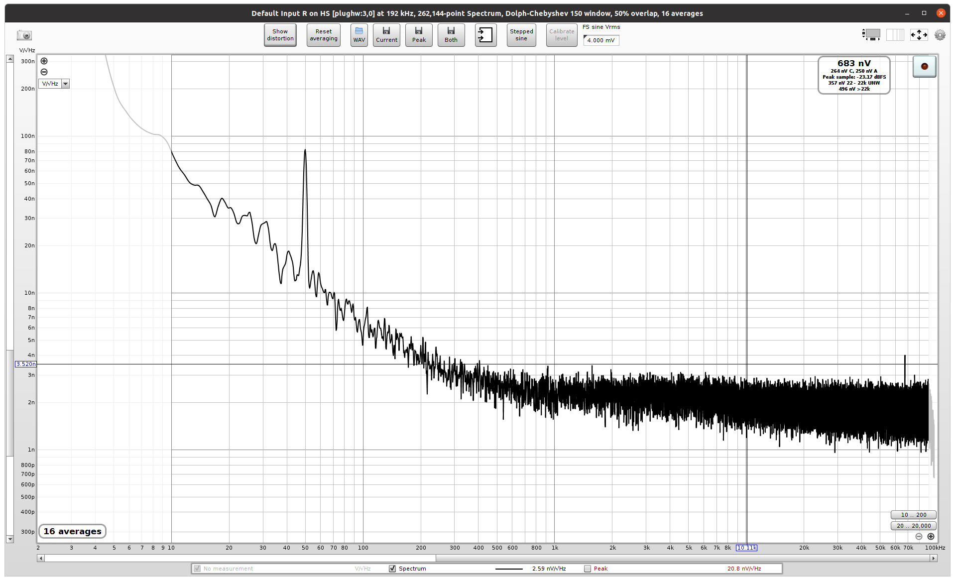

Regarding the DAC implementation my main focus has been on power supplies and output stage. Analog supplies have LT3042 regulators (separate for L and R). The power supply for DAC and ADC is a low-noise switching supply powered from a battery (5V power bank to be precise). If you think low-noise switching supply is an oxymoron here is the measured noise of the +15V opamp rail.
So the total noise from 10Hz to 90kHz is about 700nV. The 50Hz spike is due to measurement setup.
The output stage is also a bit unconventional. The first stage is single-ended with separate SE-to-balanced stage. This is the reason for the single-ended harmonic profile. I have tried more conventional balanced output stages with OPA1612 but these had higher THD. The opamps in the output stage are LM4562 as these produced the lowest THD. OPA1656 was about the same but OPA1612 was much worse (apparently I do not know how to use that). Resistors are MELFs and capacitors C0G or X7R. The large Vref capacitors are low-ESR polymers.
One more thing to mention is the USBI2S bridge (presented here). This makes it possible to run ADC and DAC synchronously which improves FFT accuracy and removes unwanted artefacts. So DAC gets the MCK, BCK and LRCK directly from ADC and USBI2S bridge synchronizes the DAC serial data to the ADC bit clock.

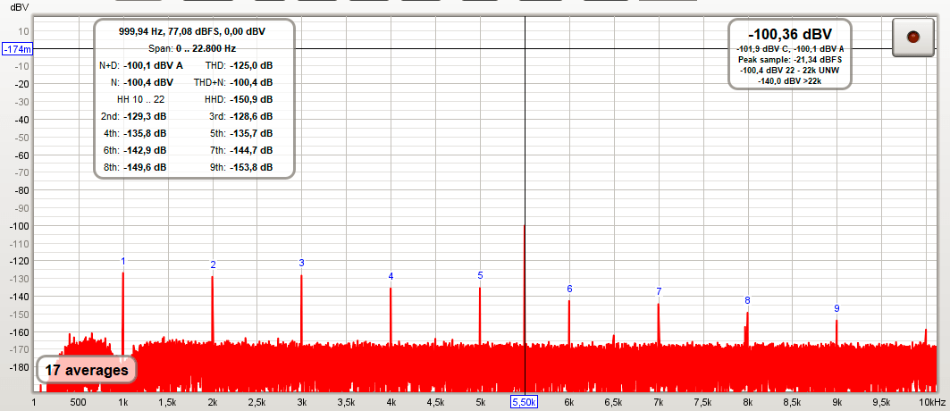

I'm seeing it all the time when double-checking results. Sometimes I see unbelievably stellar results in plain cable looback with my RME's but it's always cancelling at work. While cancelling for even order is quite commonly understood to happen, it also can happen for odd orders.
FWIW, this is the best I can get for 1kHz @ -10dBFS from the AK4490 in the RME, using the RME XLR output at +13dBu (other Ref.Levels are worse --> indicative of cancelling). I've used my AP as notch filter and makeup gain amp, with the front-end running with 15dB of headroom (to make its contribution low otherwise again risk of cancelling) and the residual then fed back to the RME's ADC.
Fully sync'd playback&recording, that is, allowing for rectangular window and block-averaging, done off-line (x100 int his case, to illustrate that point as well). The resolution increase is significant but useless in the end as the AP's frontend and notch is not likely to be better than -140dB best case. But theoretically I would be able to see stuff at -160dBc here.
The 5.5kHz needle is the -100dB (wrt to fundamental) pilot tone, for leveling etc. Plots says dBV units but it's actually dBc, of course.

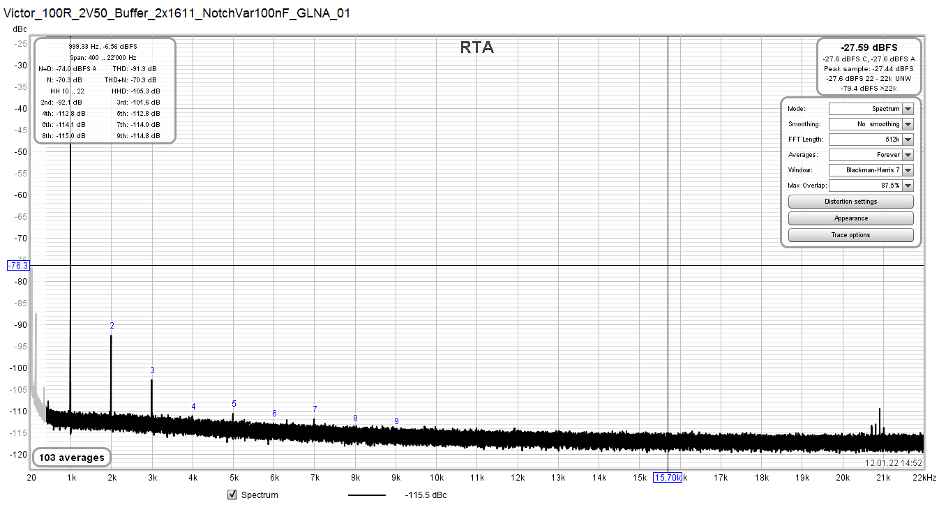

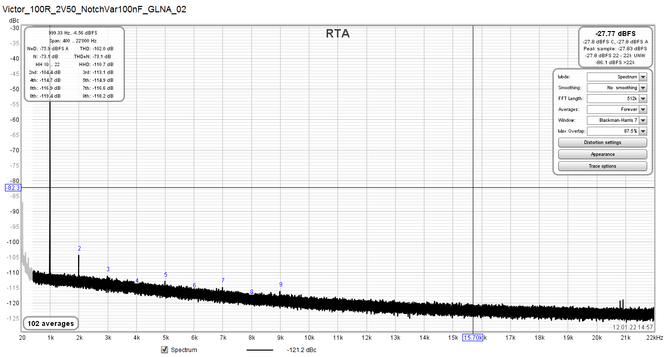

FWIW here is my take at an OPA1612 buffer for my 2005 Victor's.
I modified it by changing the 600R output makeout resistors to 100R and wanted to add a buffer.
My first attachment shows the spectrum of a 2.5Vrms oscillator output passed through a notch filter and Groner's 60dB LNA. The 2nd is at -154dBc.
Adding the buffer (master/slave topology, noninverting input) increased the 2nd by 12dB and added a 3rd one (2nd attachment, 2x1611 means a single 1612).
