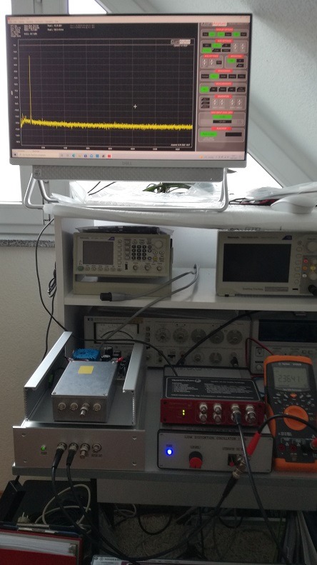

The measurement setup can be seen in the picture on the left. The device with the blue LED is the 1kHz oscillator. To the left of it the passiv twin T notch Filter (green LED). On the ground the R&S UPL Audio Analyzer. The Output of the oscillator is 2.5V RMS. The transfer function of the notch at 2 kHz is 0.3511 (--9.091dB). The gain of the post notch amplifier is 51 (34.151 dB). When you look at the FFT Output of the UPL you see the Fundamental at 1.00146 kHz with a level of 0.1591 V. The notch attentation of the Fundamental is about -58dB and with 34 dB amplification the result is 0.1591 V. The y-axis ist scaled in uV. At 2 kHz you can see a very small peak at about 2.5uV. To calculate the real level of the 2. Harmonic of the oscillator you must do the following calculation : 2.5uV/(0.3511*51) = 139.662 nV. The THD of the Oscillator is then : 20*log(139.662nV/2.5V) = -145.06 dB.

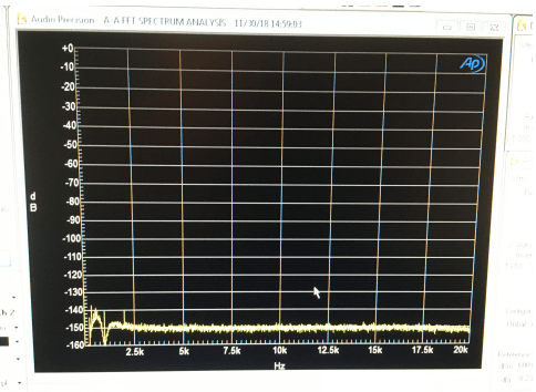

ok sorry. If there is a better version, I would be happy to see a measurement of a current version on an AP or R&S device or any other professional equipment. By the way, here is an AP SYS 2522 test of my first professional 1kHz oscillator built in 2018. THD is -140dB at 1,65V RMS . This is exactly the same value measured on my R&S Analyzer with passive Twin T Notch .

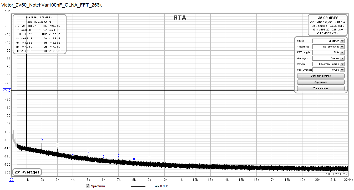

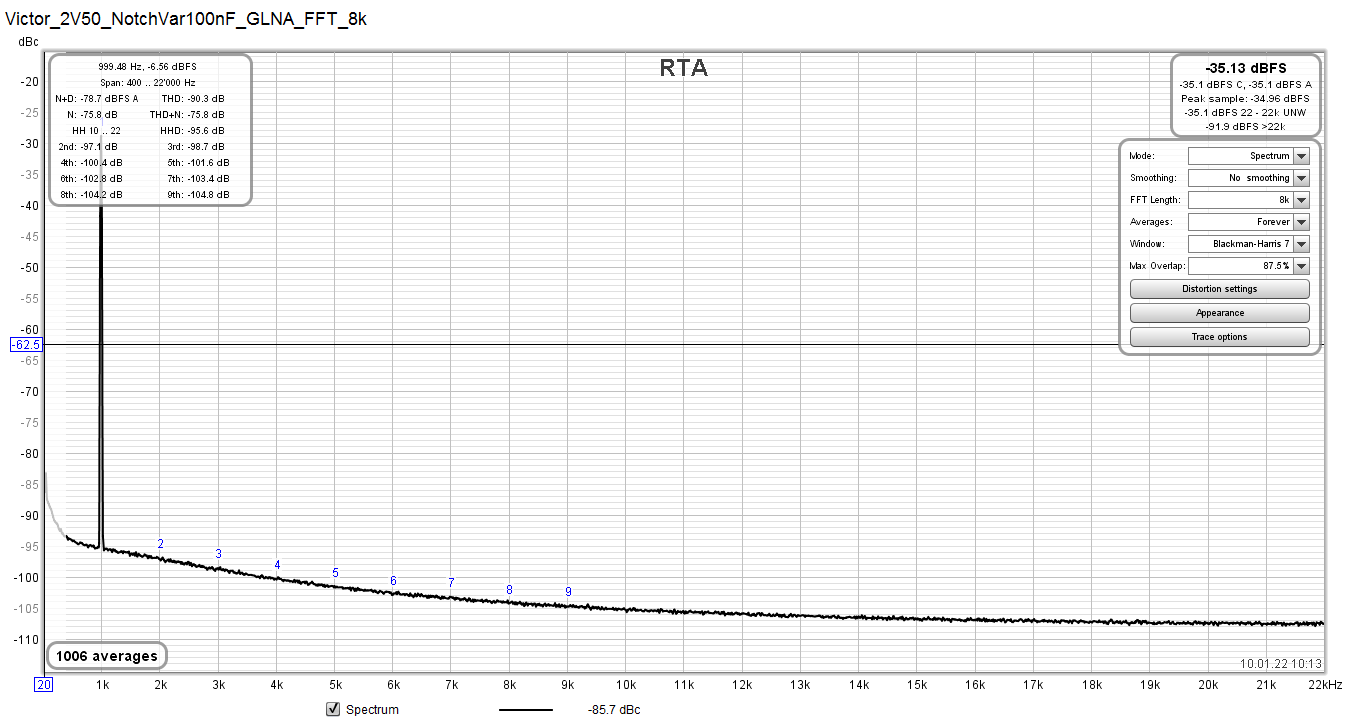

Your math is corrrect, but I wonder why you're using such a short FFT (8k, if I'm interpreting the numbers on your screen photo correctly). Your harmonics are then very close to the noise floor, making the readout error prone.
For illustration, a measurement of my oscillator at 2.5Vrms and analysed by a 256k FFT shows the 2nd harmonic at -109.6dBc (first attachment), whereas an 8k FFT shows no harmonics at all due to the noise floor having been shifted upwards by 15dB because of the lower FFT processing gain (second attachment).
As a matter of fact, I would expect still better performance numbers of your oscillator if you would use a longer FFT and more averaging.

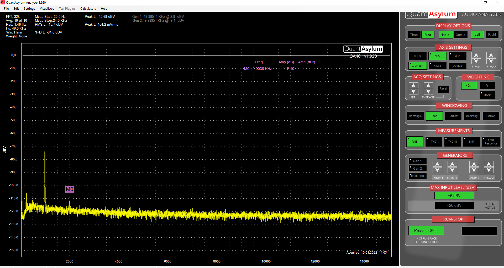

the R&S UPL Audio Analyzer uses Zoom-FFT. Therefore I do not think that frequency components 2H 3H etc. are lost here. I also have a QA 401 and measured the same Oscillator with 32k FFT and 10 Avg with the same Notch. The output of the oscillator is 2.3634V (Agilent U1252B) . The FFT Plot of the QA 401 shows -112,10 dBV at 2kHz. These are 2.4831 uV. The real level of the 2H is then 2.4831uV/(0.3511*51) = 138.67 nV . THD is 20*log(138.67nv/2.3634V) = -144.63dB. Very close to the UPL measurment with -145.06 dB. Error about 0.3%. So you do not need expensive audio analyzers to verify the design of a good analog oscillator. My R&S UPL machine was built in 1996. But the perfomance of successor version UPV is not better in analog area.
