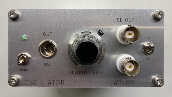

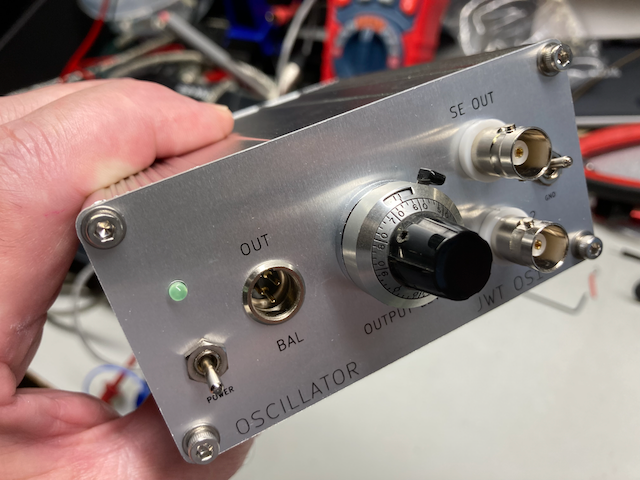

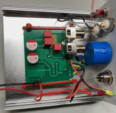

Victor's oscillator in a box
I decided to build a slightly more professional-looking enclosure for Victor's oscillator. Better shielding and improved connectors were the main goals. Similar to my stepped attenuator, I put it into a small 50x100x100 mm aluminum case. I designed the panel in KiCad and had it fabbed in aluminum by JLCPCB.
I replaced the level control with a 10-turn pot and vernier dial. The RCA jacks were replaced with BNC connectors. I made provisions for a future differential output, probably consisting of an OPA1656 on a small piece of perf board (I don't have anything to test yet that has differential inputs).
Power comes from an external battery box with 4x 9Volt batteries.
Cheers

Thanks - I thought about that but decided to go with insulated jacks and have a chassis ground lift switch which optionally grounds the shields to the chassis.
In a complete instrumentation setup, I can ground the boxes externally in a star configuration which would avoid loops caused by the shielded cabling. That is why balanced operation would be ideal.
Of course, the whole mess could be in a Faraday cage.

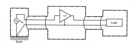

Nice work ! If you want the shielding to be effective, get rid of the insulated BNC connectors.
You have to make provision for the shielding to be earth-grounded. Illustrated in Morrison (Grounding and Shielding Techniques for Instrumentation) :
wtnh: What is origin of your 10-turn potentiometer? I used inexpensive chinese clones of blue Bourns in older builds of my distortion calibration adapter and about every second piece introduced H2 and/or H3 distortions at levels seriously above expected performance of the Victors oscillator. You would do not want that in your nice instrument.
Yes - the pot is one of those suspects. It does say Bourns - Mexico. It is wire-wound. Surprisingly, it is very smooth with no noticeable dropouts from end to end.
I would not use one of these in a signal-passing analog circuit. In the case of Victor's oscillator, it is used only to set a DC voltage in the AGC circuit - see his recent schematic in this post.
