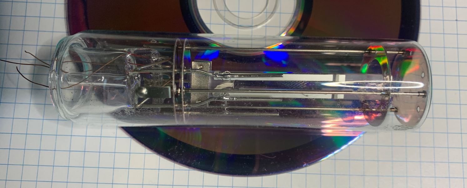

I have seen 1 KHz crystals, and I might even have one. They are huge! Very vibration sensitive.
I have overloaded and broken a 1kHz crystal in the middle of the night
Anybody who wants to try that needs take care, start with small load resistors below 10k, increase in 1k steps, startup is very slow, can be 2 minutes before anything is visible. If you hear the crystal singing, amplitude is near what is not safe anymore.
Well, vibration is the main feature of a vibrator like this ..

Yes, they are very fragile. Even mechanical shock for these ones are an issue. I found it was too sensitive to vibration even after using soft rubber shock mounts from a CD mechanism. Never got to the point where I was looking at harmonic content.

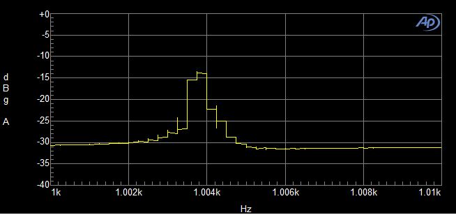

Low frequency crystals have large series resistance on resonance. Here is a frequency responce with 100k load. I have few 1kHz tuning forks, let me know if you would like to play with them.

Yes and they have series resistance 100k. The tuning forks I have came from different manufacturer: QK Type 30The crystals in that PDF seem to go down to 30kHz only ?
Yes, series resistance ~300kDid you measure by yourself ?

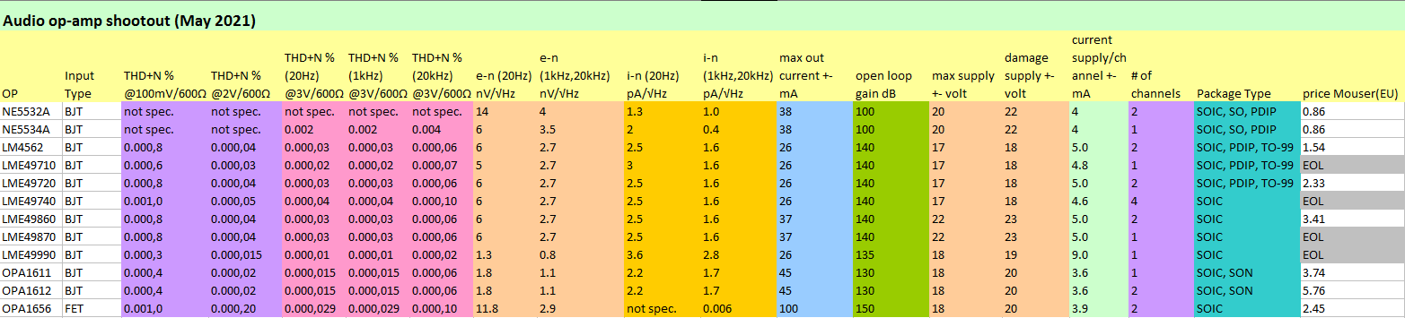

This is a nice chart and summary. It would be nice if there were several JFET op amps. The only FET op amp is the OPA 1656, which is a CMOS op amp. It is a marvelous accomplishment as an op amp. While its noise at 1 kHz is quite low, it has a quite high 1/f noise corner frequency, which is often the case for MOS transistors.
Bob
Bob
The OPA1656 is an exception as it is used for Viktor's 1 kHz oscillator. The OPA1656 is best suited for this application.
