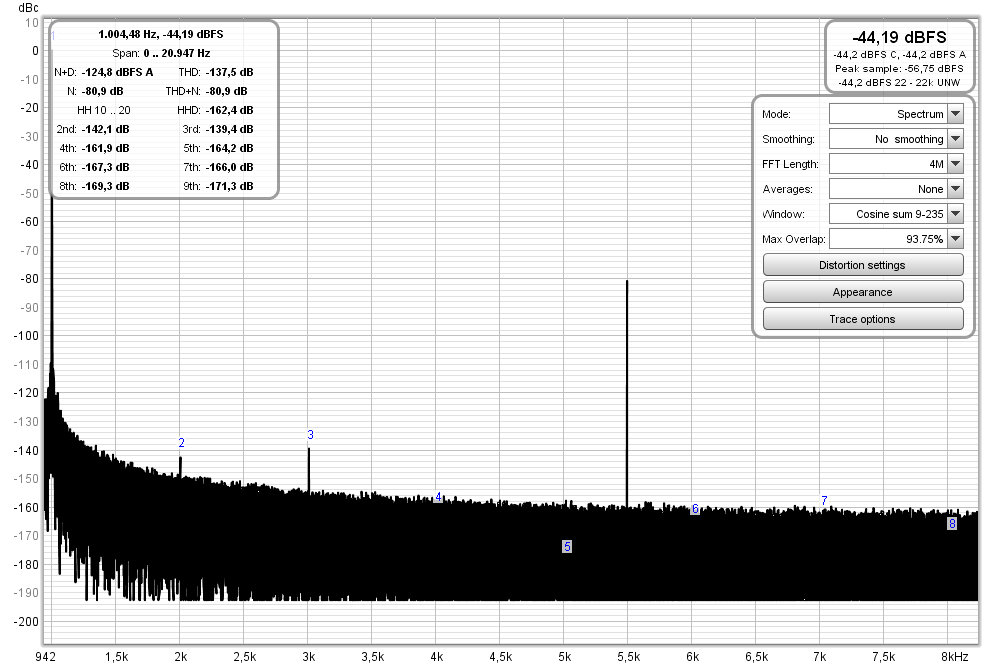

See below plot at 768kHz, mono mode, inputs terminated with 50Ohm (RME ADI-2 Pro FSR, +4dBu ref. level).
At 100kHz we've lost 30dB to the noise floor value at 20kHz.
But with a notch attenuation of, say, 80dB and hitting the ADC with -30dBFS (so same circumstances as I showed in post #9524) we can still go down do -150dBc for a 100kHz component.

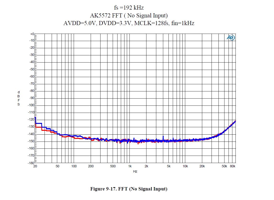

Ok. That looks good and much better than the AK5572 evaluation board (below).
KSTR, I notice a spur at 8kHz and its harmonics.
8kHz is USB2 microframe frequency. Perhaps that being the culprit?
Correct, but look at the orders of magnitude! That little 8kHz spikey is more than 40dB below the 20Hz..20kHz rms noise floor (and some 20dB below 24bit resolution, mind you, only captured by the self-dithering from the random noise). It's not even visible in a 4M FFT without averaging.
Note also that at 768Khz the packet size is large, increasing packet noise. At 44.1Khz there is not even a hint of it even when maxing out all possible resolution (there are some other "birdies" now, equally utterly irrelevant).
The interface is hooked up as isolated and floating as it ever gets, practically. USB feed is via Intona USB2 Isolator which reduces 8kHz packet noise and does full galvanic isolation, and the supply of the RME is ultra low-leakage medical DC/DC. I actually do "hot wire" measurement with this setup.

Here we go....
I wasted half an hour or so because the pilot level was way off at first (too high, also varying a bit with frequency, wtf?) but after looking closer on the board I saw it has 600Ohms output impedance (correct to the schematic that I should have checked first, meh), so I had to reduce the pilot send level accordingly. It also means the notch correction is off at higher frequencies, for the harmonic levels and the 5.5kHz pilot (by ~1.5dB).
Test level was 1Vrms, at this level this first generation Viktors still does pretty well. At 1V the notch distortion will be somewhat lower, too. Still enough uncertainity here, of course.
Looking at the osc with a faster real-time FFT (32k) showed a lot of fluctuation of H2 level and general noise floor jumping up and down (LM4562 popcorning)

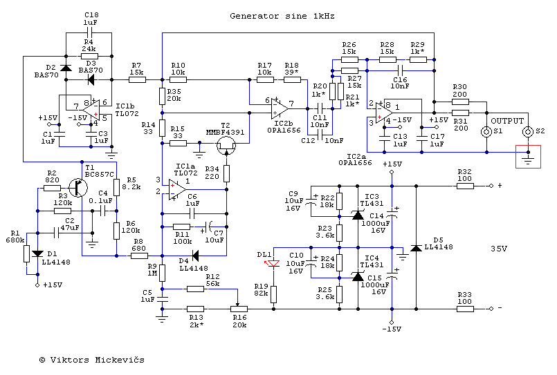

New revision of the oscillator board has been made. Now the AGC fet is connected to the non inverted input of the opamp. This configuration is less sensitive to interference, less parasitic capacitance at the inverted input of the opamp and also the signal over the fet can be two times lower due to the non inverted gain of the opamp.
Vic.
The RCA connector is still connected to GND right?
TJ.
