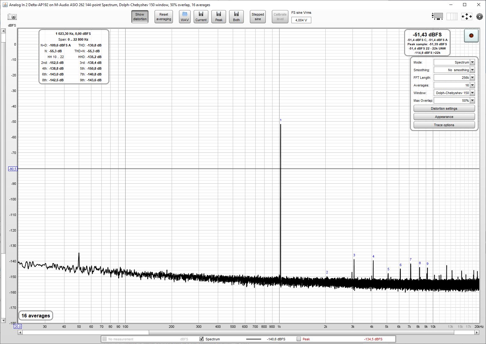

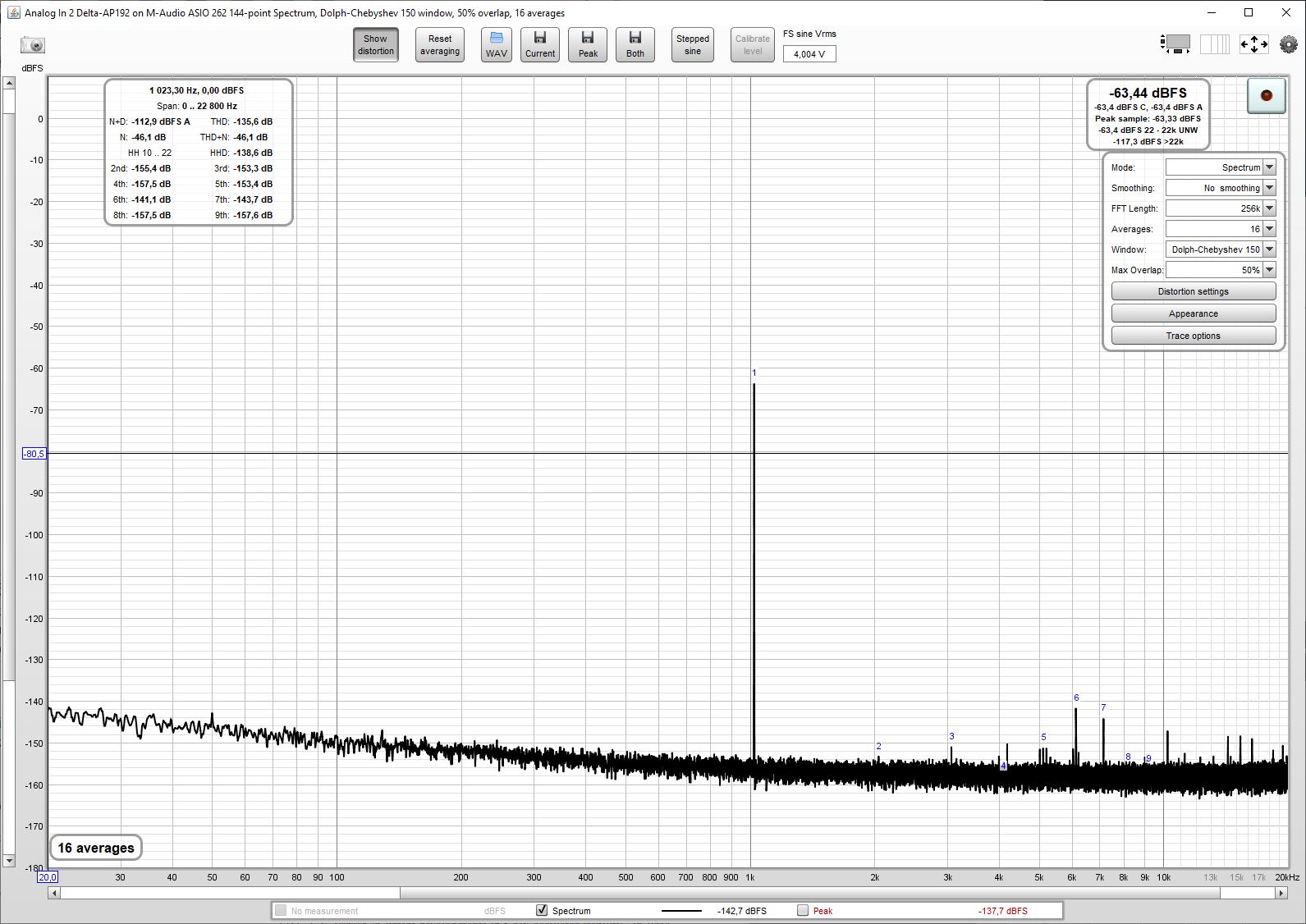

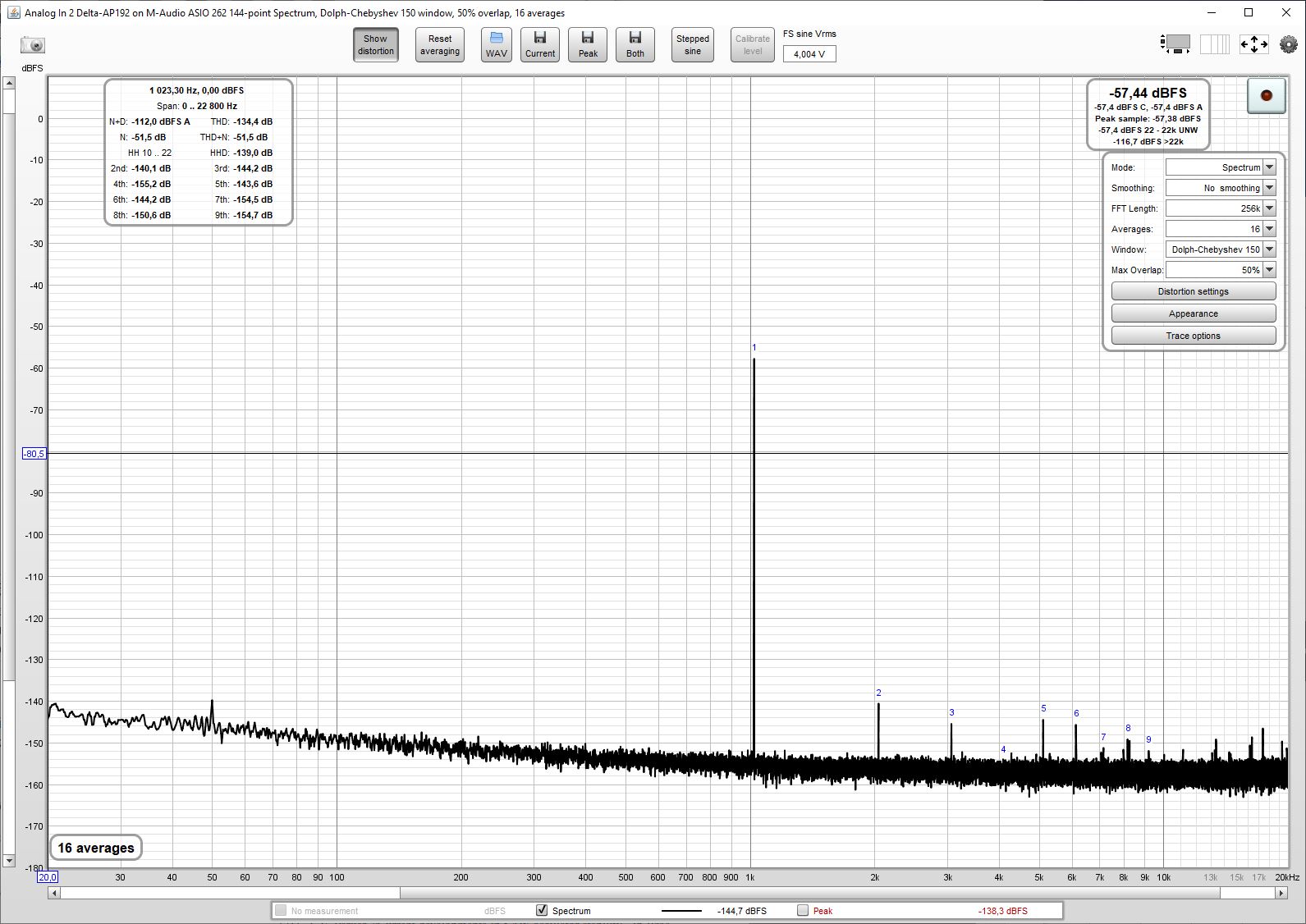

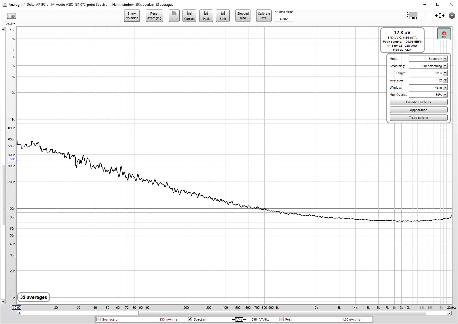

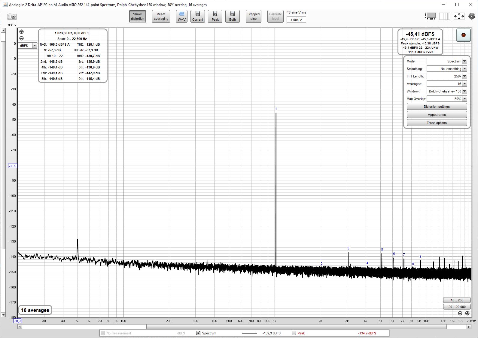

At such low THD levels (<-130db) it is very difficult to obtain consistent results using DIY equipment. Here is a set of measurements to illustrate this inconsistency. The setup in all graphs is the same:
1. Victor LDO balanced output
2. Balanced Twin-T notch (about 64dB)
3. Autoranger mkII
4. M-Audio AP192 soundcard (AK5385 ADC)
The LDO output is set to be same as soundcard FS (4Vrms). In the graphs the Autoranger gain is increased from 0dB to +18dB in 6dB steps. As can be seen the HD levels do not increase consistently with the fundamental. This is probably due to ADC. HD cancellation may also have some impact.

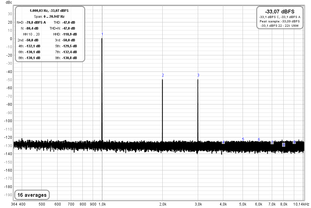

Assumed a notch depth of 80dB and H2 and H3 at -130dBc, ADC distortion is non-existent. H2 and H3 levels are reported exact to 0.1dB (== no cancelling/addition) and no higher components are seen either. 50dB++ of noise headroom left (assuming we would dig down that deep in the noise floor, not possible of course with a non-synced oscillator). So we could go down to -180dB, theoretically.
This was with the 4493 as DAC (at -30dBFS, where it is good to at least -120dBc on its own) to emulate the notch+LNA output...

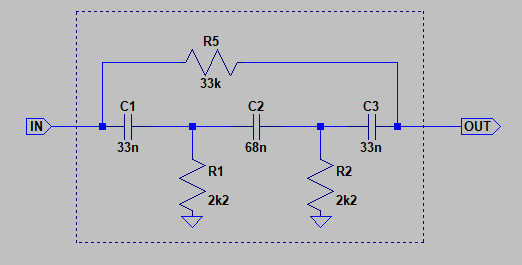

The distortion of the notch is unknown (I'm using WIMA polyprops and off-the-mill metal films).
Bad memory here. I opened the notch and now see I've used large metallized polyester (PET) in that one, which are not the best for distortion (and especially not the 63V types).
Simply reversing the notch -- it's symmetric wrt input/output -- changed H3 by more than 5dB to the worse... so this looks like cap distortion contributing to the higher H3 I'm seeing here. The first cap in a Hall notch sees almost the full voltage across itself (80%).
EDIT: Circuit attached.

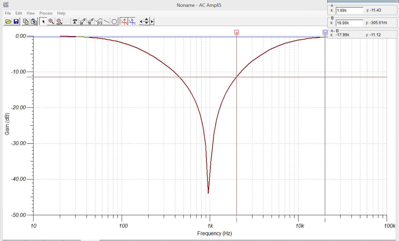

In simulation, that notch filter is -11db at 2kHz with a total notch depth of ~ -43dB (this was with 1% resistors, 5% caps).
So I guess any calculations take the -11dB at the second harmonic into account? As surely you would have to add 11dB to the measured THD not so?

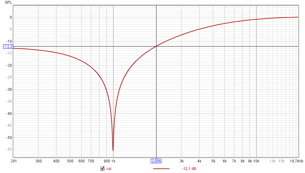

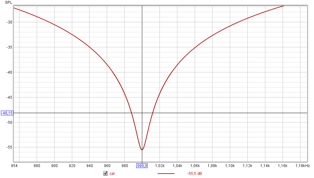

Correct. This is what the "soundcard calibration" with REW affords automatically.
Key is *not* to use the "soundcard calibration" feature directly, rather make a normal measurement 0..22050Hz with the notch in place and equal level settings for DAC and ADC (44.1KHz, -3dBFS send level, 512k sequence length, 4 repetitions), export as text, then load it in Preferences-->Calibration. Then remeasure to check if the result is completely flat (you may or may not see a noise wiggle at the notch frequency, depending on depth of the notch).
Attached is measured notch in LoopBack with 10k load-impedance (and 100R source impedance). Because of the high impedance below notch freq, the FR drops significantly from the 10k loading. That's why I designed this notch to be rather low impedance.

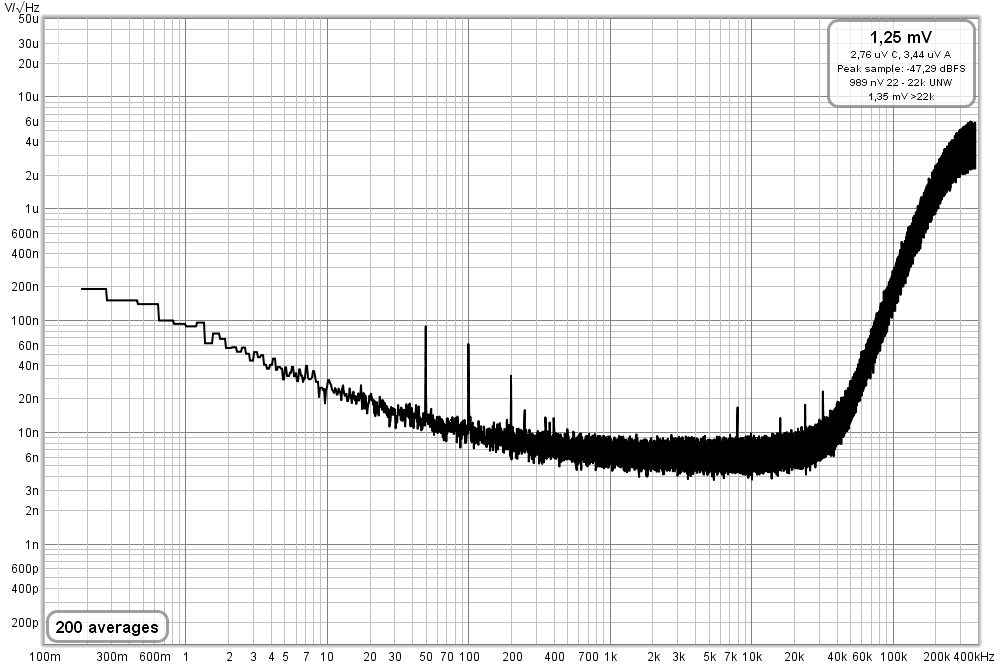

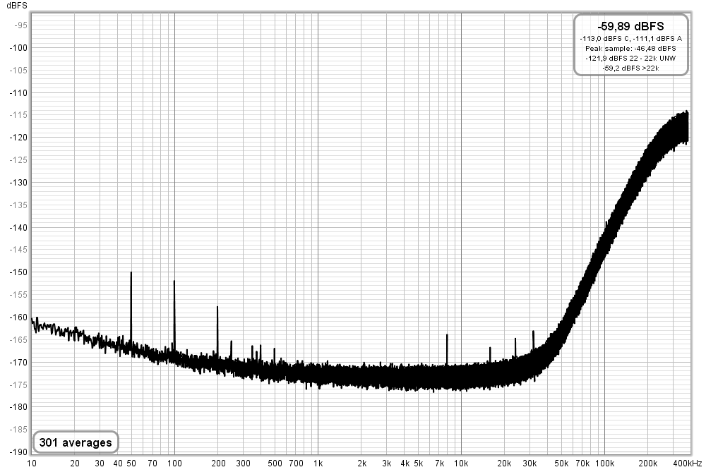

I don't think that's an issue at all.
See below plot at 768kHz, mono mode, inputs terminated with 50Ohm (RME ADI-2 Pro FSR, +4dBu ref. level).
At 100kHz we've lost 30dB to the noise floor value at 20kHz.
But with a notch attenuation of, say, 80dB and hitting the ADC with -30dBFS (so same circumstances as I showed in post #9524) we can still go down do -150dBc for a 100kHz component.
The much bigger problem of the AK5572 is the passband ripple in 1x, 2x and 4x modes and the aliasing. It's an audio ADC, clearly not a measurement ADC. Best used at always the highest sample rate and then downsample properly in case it is needed.
EDIT: also added the same measurement in rtHz scale. Noise is contributed by OpAmps and analog front-end in general (and also from the voltage reference), so we can only say the self-noise of the AK5572 is no higher than this (note: Peak Noise is about 8dB higher)
