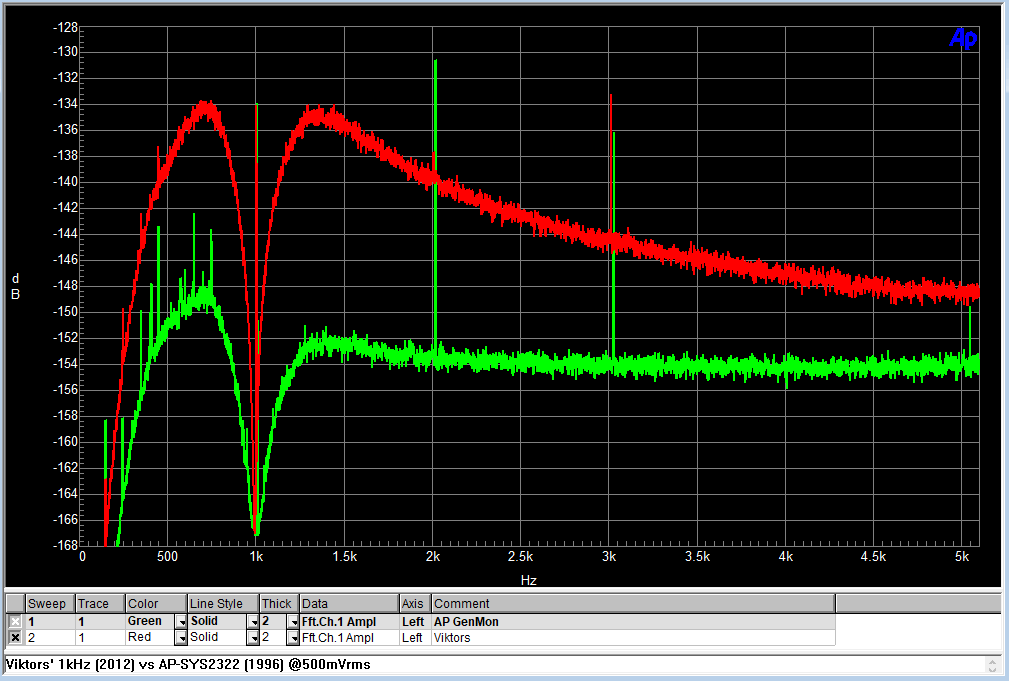

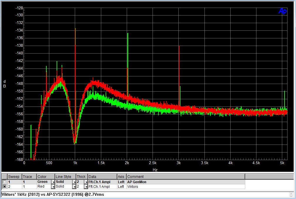

FWIW, I've measured a Viktors 1Khz Oscillator built in 2012 (so, an early revision) and compared it against my SYS2322 (from 1996), squeezing the last bit of resolution (not accuracy) out of the AP.
I've used two signal levels, 2.7Vrms (max on the Viktors) and 500mVrms.
Viktors' Oscillator was powered by a Tek PS503A and was put in a grounded metal case (cookie box).
At 2.7Vrms, the AP's Generator Monitor reads H2: -135dB and H3: -148dB, and some H5 at -150dB.
The Viktors has lower H2: -144dB and higher H3: -138dB. It also has less mains harmonics but a higher noise skirt around the fundamental.
At 500mV, the AP is at H2: -131dB and H3: -136, and again H5: -150dB.
Viktors' Oscillator again has lower H2: -138dB and higher H3: -133dB.
The noise skirt scales with the level change, so this suggests it is a constant noise form the supply (TL431's are noisy down low) and/or the LM4562's modulating the oscillator ever so slightly.
At these levels we never know how much cancelling of harmonics at various places in the chain may or may not be present so those readings sure must be taken with a grain of salt. Higher harmonic levels at lower source levels for both generators doesn't sound correct, after all, so I assume significant cancelling here. One would need to install a LowPass filter á la Pavel Hofman (phofman) to use the phase shift to see if harmonics change as expected or if just the amount of cancelling has changed, giving new "random" levels.
Nonetheless, the performance of either generator is excellent as -130dB should probably be a safe upper limit (-130dB is actually the spec of the AP).
It'll be really interesting to compare Viktors' lastest incarnation (with the OPA1656 and the gain cell placement change) but me thinks noise-wise the TL072's and the supply regs might be dominating... maybe I'll make a copy of it with LT3042/LT3093 supplies...

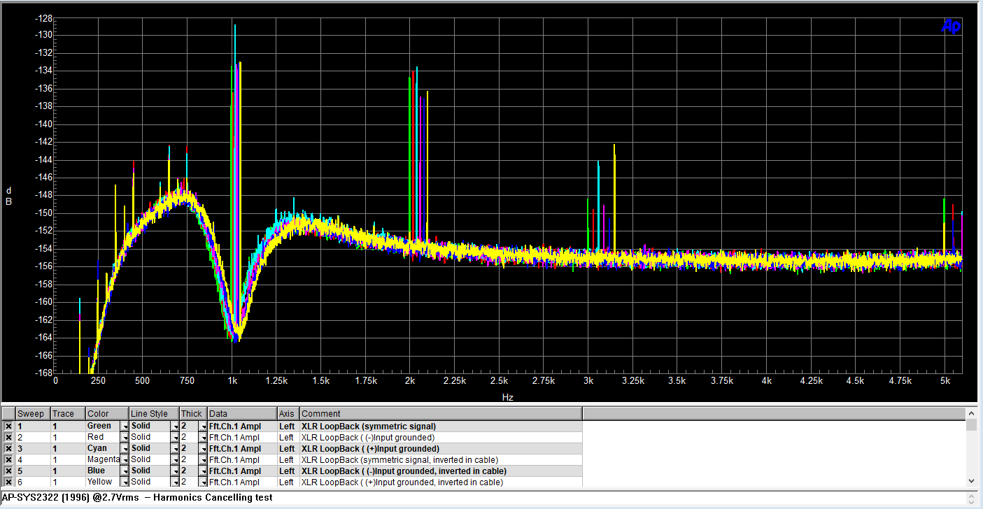

AP in Loopback to test some HD cancelling effects.
Not much going on for H2, but H3 is all over the place depending on exact hookup of the generator to the analyser.
H5 for the higher 3 frequencies is already aliasing, so ignore.
Also, fundamental attenuation varies some 7dB but this is related to the change in test frequency, with the AP notch running counter-tuned. When the notch doesn't null equally I see another 2dB of variation in H2 for the same test condition except for change of frequency.
Bottom line: below 130dB this is just reading tea leaves...

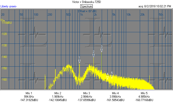

I think you could safely say the uncertainty of measurements of harmonics below 120 dB Fundamental is probably +/- 5 dB or more. And probably beyond useful information.
Attached is a plot of my Victor oscillator with a Shibasoku I made in 2018. The Victor is battery powered.

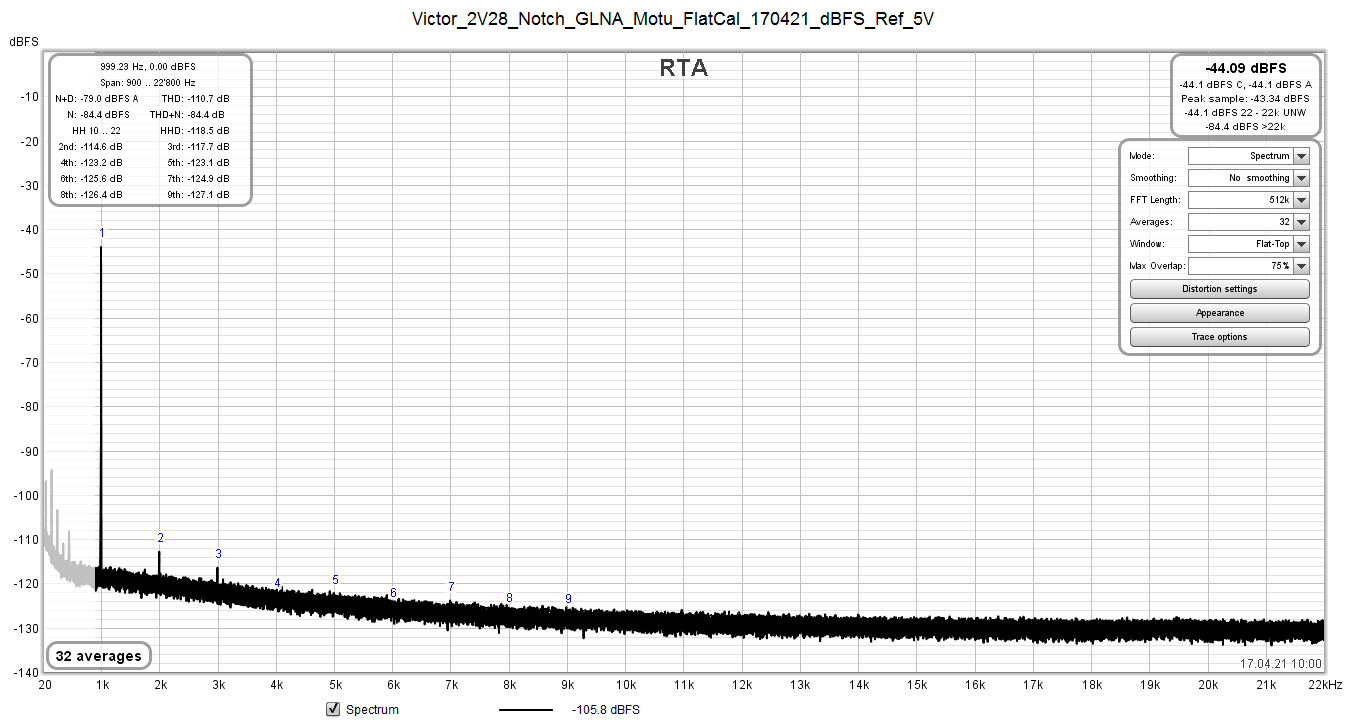

bohrok2610 said:
The fundamental at -24.31dBFS makes sense: Victor(2.28Vrms)+notch+LNA=-6.8-77.5+60=-24.3
What is confusing is that in your earlier post #9461 in the 4th graph the fundamental was at -37.53dBFS. Why the difference?

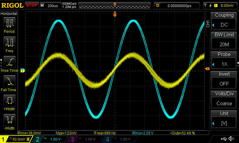

The residual level is not the same in all measurements because the notch frequency in my filter is adjustable within a range of ±5Hz. Carefully adjusted, the notch depth can be lower than -100dB.
For example, in the first attachment below, the notch depth is -96dB (referred to 2.25V) and the adjustment is almost perfect. The resulting spectral analysis shows a residuum level of -44.09dBFS.
The supression of the fundamental is not critical, so I do not always strive for an absolute minimum - it drifts during the measurement anyway.
Braca

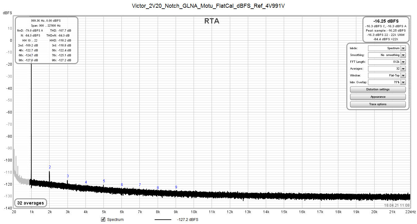

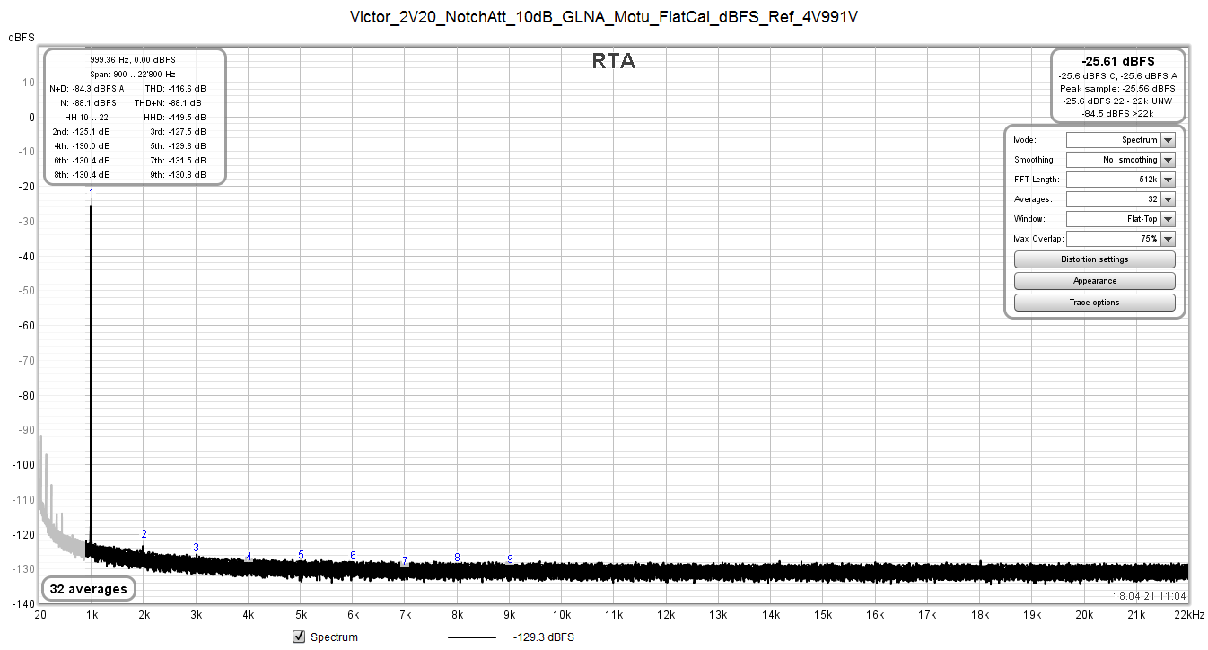

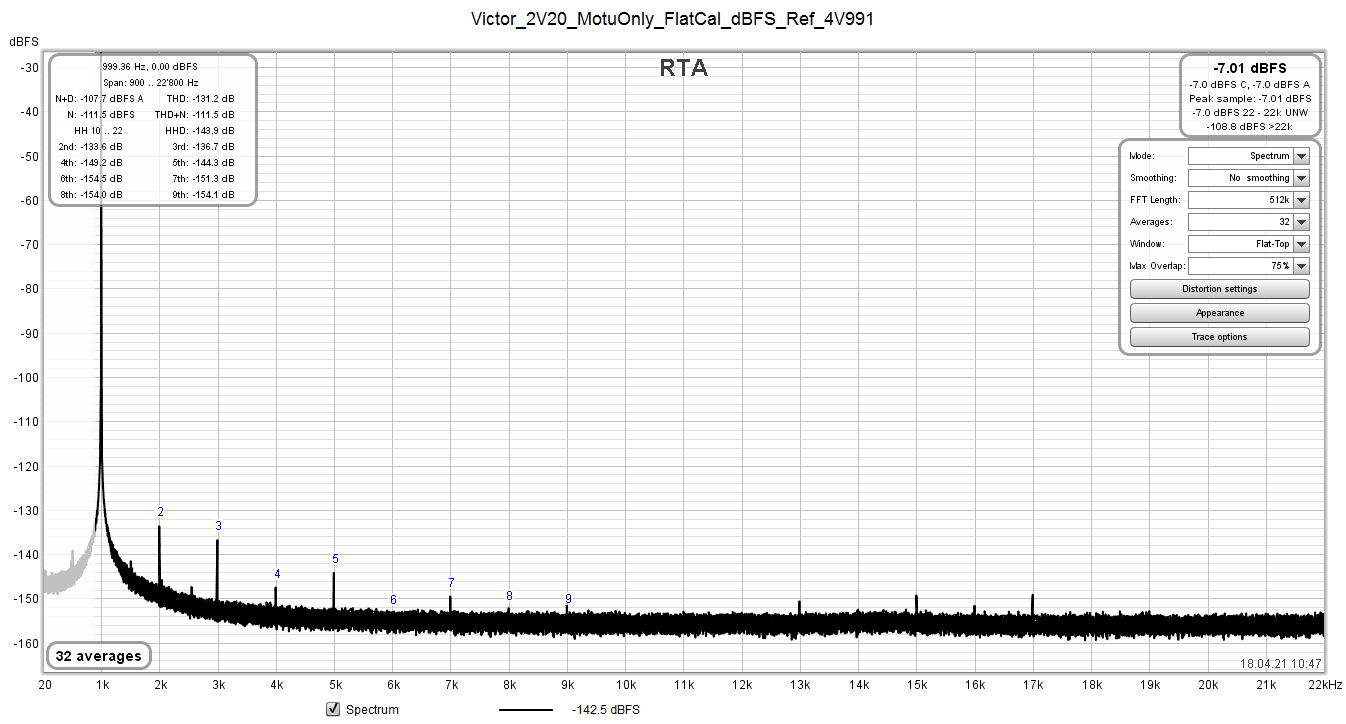

Since notch depth of -100dB is not needed for this measurement could you make a set of measurements with the -77.5dB notch (or even -70dB if possible):
1. Victor LDO@2.28Vrms (without notch or LNA)
2. Victor LDO@2.28Vrms + 77.5dB notch
3. Victor LDO@2.28Vrms + 77.5dB notch + 60dB LNA
With these measurements it may be possible to see if there is HD cancellation caused by your notch and LNA.
/Martti
Hi Martti,
Here are the measurements.
The first att. shows the oscillator spectrum as seen by the Motu ADC. Note the small spikes at the multiples of 508Hz, which have nothing to do with the oscillator.
The second spectrum was obtained with the notch filter between the oscillator and the Motu. The fundamental's attenuation was kept at about 70dB. The apparent 2nd harmonic is false (as mentioned above), and represents an internal interference, generated either in the Motu or in the laptop used for the measurements. The same is true of the 8 and 16kHz lines, but here I know that their source is in the laptop. RTA correctly ignores the parasitics, thus practically the same levels of all the distortion harmonics. None visible, though.
The third spectrum was obtained with the LNA between the notch and the Motu input. The fundamental is off by 1.5dB, but I noticed it too late to correct the notch attenuation and repeat the measurement.
Samuel's design provides for attenuation at the notch input as a "sanity check", and the fourth att. shows a spectrum with the notch input signal attenuated by 10dB. The 2nd is now reduced by 16dB which may indicate cancellation. However, since the oscillator sees a higher impedance when the attenuator is in the circuit (26k vs. 11k) there may be a small effect there as well.
Time permitting, I'll look into this at longer FFTs.
Braca
