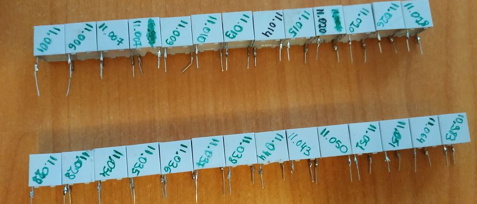

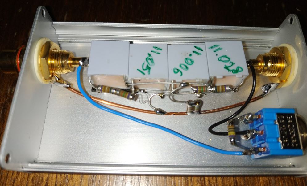

About the noise. I am using Hanning window and 0.7Hz resolution. Hanning has 1.5 * bin resolution of noise eq. The noise in db should be very close to the real values (-180db=1nV/sqrtHz). I measured the notch, that was used for the measurements and it has noise. More in the low frequency region and decreasing in high frequency. Combined with 20db amplifier the noise floor rise to around -140db (100nV/sqrtHz) around 2kHz. That is why i cannot measure anything below.
It seems a picture to a private message cannot be attached. Nevermind. 🙂 It is better to share some of the info about the notch here.

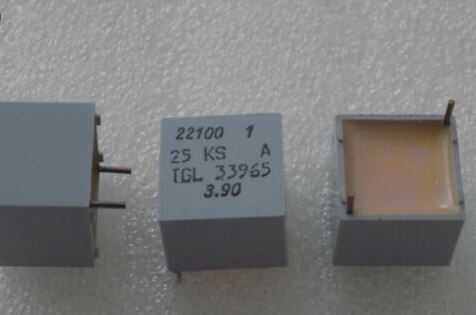

I used old German NOS stock. 1% polystyrene. Like the ones in the mid. picture but 11nF. Measured at 1kHz test frequency on an Agilent 4263B LCR meter. Resistors are 0207 MELF 0.1%. I can upload the exact used cap. and res. values the late evening.
Sorry for the picture heavy post.

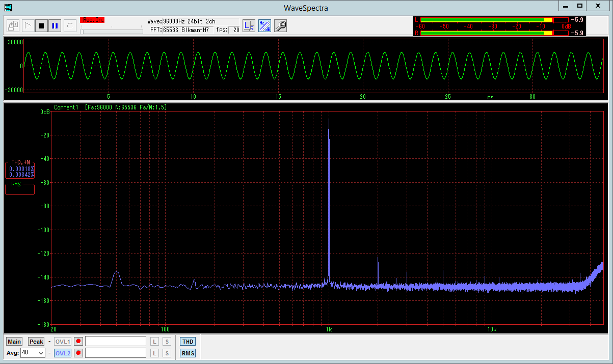

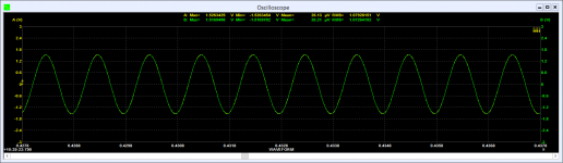

THD is ~0.00018% / THD+N 0.003% (this differs between Virtins Mi and Wavespectra)
Virtins:
2nd harmonic: -132dB = 0.00002%
3rd harmonic: -141dB = 0.000008%
Wavespectra:
2nd harmonic: -123dB = 0.00007%
3rd harmonic: -136dB = 0.000015%

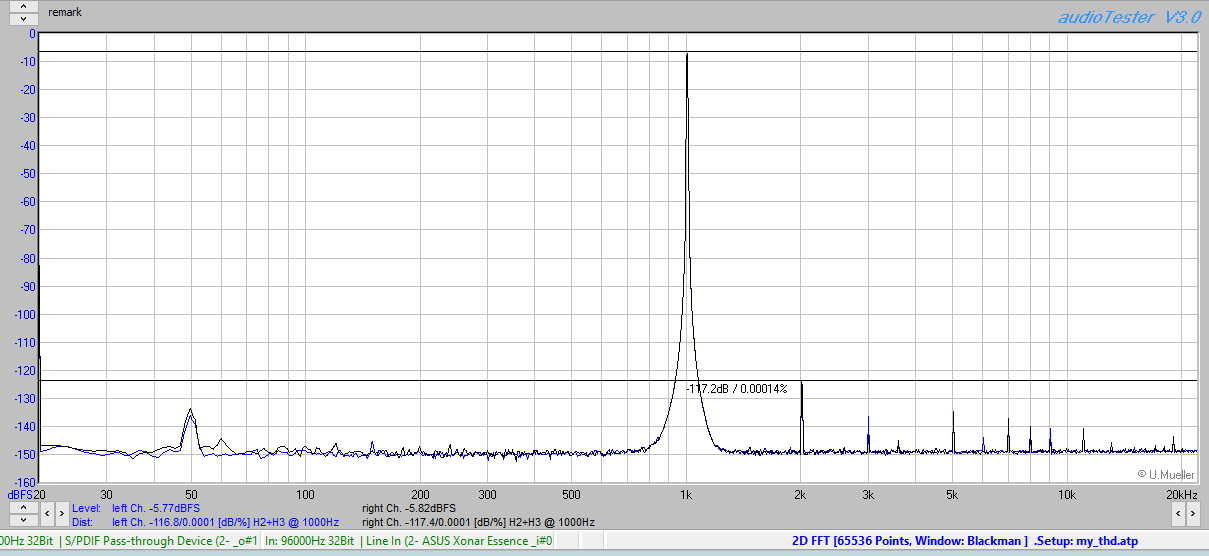

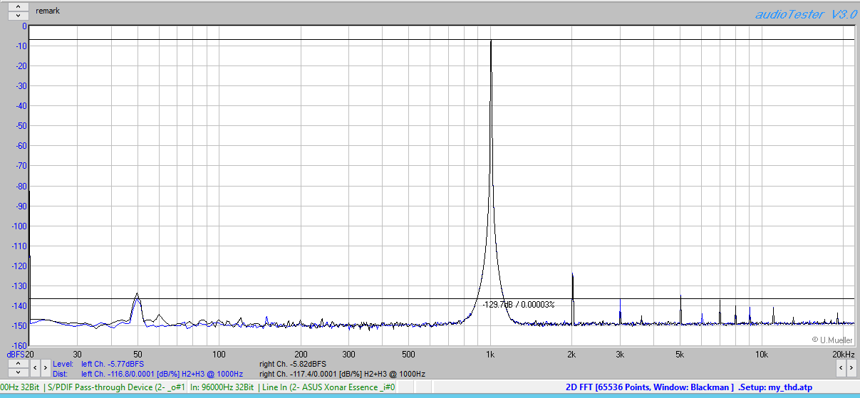

AudioTester:
2nd harmonic: -117.2dB = 0.00014%
3rd harmonic: -129.7dB = 0.00003%

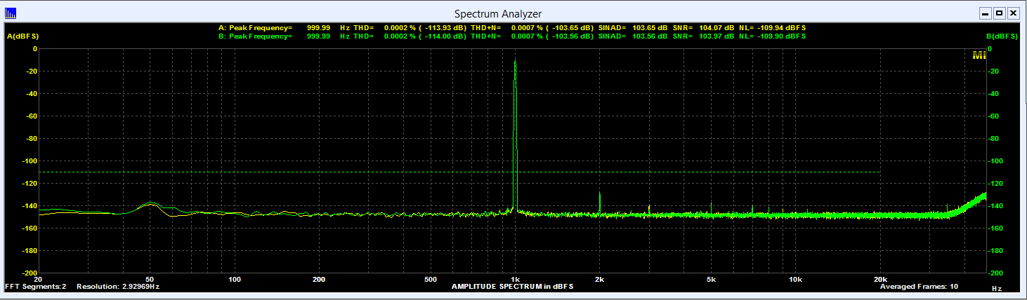

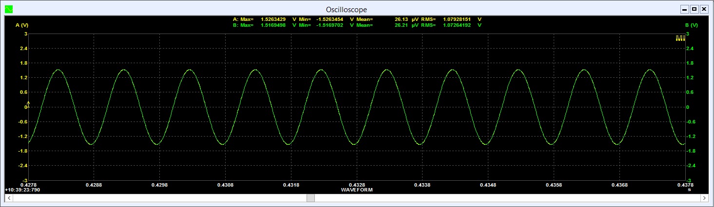

Lets walk through it. Your DUT outputs 1V at the fundamental frequency, right? Then what happens, do you send that through a notch filter? How much does the notch attenuate the fundamental, how much does it attenuate the harmonics? What is its noise level?
Do you know how much the notch itself distorts, is it passive or active?
Then next, what happens, does the output of the notch go to the sound card, or do you use a preamp to boost the level?

I am astonished by these differences. I assume this is with the same hardware in each case. Are the FFT settings different?
Without changing anything in the hardware setup, only switching to a different analyzer software, do you get these differences?
Jan
@Jan
I am able to make all measurements simultaneously.
There are some differences in the window function used.
Audiotester: Blackman 65536 points
WaveSpectra: Blackman-Harris7 65536 points
Virtins: Kaiser6 (32768 points - I can't go higher with my version)
Changing the window function to Blackman-Harris in Audiotester gives the same results.
I tried Arta as well: (THD: 0.00021% +N = 0.0023%)
2nd harm: -123.05dB = 0.00007%
3rd harm: -136.58dB = 0.000014
That's identical to WaveSpectra:
Wavespectra:
ARTA Setup: FFT points: 65536 / Window: Kaiser 7 / Linear averaging (40)
I see the same numbers using a BlackmanH4 window.
