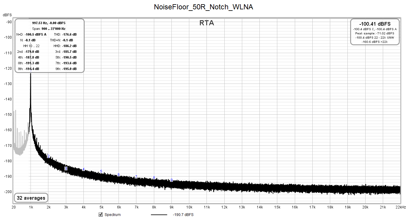

This has to do with the calibration in REW in order to take into acount the notch filter frequency response.
The data for the spectrum in my previous post were acquired at 48kHz and the FFT length was 524'000 (2^19). The signal level was 1Vrms.

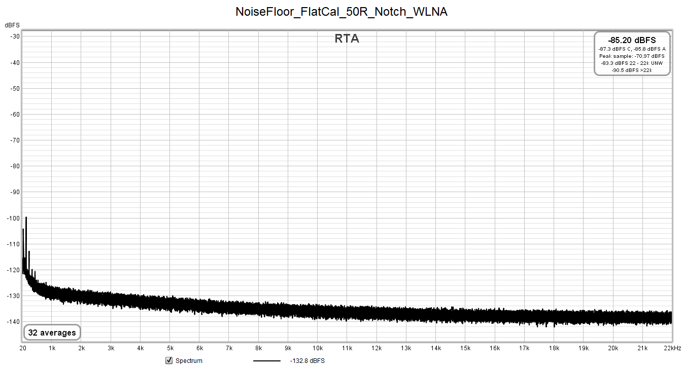

I dont have the time at the moment to delve into the mathematics; instead, I'm enclosing two noise floor measurements of the same setup.
The first spectrum was obtained with what I call "flat calibration" - the ADC was previously loopback-calibrated, the level was checked with my HP34401A. The notch filter input was terminated with a shielded 50 ohm resistor, and its output amplified by a 60dB LNA (input-referred noise of about 1nV/rtHz).
The second plot shows the noise floor when the notch filter calibration curve was taken into account. This calibration makes it possible to directly read amplitudes of the harmonics off the plot.
Returning to the first noise floor plot, imagine a 2nd harmonic at a true value of -150dbFS: it would appear in the "flat calibrated" plot at a level of -100dBFS (+60dB in LNA, -10dB in the notch filter). By "lowering" the noise floor appropriately, this harmonic appears at -150dBFS in the plot.

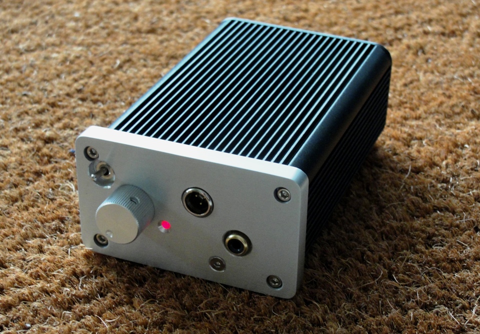

Ok. Outside of DIY.
IMO even a single piece of a similar case is within DIY. Fusion360 sheet metal design is free for DIY, the design would include all holes. Shops with metal laser-cutting machines are quite common in most areas, or online services. IME laser cutting is surprisingly inexpensive. The better ones remove the burrs, or they can be done at home easily.
Bending may be a bit more complicated as precise repeated bends require some machine setup. Nevertheless for simple bends any local metal shop will do or you can bend it at home. Powder painting is omnipresent and typically inexpensive even for single quantities. At least that is my local experience in Central Europe.

If I understand correctly your first plot shows the "self-noise" of the notch filter amplified by the 60dB LNA. Then your second plot is an artificial noise floor that is created by applying a noise filter calibration curve on the first plot and subtracting the 60dB LNA. It this is your procedure it does not lead to correct results.

Your procedure may show an artificial noisefloor of you notch filter but it is of little use. If you want to measure the noise of your notch filter you should use the noise density (V/rtHz). That is also available in REW.
Your artificial noise floor cannot be applied to THD measurements (e.g. Victor's oscillator). The noise sources in your measurement setup (LDO, notch, LNA, ADC) are not related so you cannot just subtract the notch noise from the result. Also you are ignoring the THD of your LNA and notch.

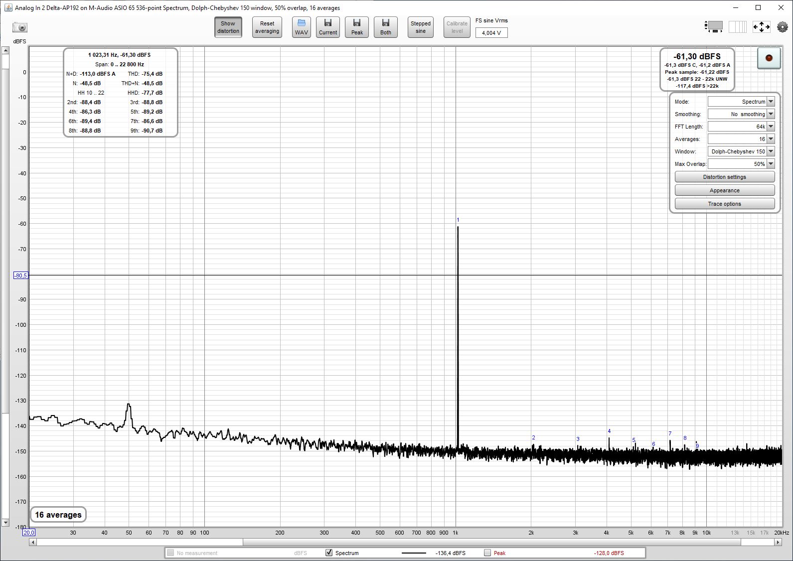

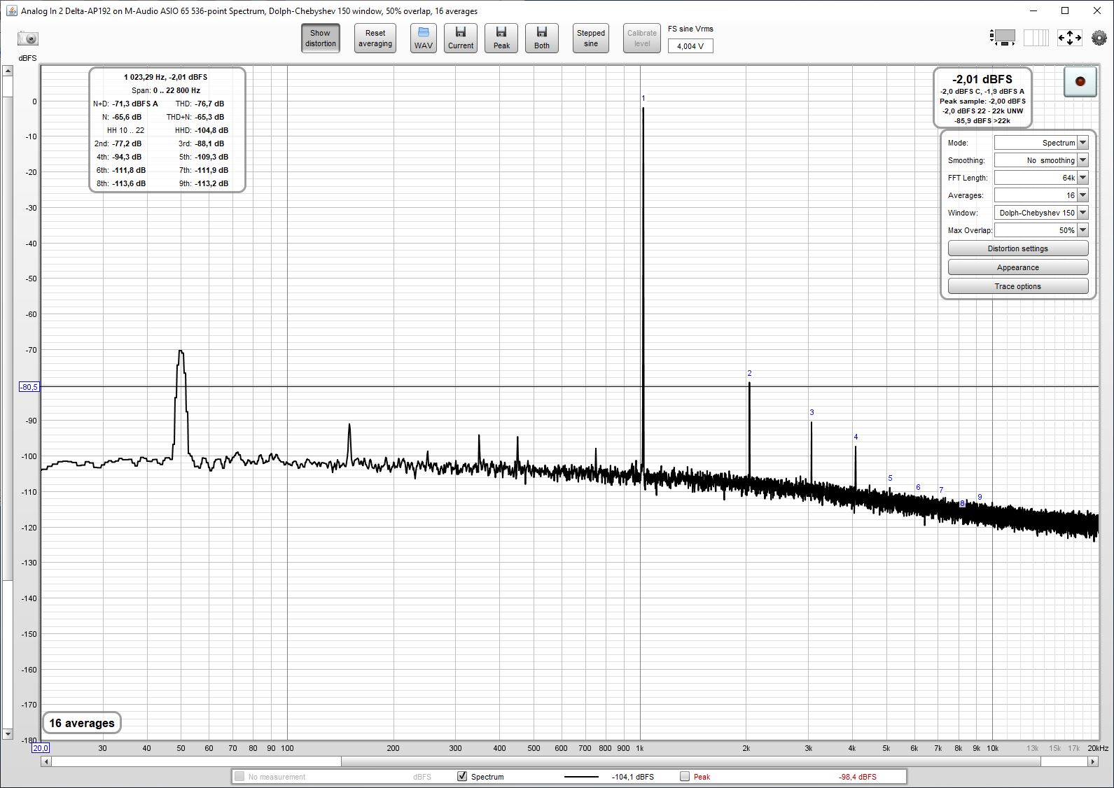

Here is a pair of plots without any gimmicks.
First is Victor 1kHz LDO with notch (about 65dB).
Second is the first one followed by a 60dB LNA.
As can be seen in the second plot the THD is much higher than just THD in first added by 60dB. This is due to LNA (and ADC) distortion. Also the noisefloor in the second plot is lower than first added by 60dB which indicates that the noisefloor in the first plot is limited by the ADC.
