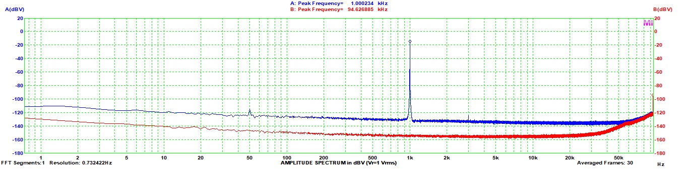

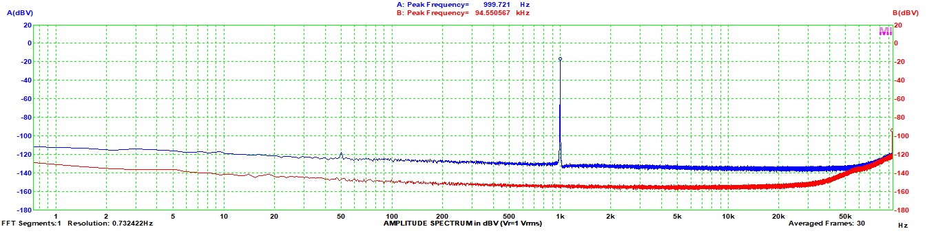

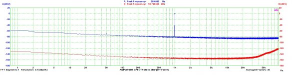

I have been using Victor's generator for several months and finally decided to measure it. It's output is configured in balanced mode. Negative output is taken from pin 7 of OPA1656. The setup is - Vic -> 40db -> 20db amplifier. At 1V RMS and 1.5V RMS generator output level no harmonics are visible. 🙂 At 2V RMS a tiny third harmonic is observed at around -125db. 5db added and 20 removed and the real 3rd harmonic level should be around -140db.

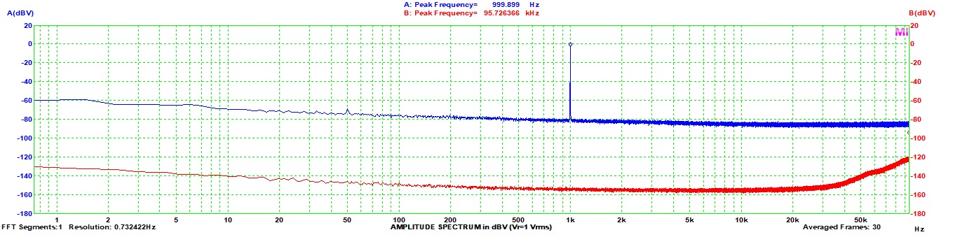

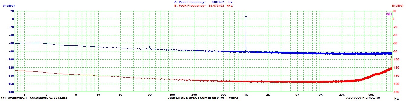

And another round of measurements. Now with 70db notch and 20db + 50db amplification. 50db with OPA1612.
AT 1V RMS I am amplifying only the noise of the notch. The Vic generator cannot be measured with my setup. At 2V RMS the tiny 3rd harmonic is seen as in the first measurements but amplified 50db more. It is below -75db. So - 5db for the notch and 70db lower. It is below -140db.
And this is at 2V RMS. At 1V - nothing ! Just noise 😎

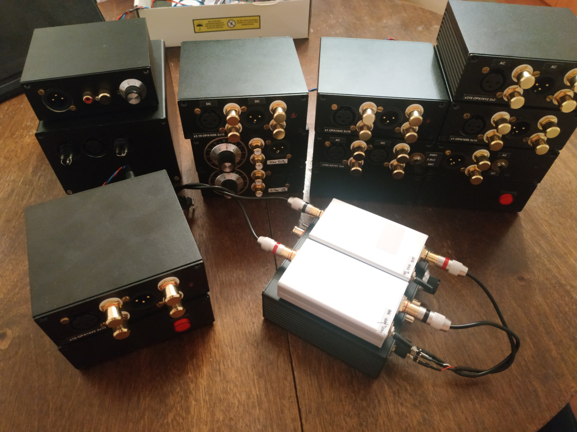

Glad, that you liked it ! As Victor mentioned shielding is important. 🙂
Every amp, generator or power supply is put in an aluminum box.

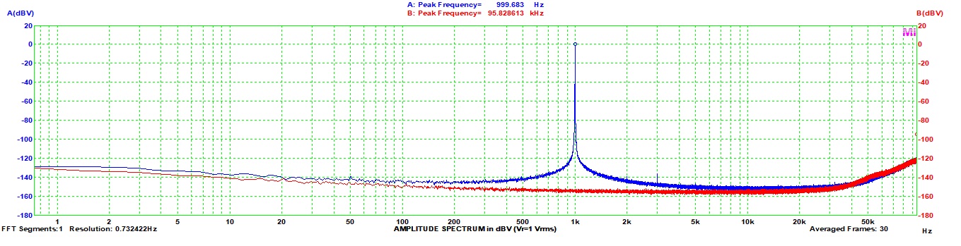

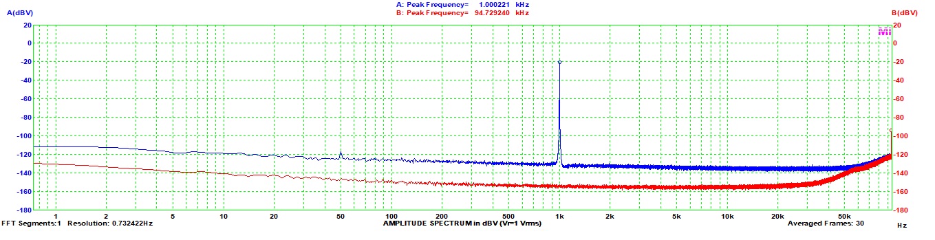

This is a direct measurement. Red - the noise floor of the setup. The blue spectrum - 1V RMS Victor generator. These are the limits of the system. The third harmonic is from the setup. Victor's generator is not to blame.

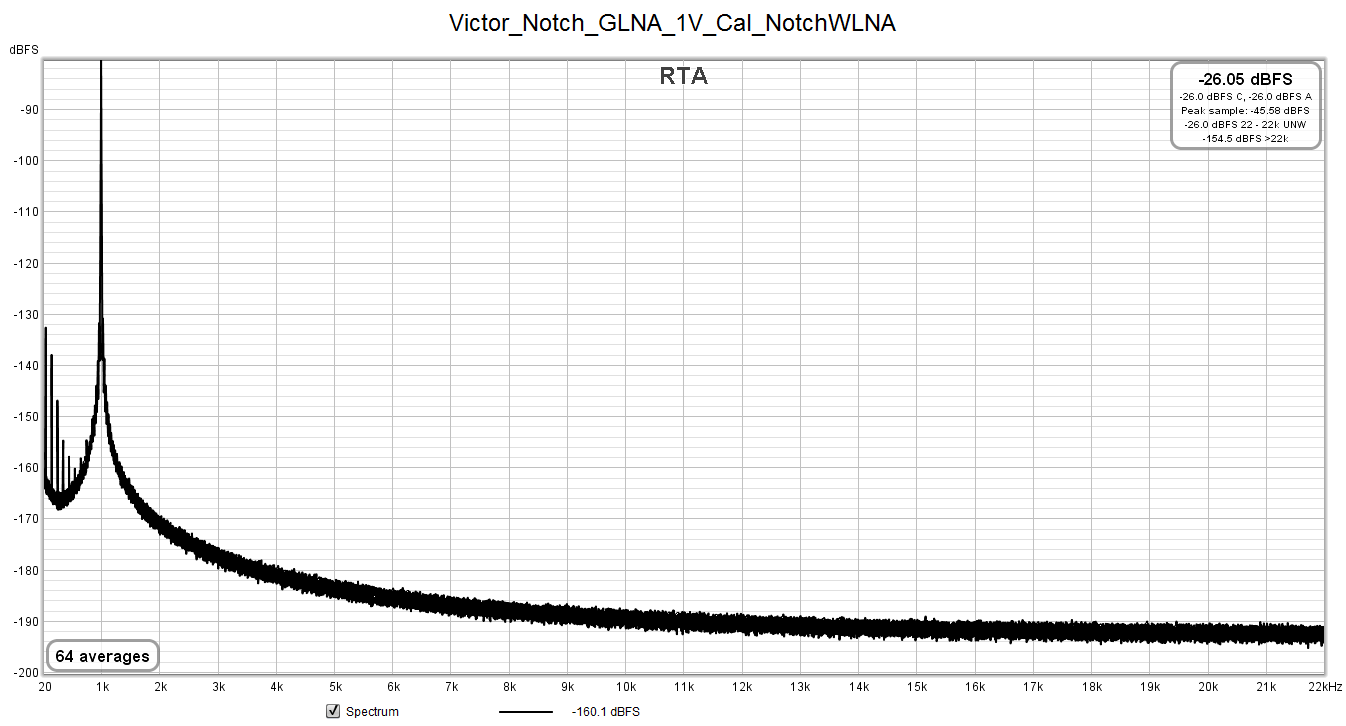

Congratulations on the equipment and measurement results!

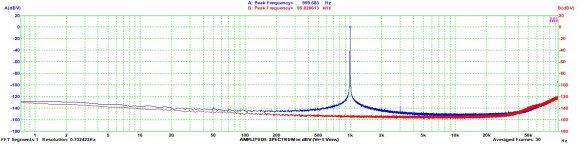

Victor's oscillator is indeed of reference quality - mine is five years old, and this is what I recently measured.
The setup was Groner's notch filter (-100dB) and Groners's LNA from Linear Audio Vol. 3.
The spectrum was taken at 1Vout: nothing to measure
