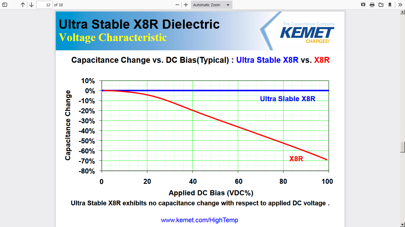

I think BSST meant this
The Voltage coefficient of the improved ceramic dielectric is interesting and important but that's still not a good material for a critical timing part.
Polystyrene would not need that level of temp control. And there are other options: Polystyrene Capacitors - What Happened to Polystyrene Film Capacitors?.
The resistors would also be an issue. Before crystal locked stuff designers were pretty skilled at mixing resistor and cap tempcos to cancel each other. I have one precision source with a thermistor in it to correct for frequency drift. It seems to hold OK to .1%.
