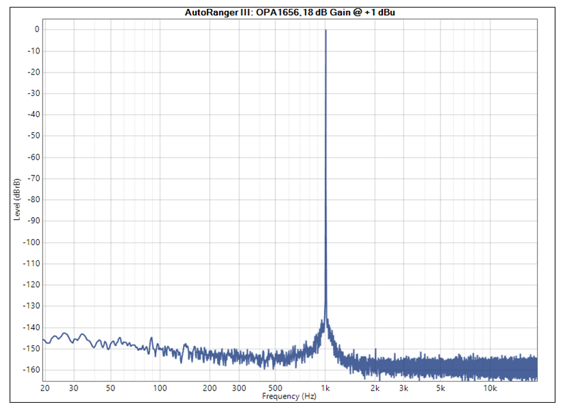

I yes I see what you mean. But Vics osc has internal shunt regs fed by series Rs. So there you lose 5V right away.
I have deleted that stuff in my oscillators and feed them directly with a SuperSwitcher on a powerbank. Absolutely no mains spurs and no wideband noise.
A 10,000mA powerbank feeds it for almost a day.
Jan
So SilentSwitcher can be configured for different needs, I have a circuit board for Victor's generator that I bought a couple of years ago it has been left unused because I did not want to use a bunch of PP9 as div source, you say that SilentSwitcher configured as SuperSwitcher has high enough voltage for Vicktor's generator, then I want to buy a Switcher if it comes with a description for the modification to higher voltage.
There is no SuperSwitcher. Confusion: there is a silentswitcher and a fully linear superregulator.
The silentswitcher can run a Vic oscillator as is +/-15V, but you must remove the two series and two shunt regs on the osc boards.
As example of the SS performance, here it is powering a balanced 18dB gain stage in my autoranger. You see any mains or HF noise? ;-)
Jan
The idea is to connect +-15V SilentSwitcher directly to +-15V on Victor's board bypassing the TL431 regulators. So no need for 35V supply. You should probably remove the TL431s and the related resistors if you do something like this.
Jan beat me, sorry for double posting. Needless to say you could of course use any linear low noise +-15V power supply as well.
