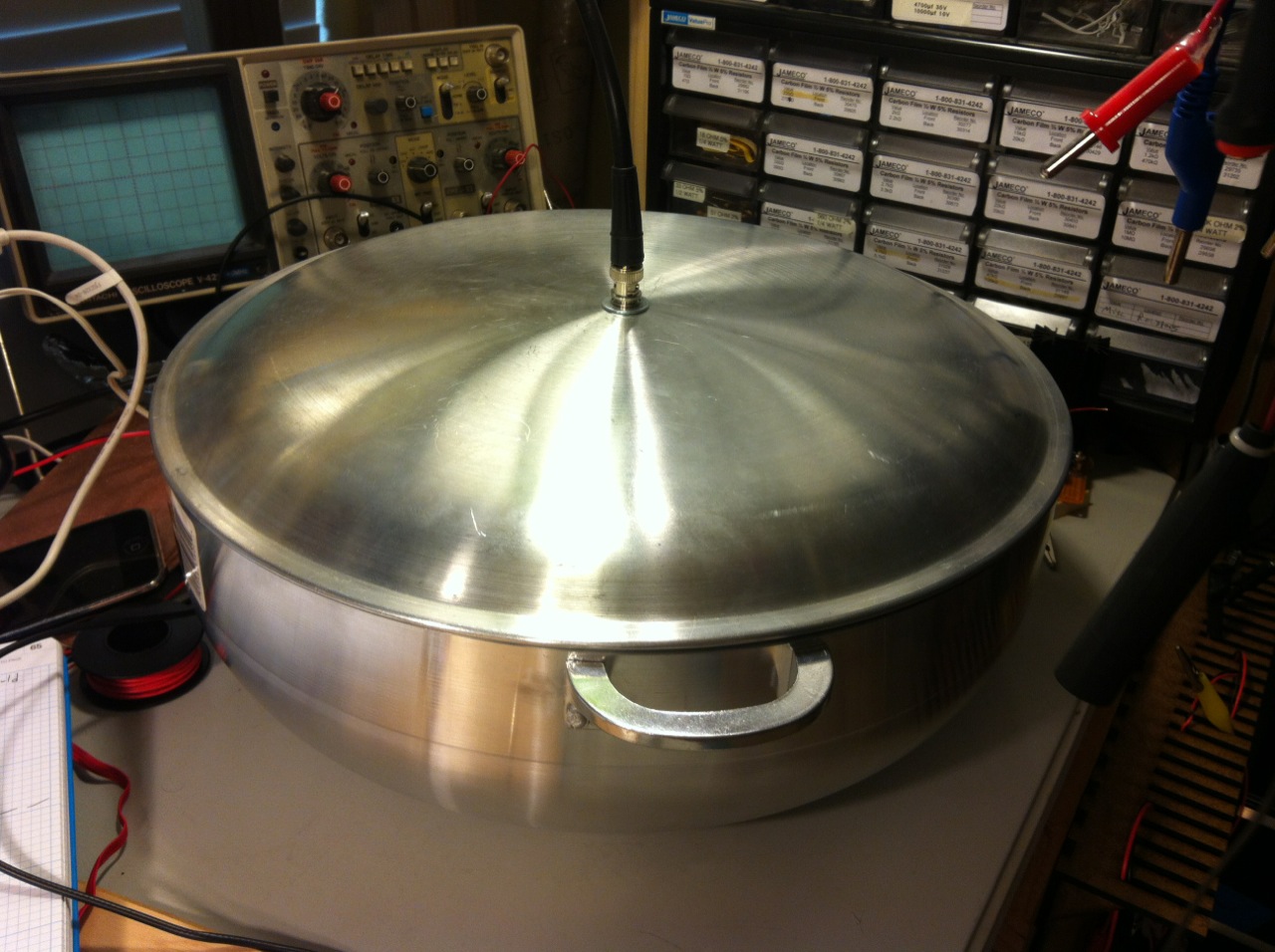

Another nice thing about battery-powered circuits is that you can throw them into a faraday cage for low-noise measurements

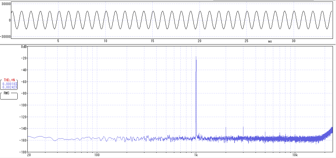

I'm using an Asus Xonar Essence STX card as an ADC (I also have an Altor Olivine2).
With the following path- WaveGene ---> USB/SPDIF ---> DAC ---> buffer box --> Asus - I am seeing about 0.00018% THD.
Would I really benefit from building a low THD oscillator?
Are my THD figures just being reported incorrectly by WaveSpectra perhaps?

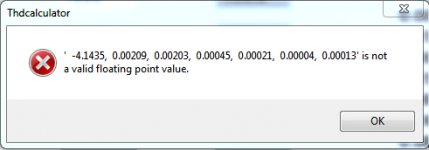

I would like to bring my THD calculator to your attention right away.
How should this be used?
I have run a plot in Arta Steps - exported it to CSV and then imported it in your THD Calculator.
I get some errors on import but the program then goes on to calculate a seemingly improbably low THD figure of 0.000006% ?
I suspect I am doing something wrong...
I haven't invested a lot of time in error handling of the ARTA import. If you take the export from the latest ARTA version and don't change it, then it should work. I don't use Steps.

Don't forget that when measuring distortion with ARTA using an external oscillator source, you need to set the 'Generator' frequency setting in ARTA to be exactly that of the external oscillator for the ARTA measurements to be accurate.
A few Hz off will give erroneous readings.
Cheers
Mike
Cheers
Mike
Only if you care about the computed THD percentage. If you're doing A/B testing to see if you made an improvement, you can just use the amplitude of the harmonics. I usually set the reference level of the FFT display to put the fundamental peak at 0 dB. That makes it pretty straight-forward to read the THD level in dB.

Can't you set ARTA to threat the highest signal as the fundamental? Most such programs can do that.
Jan
Tom
Yes OK, OK I forgot to state 'measuring distortion percentage' which is what most people would be looking for.
Measuring individual harmonics' levels and then calculating them long hand is a PITA beyond the third harmonic and gets worse if you use a passive notch filter and take account of its attenuation effects on the 2nd and 3rd harmonics. I was trying to point out to previous posters that there is a little 'gotcha' there in my experience.
Hi Jan
my understanding is that ARTA does not present the fundamental's frequency value unless you align the cursor exactly on the peak. It does, however, display the RMS value of the input signal.
For distortion percentage measurements, it assumes that the soundcard in use generates the test signal. I would be interested if Ivo could confirm that or not.
