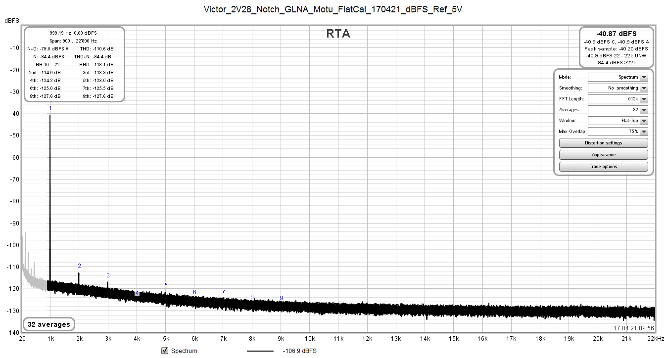

In the distortion window the fundamental is at 0.00dBFS and also all the HD levels refer to that instead of the real fundamental level. Why is that?
In the 3rd graph if referred to the real fundamental (-16.25dBFS) and without notch correction the 2nd HD is at -109.2+16.25-60=152,95dBFS and the 3rd is at -118.8+16.25-60=162,54dBFS. Assuming the notch correction at 2nd and 3rd makes these about 5dB higher these seem quite reasonable. However the 3rd HD seems a bit low so some HD cancellation may have taken place.
The intent was to have all results refer to the same base value.
Since we are dealing with HD, IMHO the choice reduces to two such values: FS of the ADC, or the signal value at the measurement setup input. For compatibility with my previous postings, I've chosen the former, thus the ordinate in terms of dBFS; otherwise the alternative reference would have been 2.20Vrms (oscillator output), and the units dBc.
So the true value of the fundamental can only be seen in the first plot - the fundamental of 2.20Vrms is displayed by RTA as -7.01dBFS.
However, in all other plots the fundamental displayed by RTA can not be used as reference because it represents the signal value at the notch output multiplied by the LNA gain where appropriate. This value depends on the notch attenuation at the time of measurement, which I tried to keep at -70dB, but there is no guarantee for that, as it also happened in this very plot. So your assuming a fundamental of -16.25dBFS does not yield a correct result: for the 2nd harmonic, it is -109.2 - 60 = -169.2dBFS, and -159.2dBFS after the notch attenuation correction of +10dB, and -152.2dBc ref. 2.20V. Likewise, the 3rd has a value of -178.8dBFS before the notch correction.

No. The fundamental measured by the ADC after notch and LNA is at -16.25dBFS and this should also be the basis for the HD levels. So your calculation is incorrect. The real HD levels are 16.25dB higher.
Please compare with the above mentioned third plot.
I rest my case.

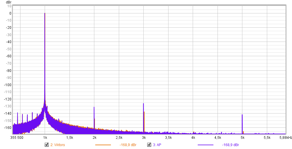

I just remeasured Viktors vs AP with a simple untrimmed Hall-type notch (~50dB max attenuation, and about -44dB at the actual test frequency). No LNA though. The ADC (RME ADI-2 Pro FSR) was hit with ~-45dBFS (after notch) so its contribution is low (but probably not zero). The distortion of the notch is unknown (I'm using WIMA polyprops and off-the-mill metal films).
Comparing this to the measurement with AP (shown in #9493), things are not extremely off -- within the bounds of unkown distortion cancelling, notch filter distortion and unknown ADC distortion contribution. Sanity check running the ADC 15dB lower did show zero difference, so probably negligible.

I made a mistake since I forgot that the notch is deeper than the LNA. Yes, the correct reference is the original fundamental (-7dBFS). However in the 3rd graph the HD levels in the distortion window are calculated from the 0dBFS instead so these are 7dB too low.
Based on this the 2nd HD in third graph is at -109+7-60+10=152dBFS and 3rd HD at -119+7-60+4=168dBFS. The 2nd HD makes sense but the 3rd HD is too low compared to other measurements seen on this thread.

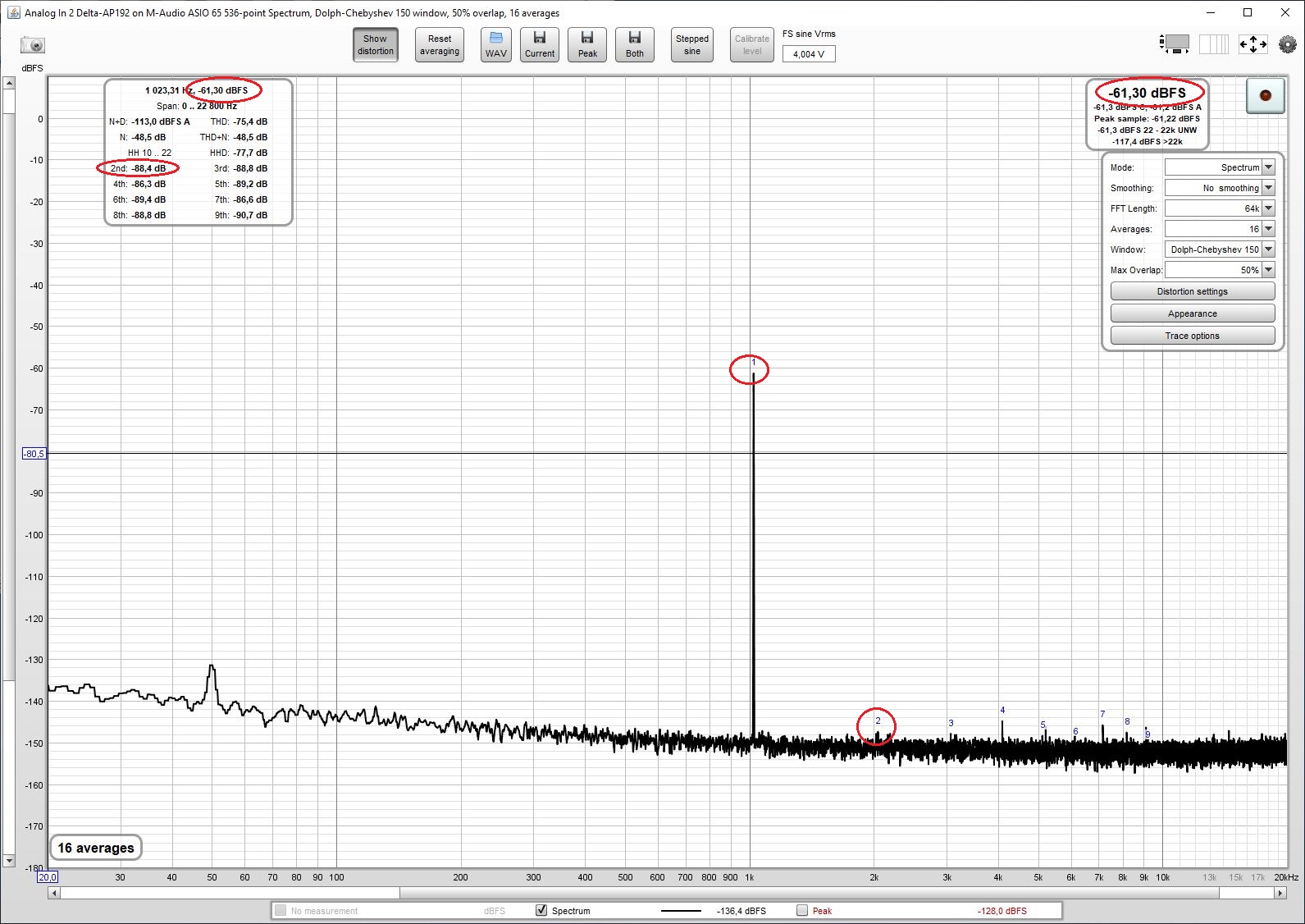

To clarify below are 2 REW RTA plots. In the first REW has found the fundamental and all HD levels are calculated against that, not against FS. The second plot is Braca's 3rd plot where the fundamental has been manually entered to 0.00dBFS. REW uses this as the reference and all HD levels are calculated against that, not the actual fundamental. And as the actual LDO output is at -7dBFS, the shown HD levels are 7dB too low.

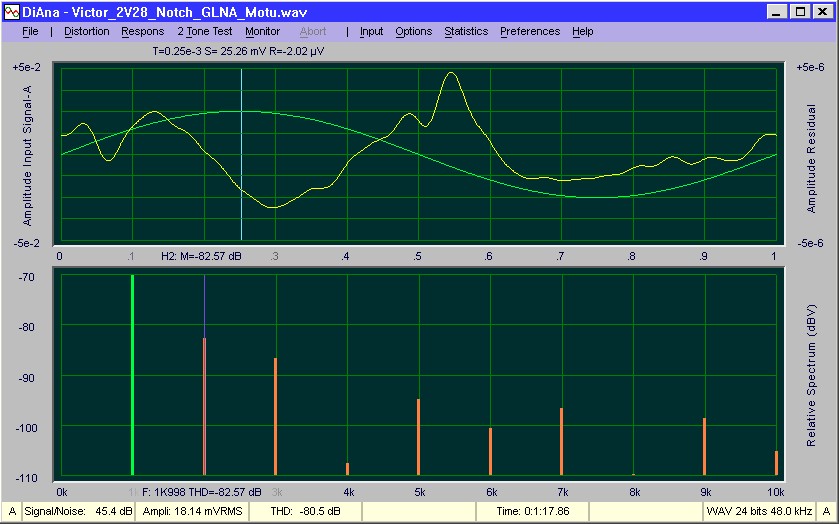

As already told, I got 17.8mV RMS (or -31.98dBFS). With the best will in the world (by fiddling with a factor 5 and/or even sqrt(2) ), I can't rescale it to 0.305mVrms.
Normally, wav files are normalized to a peak value of +/-1.0. That is why Klaus (KSTR) also found this value (-31.95dBFS), see post #9476, while audio_tony found 35,1dBFS, see post #9478. Apparently the latter figure is based on a normalization to an RMS value of 1.0 instead of 1.0 peak. When normalized to +/5.0 peak, I should get 93.5mV or when normalized to 5.0 RMS, I should get 132mV. All these figures don't even come close to the results obtained by the current version of REW (i.e. 305mVRMS).
So what's going on here?
1. DiAna is wrong , or
2. REW is wrong, or
3. Something wrong with your wav file, or
4. I've overlooked something else.
Comments invited.
Cheers, E.

Thank you so much for clarification. Now I can proceed with your wav file. But what I am supposed to do with this file? Comparing harmonic levels, fundamental frequency variance, dependencies on FFT length, noise levels?
"In terms of the notch attenuation, it yields -85dB."
In that case I get for H2: -82.57 - 85 = -167.57dB (FFT length = 512k)
This figure stays well in accordance with your results in post 9473, right?
