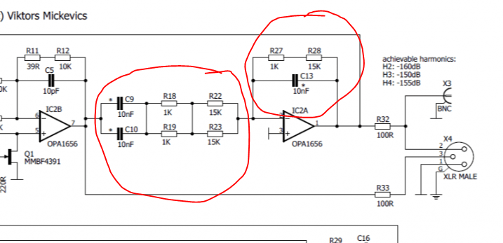

The OpAmp with the AGC runs gain -1. The filter also has a gain of -1 at the center frequency, the 2C//0.5R + C+R affords that.
See my post here.
I was referring to the output drive. See the circled areas. Usually you want a gain of -1 for the balanced drive. And why 15K + 1K? In my experiece using a lower resistance lowers the noise and these opamps have no problem driving as low as 600 Ohms.

This is not just output drive, please note the feedback. It's the bandpass core of the oscillator and it has a gain of -1 at the oscillation frequency.
15k + 1k is just to get along with E12 values. And that impedance level was choosen to have small capacitor values, 10nF in this case, to get 1kHz. Also, Viktors (the original designer) likely wanted to have no excessive load current to avoid distortion.
For more answers about design decisions maybe better ask Viktors (@vicnic) directly.

Some time ago I modified Vic's oscillator to use a degenerated VCA and provide a balanced output. I also added a dual channel (or balanced) notch filter to expand A/D measurement range. I later added an attenuator. I call them ULDO-Nacho and Atto. I've found it to be a very worthwhile addition to my bench.
The design uses a "composite" op amp and a common 5532 which outperforms both the OPA1612 and EMI-prone LME49720.
THD runs about -140 dBc depending on level and load.

Page 8 of the OPA1656 data sheet is where you need to look.
TI doesn't publish open loop gain vs frequency for the 5532 and NJM only lists gain at 10 kHz but they typically run about 90 dB at 1 kHz. Some of the older datasheets (Fairchild) provide gain vs. frequency and its 90 dB. The LME49720 isn't much better.
If you follow the build thread posted earlier there's a theory of operation and also links to a development thread where I looked at other designs from Cordell, Bateman, Williams et al. There are two VCA-based examples.
I estimate, based on crude measurement, the gain with the BJT front-end results in a composite 1 kHz open loop gain in the 135-140 dB range.
