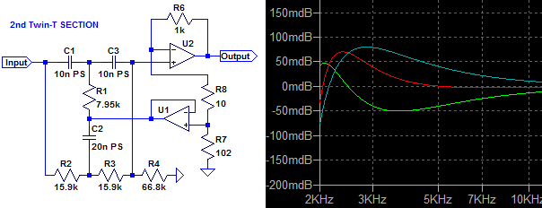

Yes I like the given Notch performance as
Frequency characteristics: green = first stage, light blue = 2nd stage, red = general)Frequency characteristics: green = first stage, light blue = 2nd stage, red = general)
See performance picture for H2....H10 😎
The frequency response is quite amazing. Aren't new harmonics introduced by the feedback op amp (active circuit)?

A further problem is the notch depth. It is just ~-25dB if the osc is 1% off. You need a temp oven ...

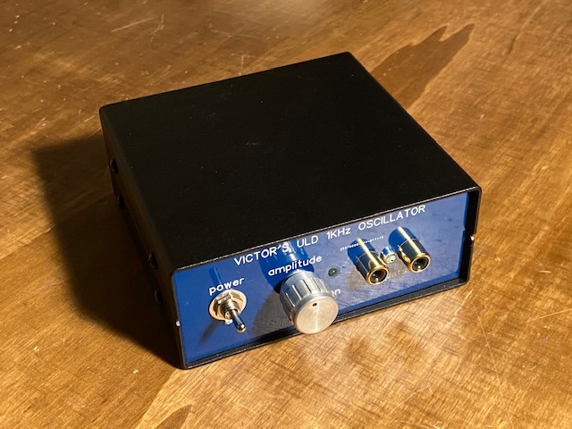

Hi everyone,
I've been reading this thread off and on for possibly years, but everytime looking back at almost 10k posts over 487 pages is really daunting. Searching amounted to nothing really, so please forgive me if i post this and it has been answered before.

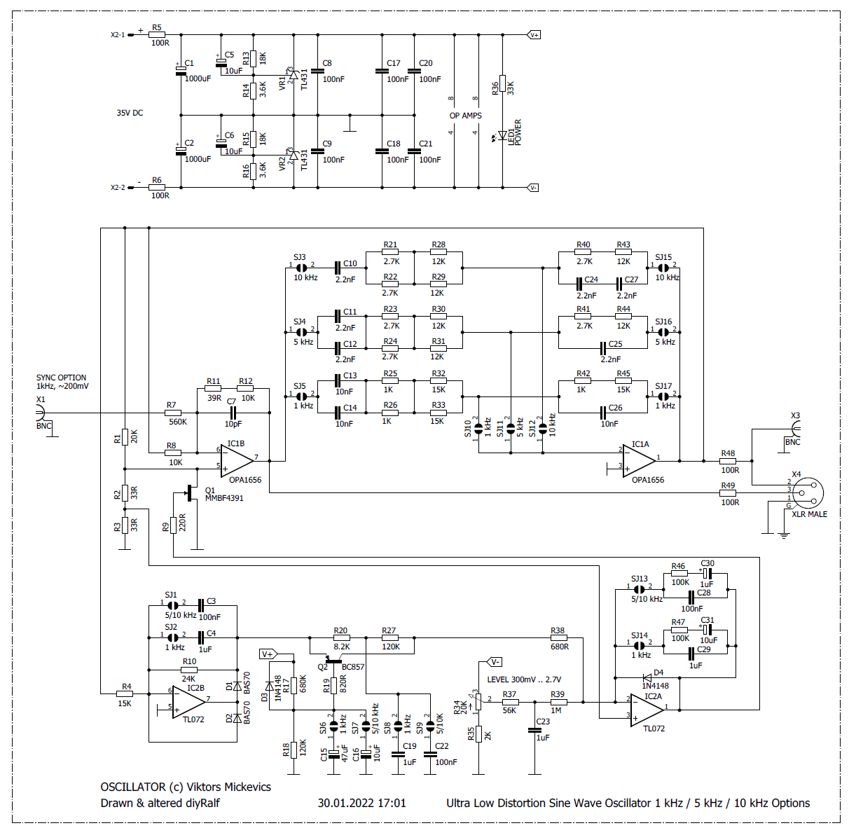

So I recaived some time ago one of Victor's oscillators a 1khz sample. I looked around for a suitable power supply, and have, in fact found an interesting design made by Toli (https://tolisdiy.com/2019/03/11/low-thd-oscillator-power-supply-and-pcbs-as-case-panels/).

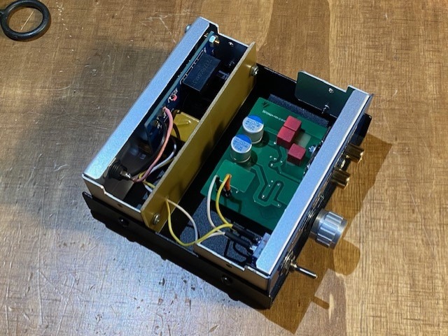

So I twaeked a bit the Gerber of the PS board - to make it fit the box i had, the circuit is left untouched - and built it.
Now, the problem i see in testing the PS is that without load it measures quite high, 51V, and since Toli told me that it's "tailor made for a specific load"...
the question is, how to simulate Victor's oscillator's load? So I can test the PS before I connect it to my precious device.
Here are some pics.
You can test the PSU by strapping a 1K resistor between the Vcc and Vee terminals to simulate the current through the oscillator.
Total resistance between the PDM output terminals would then be 1000 + 6 * 82 = 1492 Ohm, giving the current through the resistor chain of 50/1492 = 33.5 mA.
Then the voltage across the 1K resistor will be 33.5 V, less than 35 V that the oscillator needs but good enough as a PSU test.
I've been running my oscillator for the last eight years from a wallwart PSU that imposes a current of 37 mA through the Victor's regulator.

hello Braca,
I am extremely pleased to say that the voltage drop is 22.732V with a 2w 1K resistor and that once that was tested, I measured 33.501V with Vic's oscillator as a load. Toli's design is very nice and I can't wait to be able to measure it vs a basic linear PS I made with TO92 317/337 (waiting for a QA403)!
For now, I'm very happy!

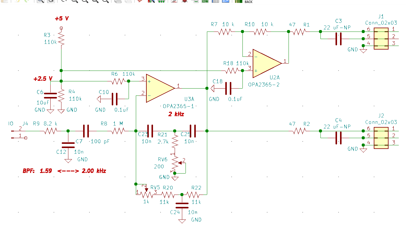

why do you guys don't like the idea to filter DAC by LPF and get -150-160db stable and low noise? Almost any DAC is ok for that because you can use REW to compensate its harmonics, 2nd order LPF will improve 3kHz for -15db and wipe out all higher ones. No frequency adjustment is required, the level sweep is available, 1kHz THD+N <-130db i.e. APx555b is worse for 6db.
TI has product: https://www.ti.com/tool/PSIEVM
https://www.ti.com/lit/ug/sbau289/sbau289.pdf
I used same concept for testing mcp3561R & max11270 ADC.
https://www.diyaudio.com/community/...ty-from-microchip-mcp3562.374181/#post6709284
I don't like TI's idea to solder many OPA in line, so I choose another topology - tween-T high Q (1000-2000) filter. Only one dual OPA is required to get fully differential pure sine wave. Tunning is slightly complicated, to get such Q, but filter is easily scaled to any frequency up to 200 kHz.
stm32F7/H7 series can drive both, ADC and internal DAC to generate sine wave. 12-bits is sufficient to get -70dBc THD level, frequency up to MHz area, simple magnitude control using DDS - eradicate any problems usually associated with magnitude stabilisation in common oscillator.

? I keep options for DAC open, having flexibility to use my Rigol x1000 SG (HD-2 ~72dBc) or as I say stm32f7 internal DAC (about the same ~70dBc), this demands about 60 dB attenuation for HD-2. 10-th order LPF is not something I'd enjoy to build, though tween-T save me of troubles.
Haven't try ES9038 - not hobby friendly package. I get last month ES9023 & PCM1798 to play with. Observed results from es9023 as expected, not really exciting. PCM 1798 much better, HD-3 close to -130 at 1 kHz, same time HD-2 hardly get to -120 , and I think ne5534 is an obstacle. Anyway, nether of them would be able to operate at 100 kHz with acceptable -100 dB, so I will continue to improvise with tween-T. Thinking to build a bunch of them, 8-16 and simply switch a spot frequency by relay, from 100 Hz to 1 MHz
