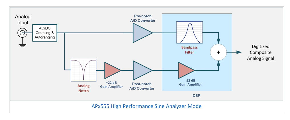

Maybe in the next revision it will make sense to replace the AK4490 with ES9038 to reduce the THD on the analogue output, but even a tunable LPF is not suitable for non-sinusoidal signals. The same problem with the ADC notch - only for THD with a sinusoidal signal. Not even IMD is possible.
By the way, when I played with notch+ mdac (not successful due to THD and SNR), I used a slightly different technique than AP:
AP uses the second channel for the direct signal, then digitally filters it and mixes it with the second (notched) signal in the microcontroller.
I used only one channel of a "good ADC" for notch+amplifier and a simple 12-bit microcontroller ADC for the direct signal - only to determine its amplitude and frequency. Then I generate a pure 32bit sine wave (DDS) with this amplitude and frequency and add it to the notch channel.
I can not say that it is better in terms of signal, but it requires significantly less resources of the Microcontroller.

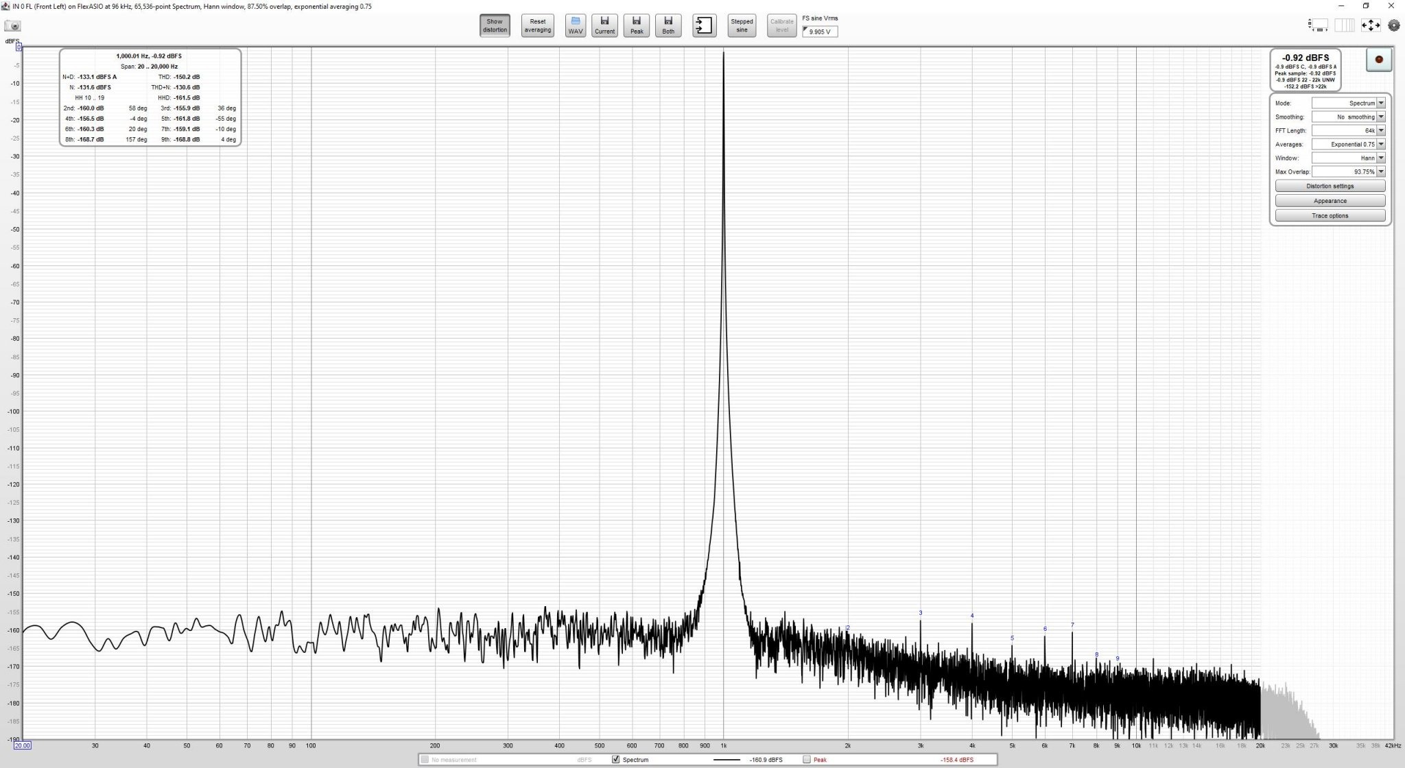

HI,IVX, Can the LPF schematic diagram be shared?why do you guys don't like the idea to filter DAC by LPF and get -150-160db stable and low noise? Almost any DAC is ok for that because you can use REW to compensate its harmonics, 2nd order LPF will improve 3kHz for -15db and wipe out all higher ones. No frequency adjustment is required, the level sweep is available, 1kHz THD+N <-130db i.e. APx555b is worse for 6db.
