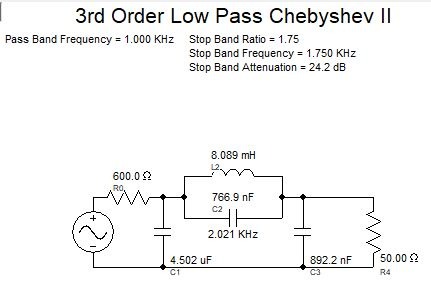

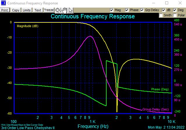

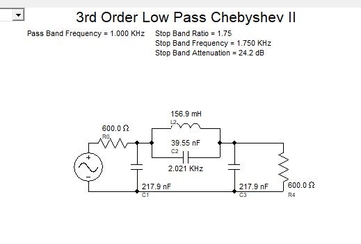

I realized I have been looking at the filter as high pass so its a different case and far more sensitive to impedance imbalance. And no beneficial filtering. I'm attaching a passive solution that should be realizable. The inductor should be large but could be powdered iron cup cores based on the CLT-1 realization. Just make it pretty large.
I do recommend Nuhertz Filter Free for this.

I attached a pretty realistic 600 Ohm in (works with opamps) 50 Ohm out for low noise passive filter. The values are not crazy and may require a little tuning to get the null on HD2 if that is important. Suitable inductors are not that expensive ($3-$12) so its not crazy. It is another way to get there and the best instruments made (CLT1 & CLT10) use this technique to get the performance, -170 dB HD3.
For my purposes Viktor's oscillators are excellent and just work. You are starting with a typical -150 dB harmonics which is more that good enough for most any application.. You can always apply John Curl's simple enhancement- add a cap across the output to knock the harmonics down further. Just use a very good cap, film or COG, so its not limiting your efforts.

Inductors with any ferromagnetic core generate up to 1% THD, so stop dreaming. Air-core only, but size and weight -😵
