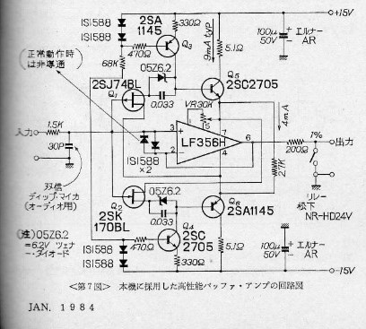

Bootstrapping opamp's supply pin can mitigate common mode distortion, although bootstrapping from output may cause instability.
Bootstrapping from the input doesn't have a loop stability issue, and it has another benefit. Bootstrapping supply pin can also bypass the signal to the compensation capacitor, so the input stage is required little current to charge the cap which reduces the distortion of the input stage.
What is the source of that bootstrapped op amp schematic?
Looks similar to Funasaka: https://www.proaudiodesignforum.com...S_v30n5_Feedforward_Floating_Power_Supply.pdf

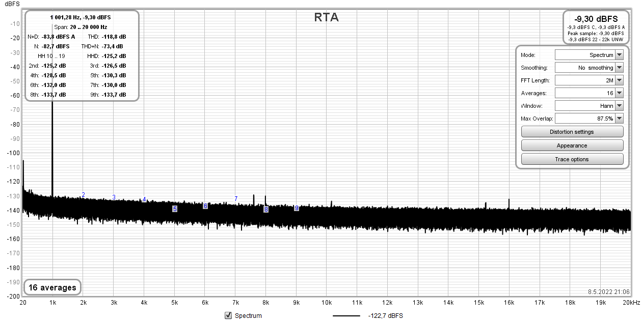

Here are my results with Victor's 1kHz oscillator + Twin-T notch 1kHz + LNA (OPA1656 with SE to Balance conversion) + Focusrite Forte as ADC.
One pic is with notch compensation and second one without (Twin-T has -50 dB attenuation on 1kHz, -8 dB on 2kHz, -4 dB on 3kHz).
Therefore 2nd harm. is -125-50+8= -167 dB, 3rd harm. is -126-50+4= -172 dB (but they are hidden in noise...).
THD is around -167 dB (0,000 000 45%)!
Martin

Maybe I missed it but -161 dB relative to what?
What is the actual output level and load impedance?
0 dB is 2.7 Vrms output of the oscillator to the Twin-T notch - its load impedance is unknown to me (not measured yet, but I expect less than 10 kOhm - simulated is around 8 kOhm).
So -161 dB (or less) is THD of the Victor's oscillator measured by the instrumentation explained above.
My example is about possibilities of the DIY for the low THD measurement in "home environment" without expensive gear.
Martin
Something isn't adding up...
You show a notch output level, post-LNA on the first FFT at -10 dBFS. There is about 50 dB post-notch gain which would put the actual 1 kHz notch level, pre-LNA at about -60 dBFS. You also mention that the notch depth is about 50 dB. That would put the oscillator output level, and the input to the notch at -10 dBFS.
If the above is true then the reference carrier level, 0 dBc, has to be close -10 dBFS.
The level of H2 is about -168 dBFS but only -158 dBFS below the 0 dBc, (-10 dBFS) carrier.
Subtracting the stated 8 dB insertion loss at H2 yields about -150 dBc.

My 0 dBc is 2.7 Vrms 1 kHz from oscillator.
Notch is - 50 dB at 1 kHz.
LNA gain is around 30 dB (28.9 actually).
Forte input has gain 20 dB before ADC.
So we are back at about 2.7 Vrms which is around -10 dBFS of the ADC what you see on both pics. FS of the ADC is 7.75 Vrms (20 dBu).
All harmonics in REW charts are relative to the 2.7 Vrms (to our 0 dBc).
First pic is with SW compensation of the notch frequency response (imported cal file in REW). Here we see THD with all harmonics directly (with few dB of computation error).
Second one is not compensated, so we have to calculate real harmonics manually. H2 is 42 (50-8) dB down, H3 is 46 (50-4) dB down than we see on the pic relative to the dBc. Then H2 is -125-42=-167 dB, H3 is -126-46=-172 dB.
Hope, now it is more clear.
Martin
0 dBFS is +20 dBu only at the minimum -12 dB gain.
You're applying 20 dB input gain in the Forte.
It be seen from the table below that the converter internal 0 dBFS is the typical 2V RMS or +8 dBu. (Clue is with the gain at -12 the Forte has a +20 dBu OL point.)
Is that value +20 more than the -12 minimum or +20 dB above unity?
From the Forte manual:
I think your results are hugely off because you're making assumptions about what 0 dBFS actually is with the gain you're applying.
Meter the A/D input with an actual AC voltmeter and use that for calibration.
I typically use 1V RMS at the A/D input and set the input gain pot so that I get -6 dBFS. That's true unity gain from the input connector to the A/D modulator and its measured below saturation and not near full scale. Then use 2V RMS as your 0 dBFS calibration value.
