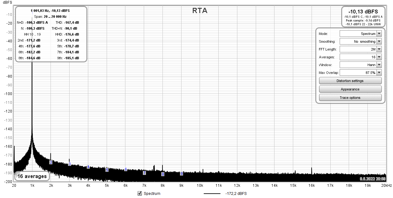

OK, so what I said originally is true.
0 dBFS in your measurement is 0 dBu with the 20 dB gain you applied.
"0 dBc" is -10 dBFS, H2 is down -158 below 0 dBc and with filter insertion loss at 2 kHz about -150 dBc. Not 160-170.
-150 dBc is 0.0000032%. H3 is relatively small but I suspect it increases under load.

Maybe the overlay is covering it up but it looks like the 1 kHz level is about -10 dBFS.
I realize the notch level is not the carrier level but the gain you've applied to the notch is roughly equal to the notch attenuation correct? If so we can infer the carrier level from the measured notch level.
The difference between -10 and -168 is -158.

Now I see - the spikes at 2 and 3 kHz are real but REW displays wrong numbers in the distortion table.Maybe the overlay is covering it up but it looks like the 1 kHz level is about -10 dBFS.
H2 seems to be -168+10 is -158 dB (from the scale) not -171.2 dB what REW sees. (OMG)
The same is for H3 -175+10 is -165 vs -174 from REW. (OMG again)
The markers of H2 and H3 from the chart are lower in the noise - they should be above the values/spikes. So it confirms the wrong level numbers.
But here you do not have to correct for notch response - it is included in the cal file applied in REW input.
So we are in the range of about -155 dB of THD (which is more real then my previous results).
It seems that REW is not always correct with low level harmonics frequency calculation from the fundamental and then with their levels. Here we are about 10 to 13 dB off.

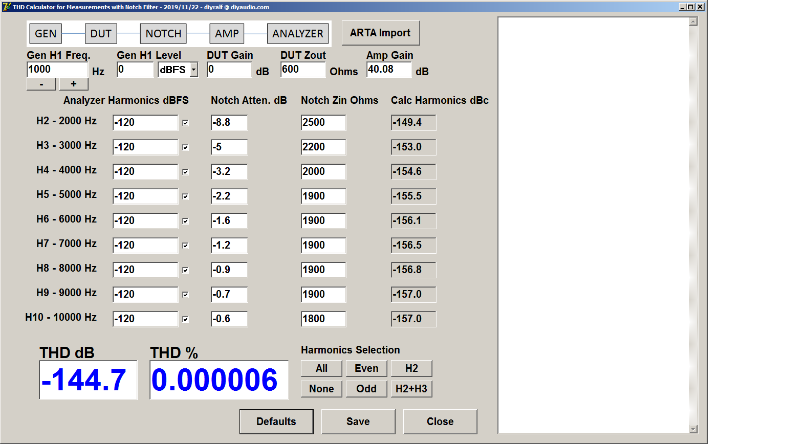

You got it and you're welcome. I should have mentioned I was taking my data directly from the graph and not the table which didn't make sense to me.
I would run the FFT again with the cal file off and make sure REW is handling it correctly.
The sign of the correction file data may be wrong which could explain the errors in the table display.
I don't use REW so I'm not sure how it works.
I have a spreadsheet I use to calculate the distortion based on raw FFT readings.
It has a column for notch filter insertion loss at H2-H10 and inputs for ref level and post-filter gain.
The power sum is calculated and displayed as THD %, THD in dBc and ppm.
https://proaudiodesignforum.com/calculators/ULDO_Nacho_THD_Calculator.xls
You might try it with the RAW FFT numbers.

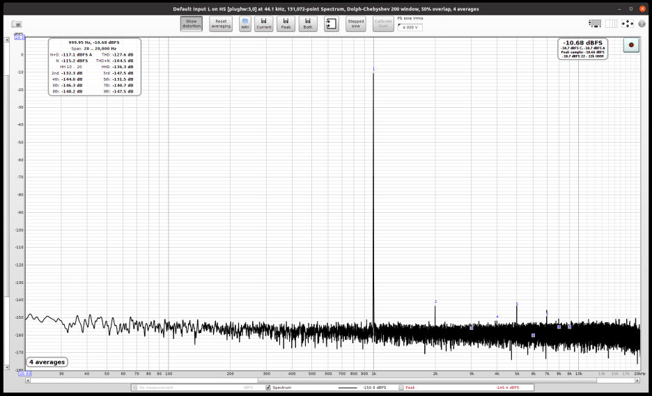

Do you use coherent (i.e. vector) averaging in REW for the low-THD measurements?It seems that REW is not always correct with low level harmonics frequency calculation from the fundamental and then with their levels.
I will run new FFT without cal file in REW and calculate the THD with the xls spreadsheet - it is more complicated but more precise, perhaps. Thank you for it.
I have tried coherent avg in REW but the results were THD about -175 dB so I ignored it as unrealistic. I can show the REW FFT later, if you want.

Hidden gotcha with the FFT's of an analog oscillator like the Victor's. The oscillator drift during the measurement could be enough to blur between "bins". I have been burned by this. However the -150 dB+ numbers are what I have seen with victor's oscillators. his current offering are better than my first gen which was in the -155 dB range. Cancellation is a real possibility but you can quickly see if its cancelling by paralleling a cap on the output to attenuate and phase shift the harmonics which will change the cancellation. If its not cancelling then the level should shift as predicted.
At and below -150 dB passive components start limiting your efforts Pots and some caps are the worst offenders but even some metal film resistors can show issues relating to internal construction as you get to -160 dB+
Yes, oscillator dift could be the problem. I could try to lock the frequency in the future, if I will need so.Hidden gotcha with the FFT's of an analog oscillator like the Victor's. The oscillator drift during the measurement could be enough to blur between "bins". I have been burned by this. However the -150 dB+ numbers are what I have seen with victor's oscillators. his current offering are better than my first gen which was in the -155 dB range. Cancellation is a real possibility but you can quickly see if its cancelling by paralleling a cap on the output to attenuate and phase shift the harmonics which will change the cancellation. If its not cancelling then the level should shift as predicted.

Here I can recommend my THD calculator.
oh nooo, AP's trustable result -140-145db(usually 2nd is worse due to MOSFETs in the MDACs) at 1kHz and depends on the level. A passive TT-notch with decent parts(fresh calibrated at the particular out/in impedance) is 15db better at least. Furthermore, OSC->notch and its buffer will have naturally formed 3rd harmonics about 0dg i.e. clipping-like, hence no self-compensation is possible there. Another thing is ADC which may have LUT to compensate 3rd harmonic with 180dg anti-harmonic.The problem with these longer "oscillator+notch+LNA+ADC" chains is that distortion cancellation is more likely to occur. Whether or not these results are more accurate than e.g. the AP measurements seen earlier in this thread is debatable.
Thank you for the THD calculator. Very nice.Here I can recommend my THD calculator.
