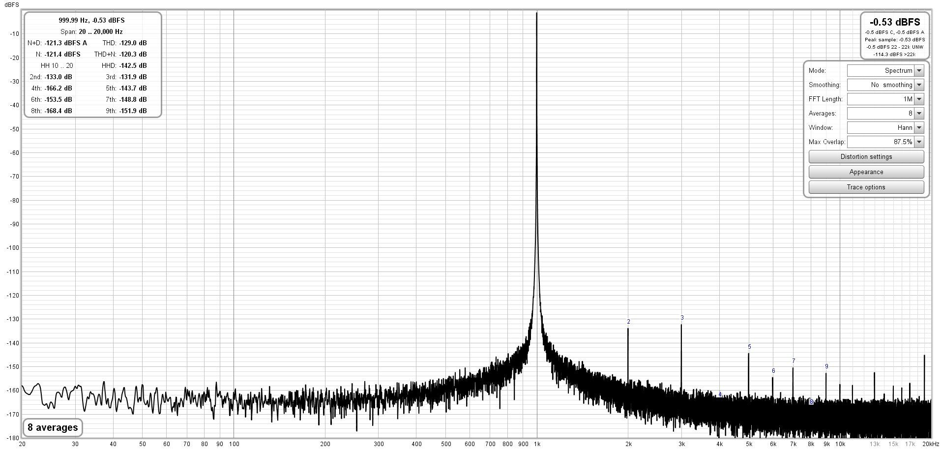

Strange, your results look not that good... With 64k FFT, I can not see any harmonic down to the noise floor at 140dB (janascard, not the Viktor osc).View attachment 1075717

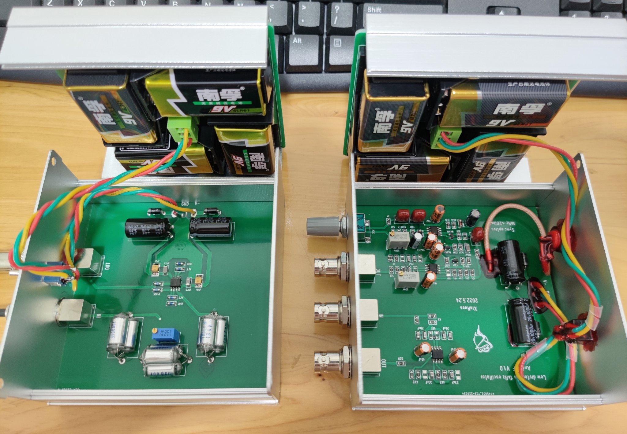

Because it is a DIY copy using Viktor's schematics.
But there is a lot more to layout and component selections that did not get the same attention / treatment.

I think it is not about it but Cosmos ADC input impedance may be slightly too heavy for the Victor's osc output at 2.7Vrms.Because it is a DIY copy using Viktor's schematics.

Yes, I just DIY based on the circuit diagram, and there are still many details that are not done well enough.
I mainly use it for test amps and the performance is good enough for me now.

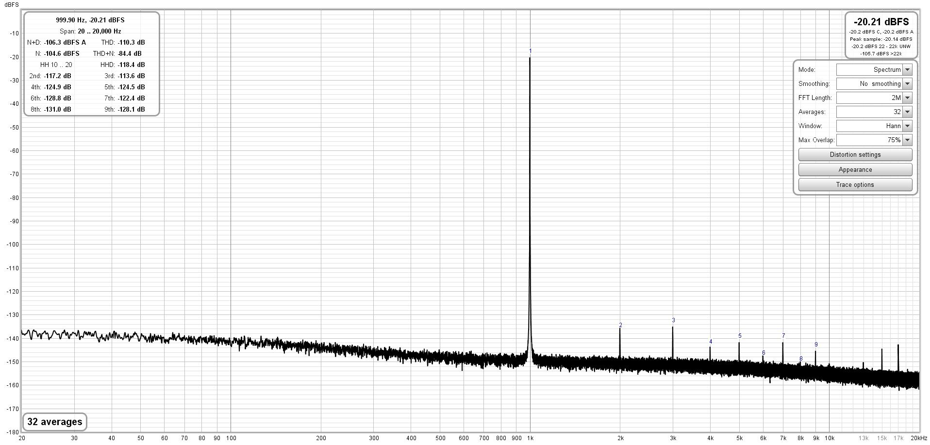

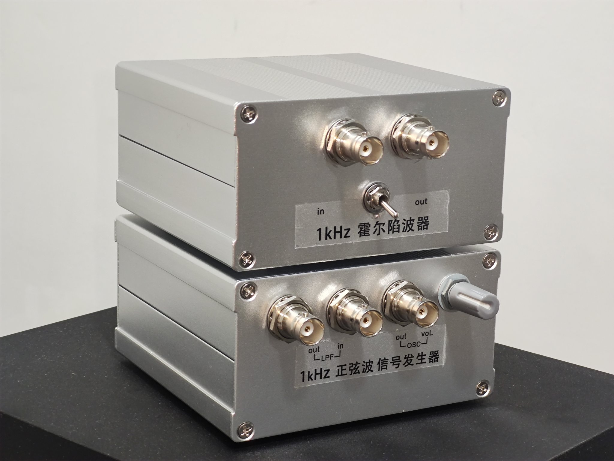

I first used a passive Hall notch filter with a notch depth of 40dB. Then use the OPA1656 to amplify by 20dB.xergxia, can you elaborate why the two plots in post #9883 show a 20dB reduction in fundamental, but your comment refers to a 40dB notch.
The above two pictures were not tested on the same day, so the OSC output levels of these two pictures are not consistent. I may have used a higher OSC output level when using the notch filter.

zergxia I think you'll never see H2 with 1656 <-140-145db if you'll not match the opamps inputs impedance. You can take RT6863S, a very cheap Chinese opamp(1/3 of opa1612 cost) with very high symmetry of the input stage, and in that case, you'll see <150-160db H2. Also, you can try to select from 5-7pcs of OPA1612 the best one, and you'll see <-150db. I've no idea why but 1612 sample2sample is not consistent regarding H2 performance with unmatched input impedances.
I've got Ok result with the posted "Victor's osc" schematic, but yes, I spent a whole day adjusting 1000.2Hz and tried 10 opamps)) 1kHz H2 -150db(after I add some trimpot to adjust the symmetry), H3 -155db. However, the osc is way too noisy to see even -150db without multiple AVG, hence, as a ref sine source it is a very slow instrument. I needed to calibrate 1000pcs of ES9822Pro ADCs and Wien bridge oscillator with so high RC impedance appeared to be unacceptable noisy. Currently, I using DAC+LPF way to get clean as possible ref sine + digitally generated ani-harmonics bouquet to get H2, H3 at -160-170db.Has the original post author tried out a solution that yielded satisfactory results?

It is really not easy to tune the harmonics of the OSC to a minimum
In fact I am really short of a high performance DAC and need a DAC with a cleaner bottom of the FFT
