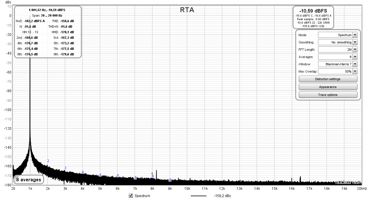

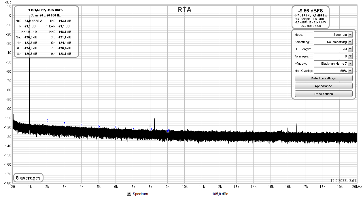

After some time when I have re-checked and re-calibrated my equipment so here are the new results with Victor's 1kHz oscillator + Twin-T notch 1kHz + LNA (OPA1656 with SE to Balance conversion) + Focusrite Forte as ADC.
Again, the first pic is with notch SW file compensation and second one without (Twin-T has -51 dB attenuation on 1kHz, -8,7 dB on 2kHz, -4,6 dB on 3kHz).
Therefore 2nd harm. is -118-51+9= -160 dB, 3rd harm. is -119-51+5= -165 dB (hidden in noise...).
LNA has +32 dB gain, Forte has +20 dB gain, so +52 dB total.
Now THD is around -157/-158 dB (0,000 0014 %)!
It seems that Victor's oscillator is really a low distortion source.

P.S.: The third pic is from Diana SW - the same configuration as above without SW file compensation (harmonics are a bit lower)

Can you repeat the measurements with a marker at -60 dB? When measuring a setup like this there are several places where the numbers get hard to manage. I use a non-harmonic oscillator with a 60 dB attenuator , (1meg in series with 1 Ohm) mixed with a 600 Ohm resistor with the Victor. Your Victor may have a different output impedance. You could easily justify 2 60 dB attenuators in series. There is an issue of leakage around them that will bedevil your efforts if you are not careful.

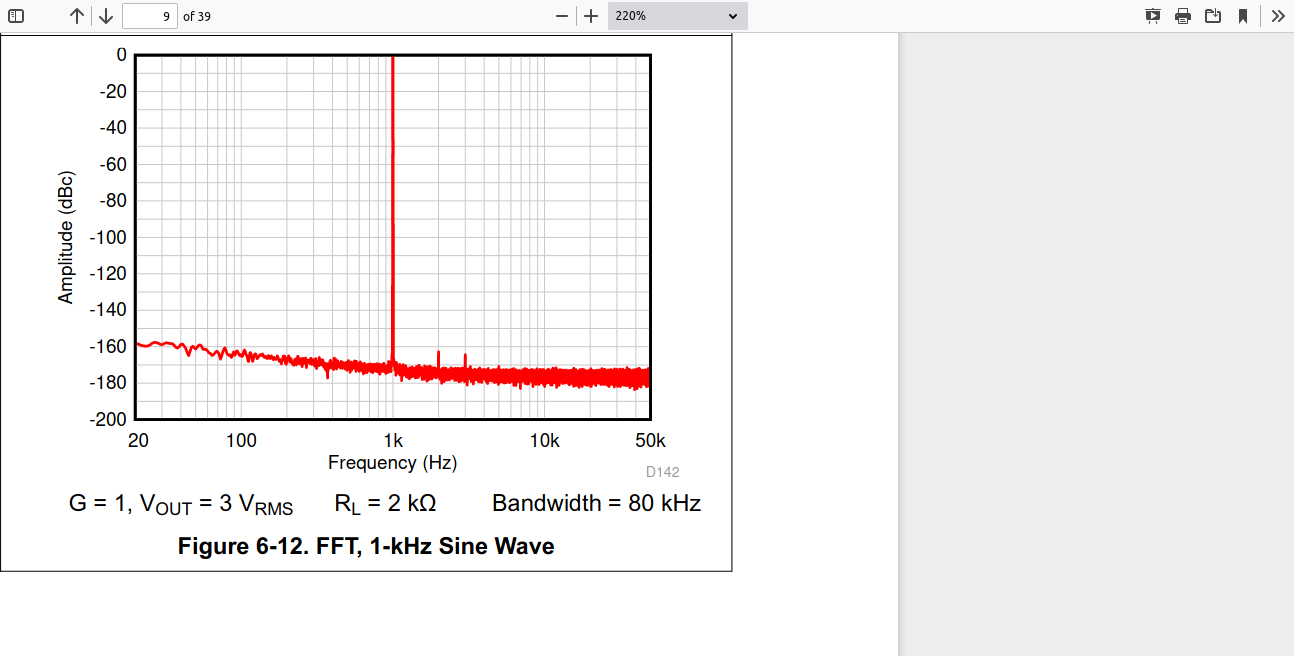

I'm skeptical of these distortion measurements that show one or two orders of magnitude lower distortion than what the op-amps used are actually capable of on their own merits.

That sometimes surprises me too. Even the resistance noise should be much higher.I'm skeptical of these distortion measurements that show one or two orders of magnitude lower distortion than what the op-amps used are actually capable of on their own merits.
From the OPA1656 data sheet:I'm skeptical of these distortion measurements that show one or two orders of magnitude lower distortion than what the op-amps used are actually capable of on their own merits.
Now a plot for 1k and 500R would still be very good.From the OPA1656 data sheet:

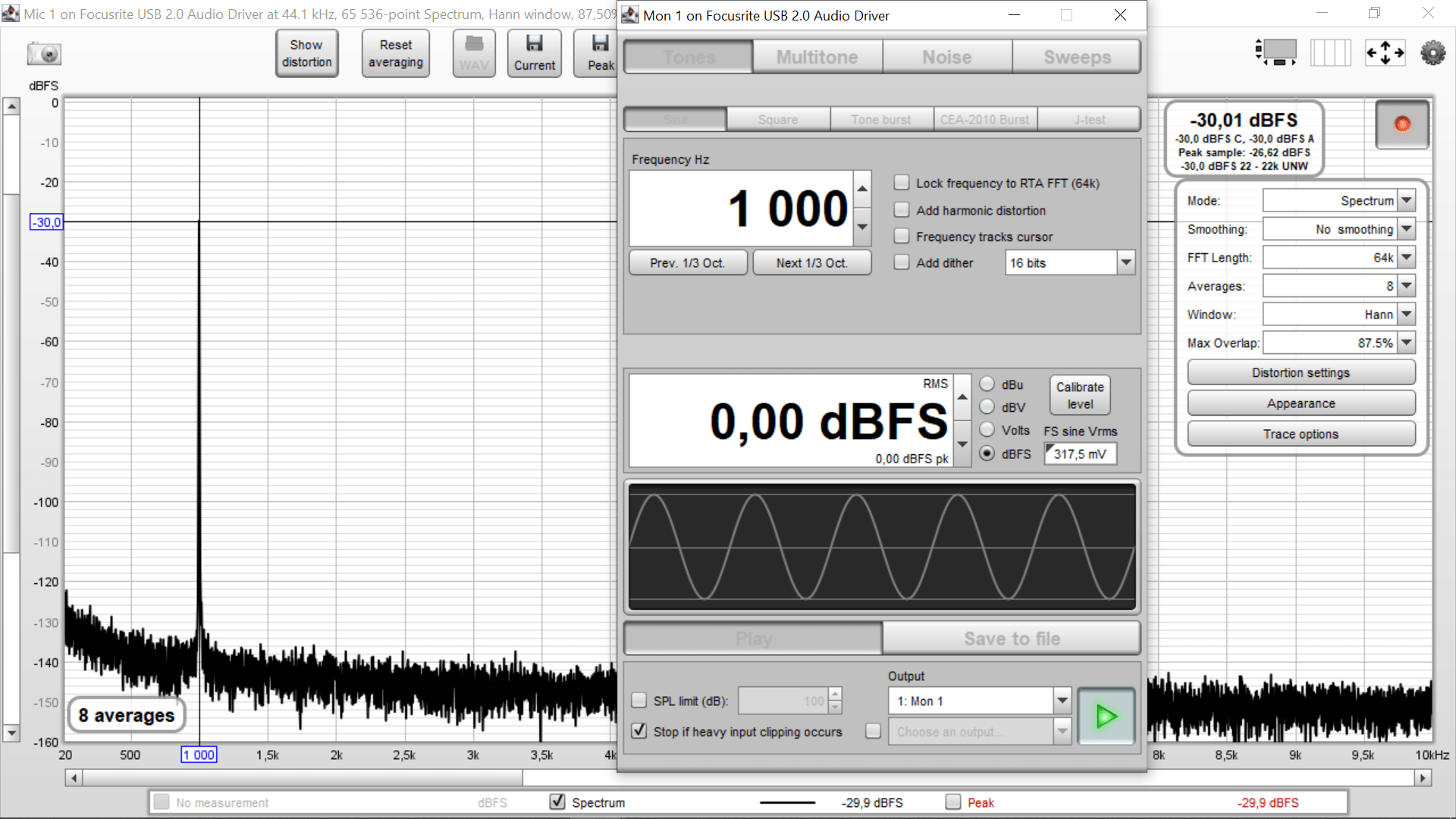

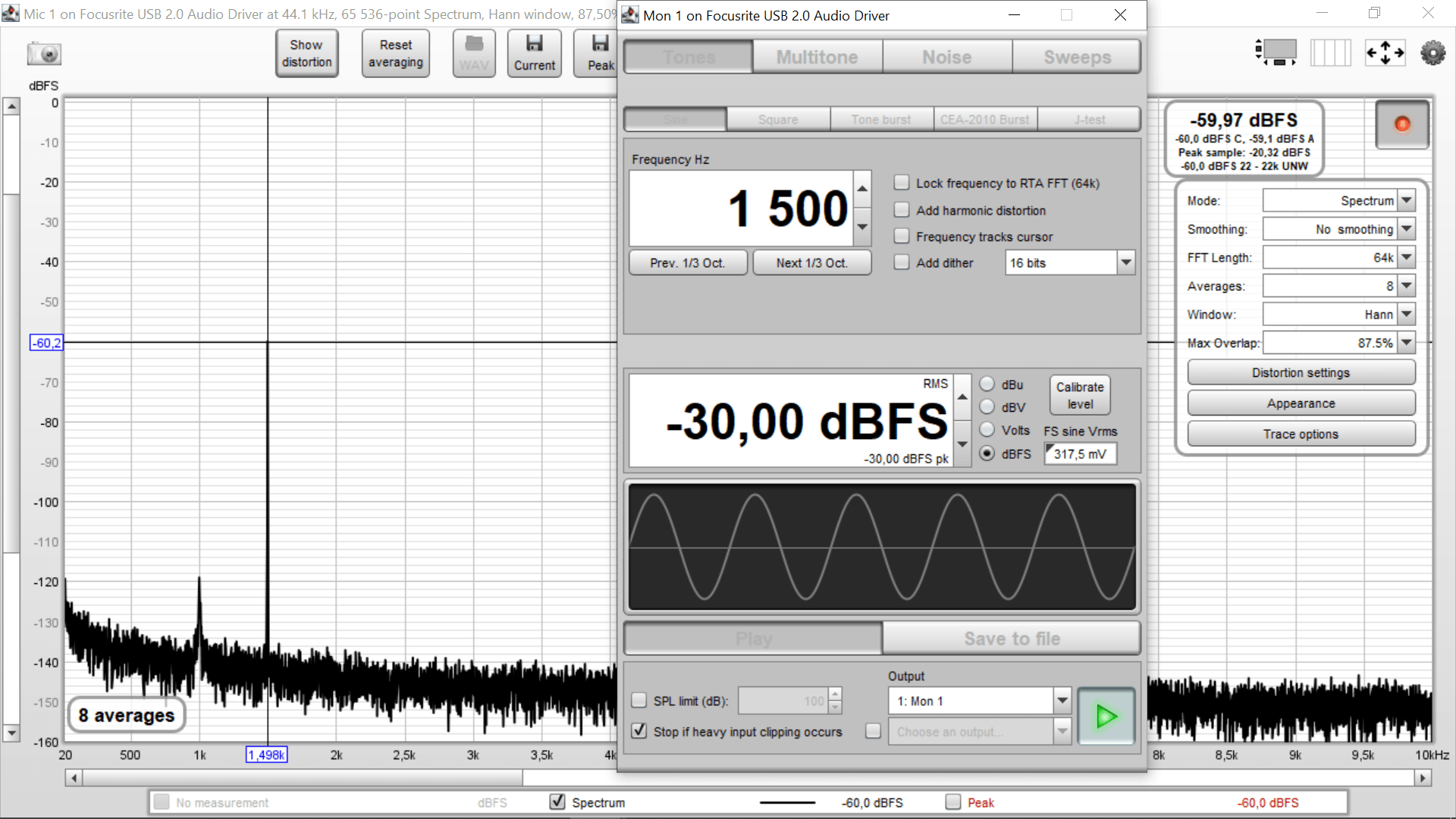

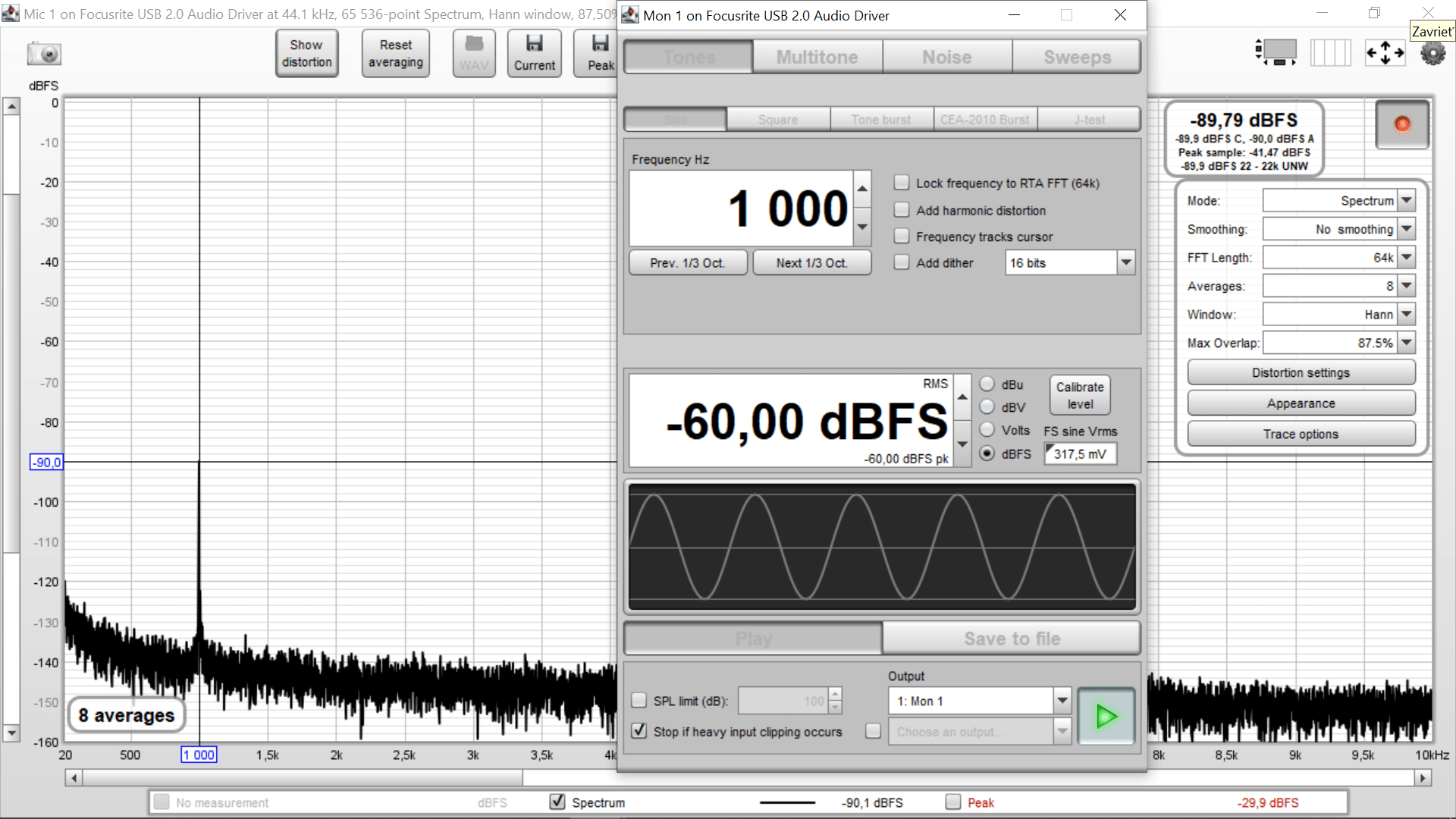

I made a "proof of the concept" withe Forte DAC instead of the passive attenuator (what you recommended) I used REW generator.Can you repeat the measurements with a marker at -60 dB? When measuring a setup like this there are several places where the numbers get hard to manage. I use a non-harmonic oscillator with a 60 dB attenuator , (1meg in series with 1 Ohm) mixed with a 600 Ohm resistor with the Victor. Your Victor may have a different output impedance. You could easily justify 2 60 dB attenuators in series. There is an issue of leakage around them that will bedevil your efforts if you are not careful.
There is a way to create and use a correction file with Diana.
So same gear as before (Twin-T 1kHz notch, 32 dB LNA, 20 dB on Forte gain, REW with notch compensation file) but Vic oscillator was substituted by Forte DAC and REW generator:
- 1st pic is maximum signal 1 kHz what I can use with Forte via USB powering (circa 317 mVrms SE output) with few dB lowered on Forte driver to -30 dB on the scale for easy reading (0 dB REW generator),
- 2nd pic is signal -90 dB 1 kHz on the scale (-60 dB REW generator),
- 3nd pic is signal -60 dB 1,5 kHz on the scale (-30 dB REW generator),
- 4th pic is signal -120 dB 1,5 kHz on the scale (-90 dB REW generator).
I hope this is good example that it works as predicted.
Martin
P.S.: I had some problem with combining Vic oscillator with passive attenuator "injection marker" due to the low output impedance - my oscillator has 100 ohm and always found imbalance with my combinations.
THD=-150db were confirmed in the Victor's OSC review 😉

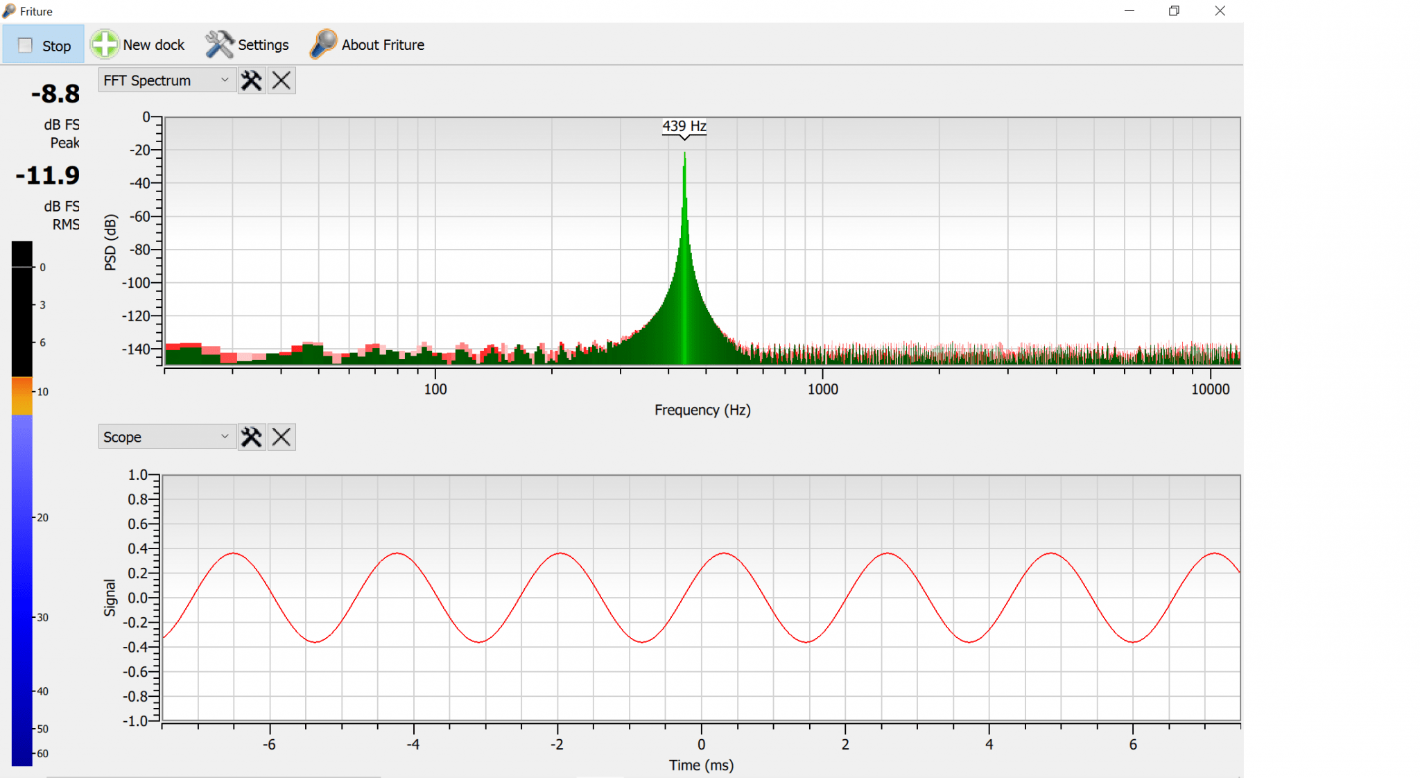

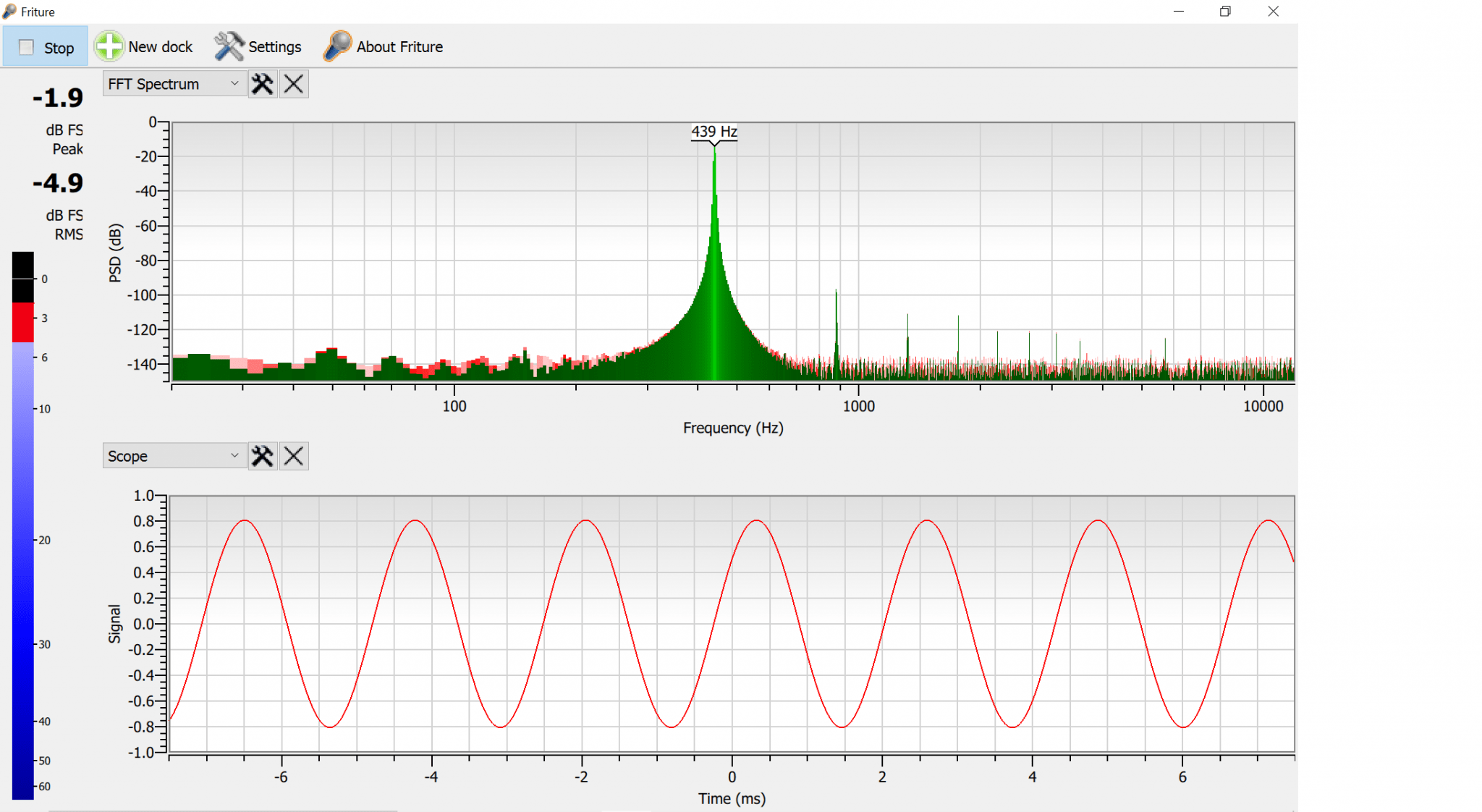

Hello,
To add two measurements of the "janascard", mine is at 440Hz.
Done with MOTU M2 and E1DA COSMOS ADC ("out of the box" no mono mode, just input set for 2.7V). 16384 points for FFT.
I'm a noob but janascard + cosmos ADC looks really good for the price !
If you bought Cosmos ADC for the measurement and you already had Motu, you did spend money far not optimal. Cosmos APU +any "just Ok" ADC 100% outperforms Cosmos ADC.Hello,
