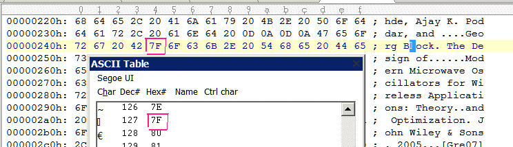

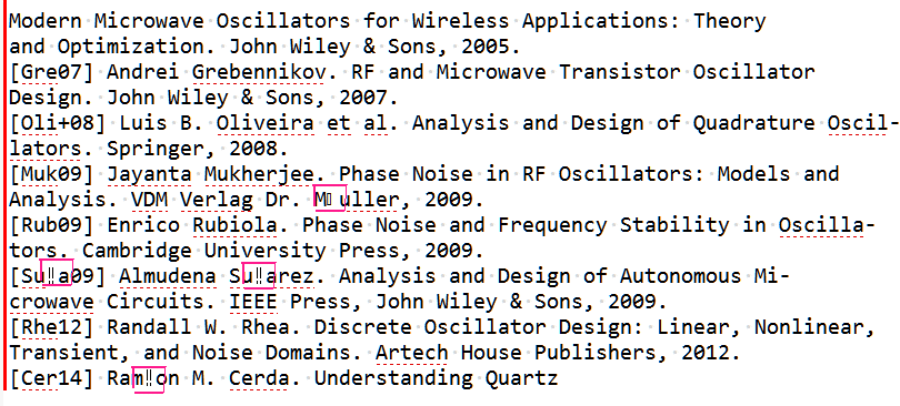

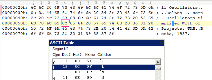

FYI: first page of references, "[Sch55] Alexander Schure. Crystall Oscillators", should maybe be spelled with one "L"? (Two Ls is not wrong but is extremely "obsolete" in modern English; 'For the most part it resembleth Crystall: which is the reason that some hath tearmed it the root of Crystall. William Gilbert of Colchester', late 1600s) Yes, I learned OCD spelling at my mother's knee.
Also, this may just be Adobe PDF being stupid, but in extracting text there are mis-encodings or something. These do not affect eye-reading but may foil mechanical indexing.

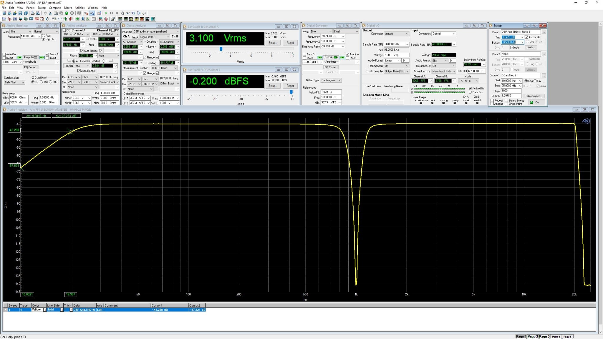

zergxia, actually John did correct his REW in May 2021, so 2022 versions should be Ok. However, he extremely simplifies so-called "AES17 notch" needed for THD+N, REW simply ignores H1+/-40% but AP2700 for instance, does that like that:
So, even REW, and Arta aren't perfectly matched vs AP regarding the THD+N. Other FFT apps seem never heard about AES17_notch requirements at all, hence, they deserve to be ignored, in my opinion ))

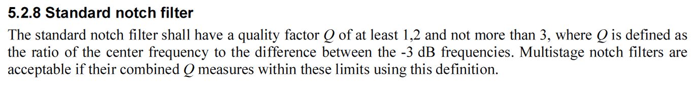

I looked up the definition of AES-17 notch filter, attached below. Its pretty broad with a Q of 1.2 to 3. This is in the digital audio spec which may be why it's not well known. Its actually modeled on the AP and the Shibasoku analog notch filters. I worked with Matt at Quantasylum on this exact issue. Digital sources are pretty good on close in phase noise compared to analog RC oscillators. Its much easier I gather to just blank areas around the fundamental and depending on the selected window you won't get any leakage from the fundamental.
The band limit is specified to be 20 KHz with a really steep rolloff, 0 dB @ 20 KHz, 60 dB @ 24KHz. Not remotely easy in the analog domain.

I'm not a big fan of trying to reproduce analog limitations without good reason. An analyser which notches out or band limits the signal in the analog domain is subject to the limitations of what can be implemented there. If everything is done in the frequency domain and the notching is only for the purpose of calculation I don't see the logic in replicating those limitations, whether that is in the notch or the distortion bandwidth. If your chosen THD+N upper limit is 20 kHz should 22 kHz really only get 30 dB of attenuation? As mentioned above, AES17 only specifies a Q range for the 'standard' notch, there is no specification for shape. Frequency-domain filters are not an issue in general though, appendix B discusses them.
A related question is at what point does the skirt of a fundamental become part of the noise instead of part of the signal? What shape of skirt is acceptable and what shape not acceptable? The AP's notch shape makes that decision for you, with the degree to which the skirt is attenuated depending on its width relative to the AP's notch. What is the theoretical basis for that?
I'm not sure perpetuating the limitations of older equipment is a good thing, but appreciate reproducibility of results across equipment is an issue. However, standards should live up to their name and specify filter shapes if they are considered relevant to a result. Coincidentally the AES17 not-so-standard notch is one of the topics I'll be raising at an AES meeting next week.
In the end it's only calculation, so if folk feel strongly about replicating the AP's notch I can do that, if I can find an accurate definition of the transfer function.
