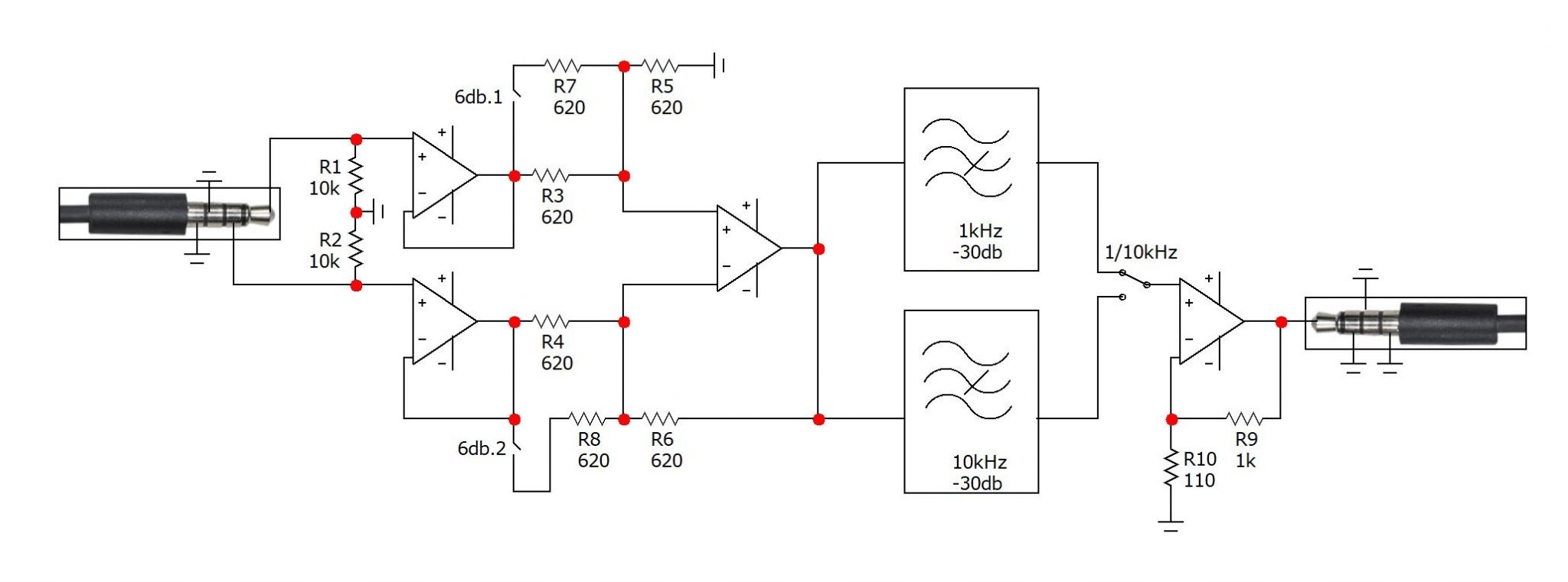

An astute observation. I had considered using one of the op-amp sides as a unity input buffer, and I may change over to that instead of having two separate output amps. How would you reduce the notch impedance 100X? Change the R & C values respectively?mikebeth, the input buffer is missed, hence, different sources will affect the filter's Q, Freq. Also, I'd like to reduce the Notch impedance 100x times to keep it capable measure THD+N as well.

For the breadboard (with the C's handpicked) I used three 100ohm pots and found the null at 1kHz for Victor's oscillator (once it fully warmed up) to be fairly easy to achieve a 90dB null by "twiddling" the three single turn pots with the Q factor chosen by the R9/R10 ratio.

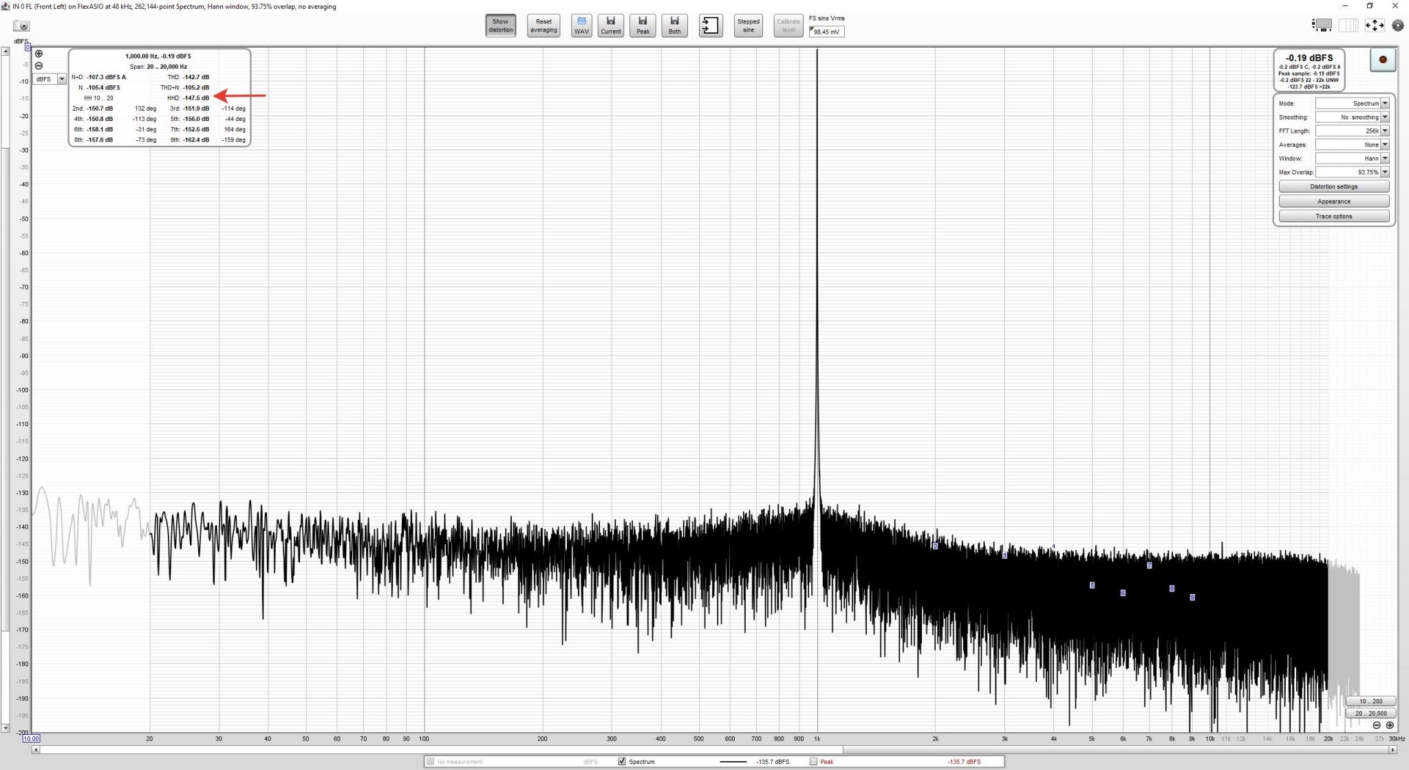

yep, just too high an impedance will produce a lot of noise. I use up to 200nF caps to see down to -135db of THD+N. However, I have never seen so low THD+N on my bench(Matlab simulation only) due to the flaw of my sine source(DAC+LPF), only -132db.
So you would suggest bumping the C's up to 220 and 22nF and cutting the R legs by 1/10? Will look into that. Thanksyep, just too high an impedance will produce a lot of noise. I use up to 200nF caps to see down to -135db of THD+N. However, I have never seen so low THD+N on my bench(Matlab simulation only) due to the flaw of my sine source(DAC+LPF), only -132db.
Hello vicnic ,I 'm in China, how can i get your board? I dont know how to contact you > may i have your email?According my own measurements all the 1kHz boards, that was built within last year or little more, have the harmonics lower than -150dB at full output 2,8V RMS. Typical harmonic levels are around -155dB, but some boards may go to -160dB. Also I observed the artifact when the boards often may have significantly lower 3H, when the opamp output is under the load around the 1 kohm.
From the first time, all my measurements was done via the passive twin T notch. Now I am using 1kHz twin T built from the selected polystyrenes from RCL components and the metal film resistors of course. As I previously wrote, every capacitor must be tested before using for the ULD measurement purposes,, because the some examples may distort relatively high. Only statistics, logic and step by step implementation can help in this way.

Aha, I use 100nF and 100nF//100nF for 1k and 10nF 10nF//10nF for the 10k. In that case, we 100.0% need a serious buffer to drive the notch perfectly.
To be honest, you also need the differential stage(again with the lowest impedance possible) before the buffer, and each of In+ and In- also needs buffers to get high input impedance. Without such a differential=balanced input I wouldn't go to measure <-130..-140db harmonics.

I will have to evaluate the difference switching to that more elaborate front end would have on performance for my system. It will be easy enough to add to the existing breadboard work.Aha, I use 100nF and 100nF//100nF for 1k and 10nF 10nF//10nF for the 10k. In that case, we 100.0% need a serious buffer to drive the notch perfectly.
And the simulated or rather, semi-simulated result of the THD+N -105.2db-30db=135.2db

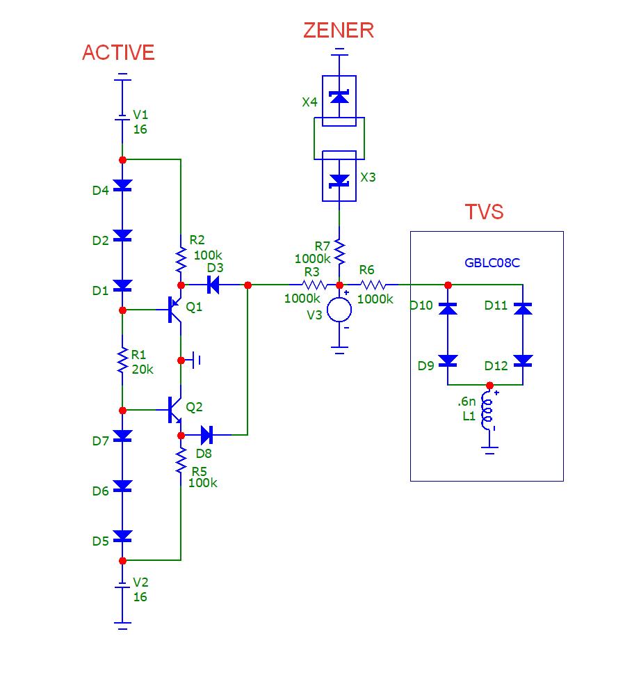

Input signal protection is a good practical consideration which I had overlooked. Thanksmikebeth, Oh, I forgot some minor but critical detail - the input protection! I took an active clamp with 5A BJTs pair ZXTC2045 to follow up the opamp's rails.
