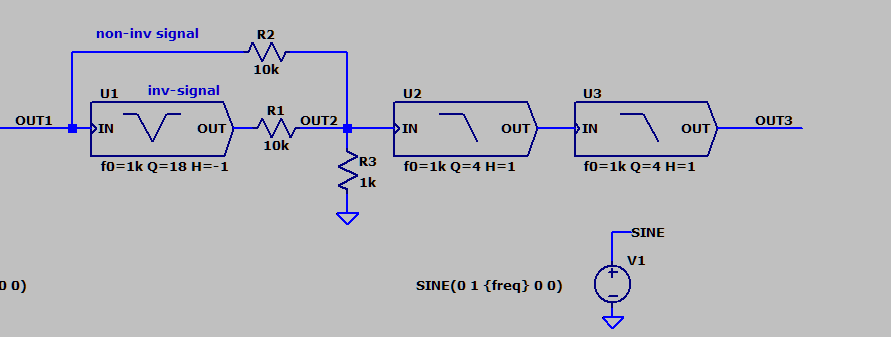

These techniques usually do not work because of the strong temperature dependency. There is always an imbalance.
Here is the basic concept.
We started with a Total Harmonic Distortion of 0.017219% (Vout1)
V(out2) is already at 0.000401%.
V(out3) is at 0.000002%
Of course this is idealized, like I said before, the biggest contribution would be the caps here as well as the opamp (obviously).
The beauty of this technique, is that the sine wave coming out of the DAC, from like a PC or DSP, can be precisely tuned at the notch frequency, since we are not interested if we have a perfect 1kHz sine wave (1.05kHz will do fine to measure equipment).
I estimated a notch with a Q of 18, the higher this number is, the better.
Also here the caps have the highest tolerances in practice to get the Q as high as possible.
Although 0.5% is available I think.
0.018% THD is already quite a bit, I just modeled this with some sinewaves, up to the 7th harmonic.
In reality the distortion from the DAC will be much lower, and everything else will scale accordingly.
The notch frequency can be found by using a differential amplifier with the original signal and the signal coming out from the notch.
Most computers are capable of a samplerate of 44.1kHz.
So this means a FFT length of at least 88.2k is needed.
I think that is very doable. Most programs are capable of a FFT length of 256k even.
Exactly. BTW, I have followed a more digital route. The output of the (passive) twin T filter is used as input for a feedback loop (via a separate ADC and DAC). The amount of feedback is controlled digitally and updated once per second.
Also the DAC frequency is adjusted (also once per second) to stay tuned to the notch frequency.
In this way I could reduce the THD of ten harmonics well below -180dB (noise, hum or spurious 'gras' is of course much higher).
Cheers, E.

That's a very nice an elegant way as well!
Makes a lot of sense 🙂
I guess you did the feedback loop with something like mathlab or something?
Or more something like xcos/simulink (labview)?
Mind sharing more information?
The biggest challenge is indeed mostly getting the noise floor down.
At these levels, a lot is gonna depend on a proper PCB design.
