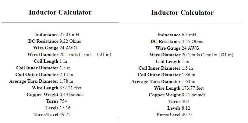

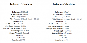

Here are inductor designs for the 1 KHz filter. They are quite substantial and this is not really ideal even. The 3/4 Lb of copper says this is an undertaking. They should be segmented or the parasitic capacitance will degrade the performance. I would also use Litz wire to get the best performance on the higher frequency attenuation. Maybe 24 AWG is larger than needed. I would defer to a local magnetics expert (please) for a better implementation.

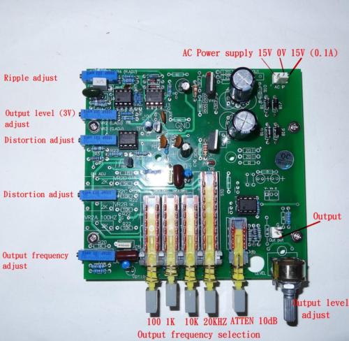

Next time please include the link Low distortion(0.01%) sine wave generator (oscillator) module with CD test disc | eBay
its interesting. Not sure how tweakable it is.
There is also this:
Assembled Low Distortion Audio Range Oscillator 1KHz Sine Wave Signal Generators | eBay $14. I have one but did not get into tweaking it. Given the lengths Victor goes to to get performance this may only make sense as a bare board effort: Low Distortion Audio Range Oscillator 1KHz Sine Wave Signal Generator PCB Board | eBay and then you select and tue every key component.

?? I did. It's below the picture.
I ordered one so you don't have to. .... so i can play around with it and pass on info to others. I'm also going to apply post LP filtering to it using IC filter.
Nice thing about it is -- it is Not one freq only per pcb.
Distortion goal is modest -115 -120dbv (or better). Which is suitable for many DIY projects.

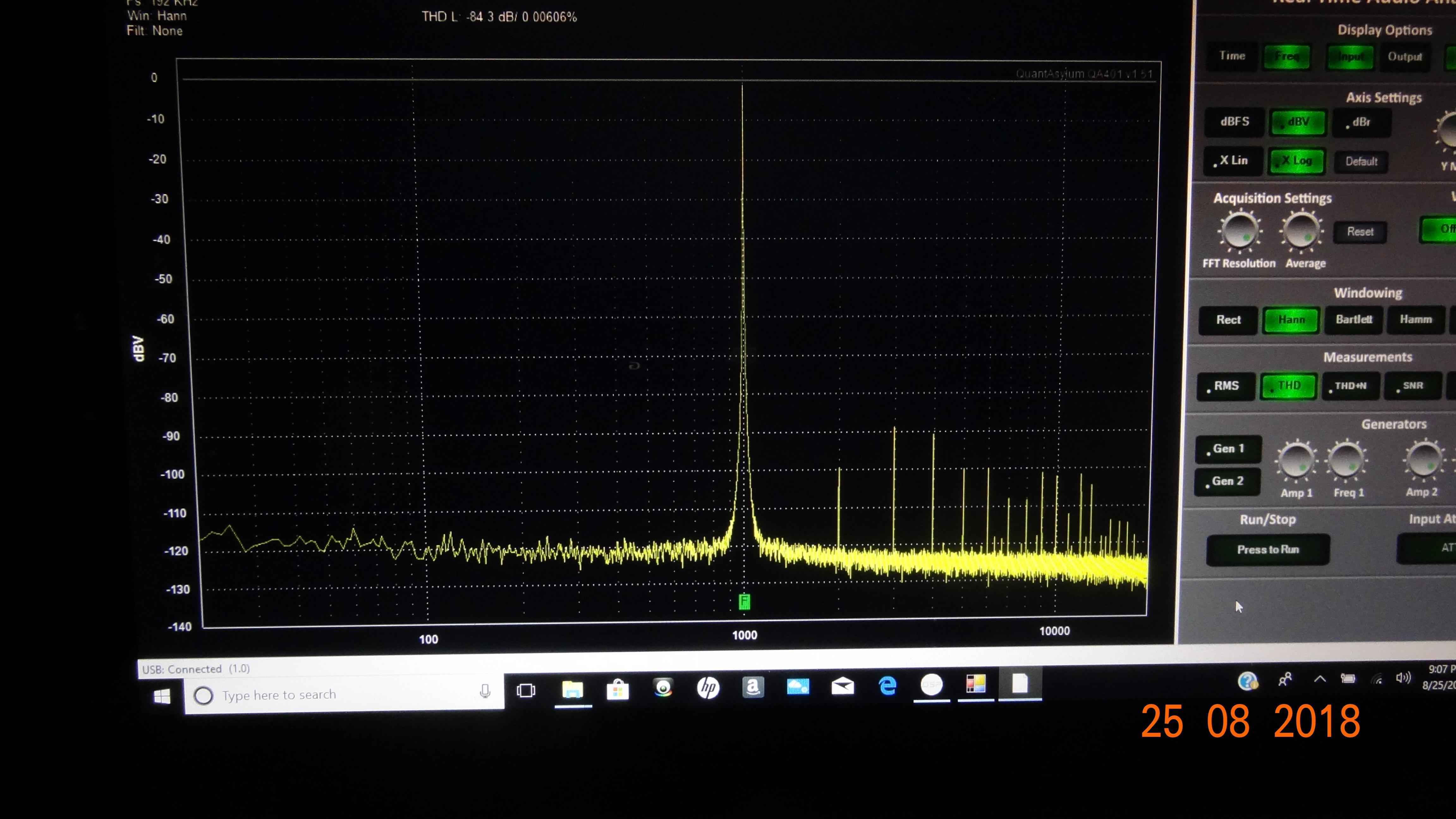

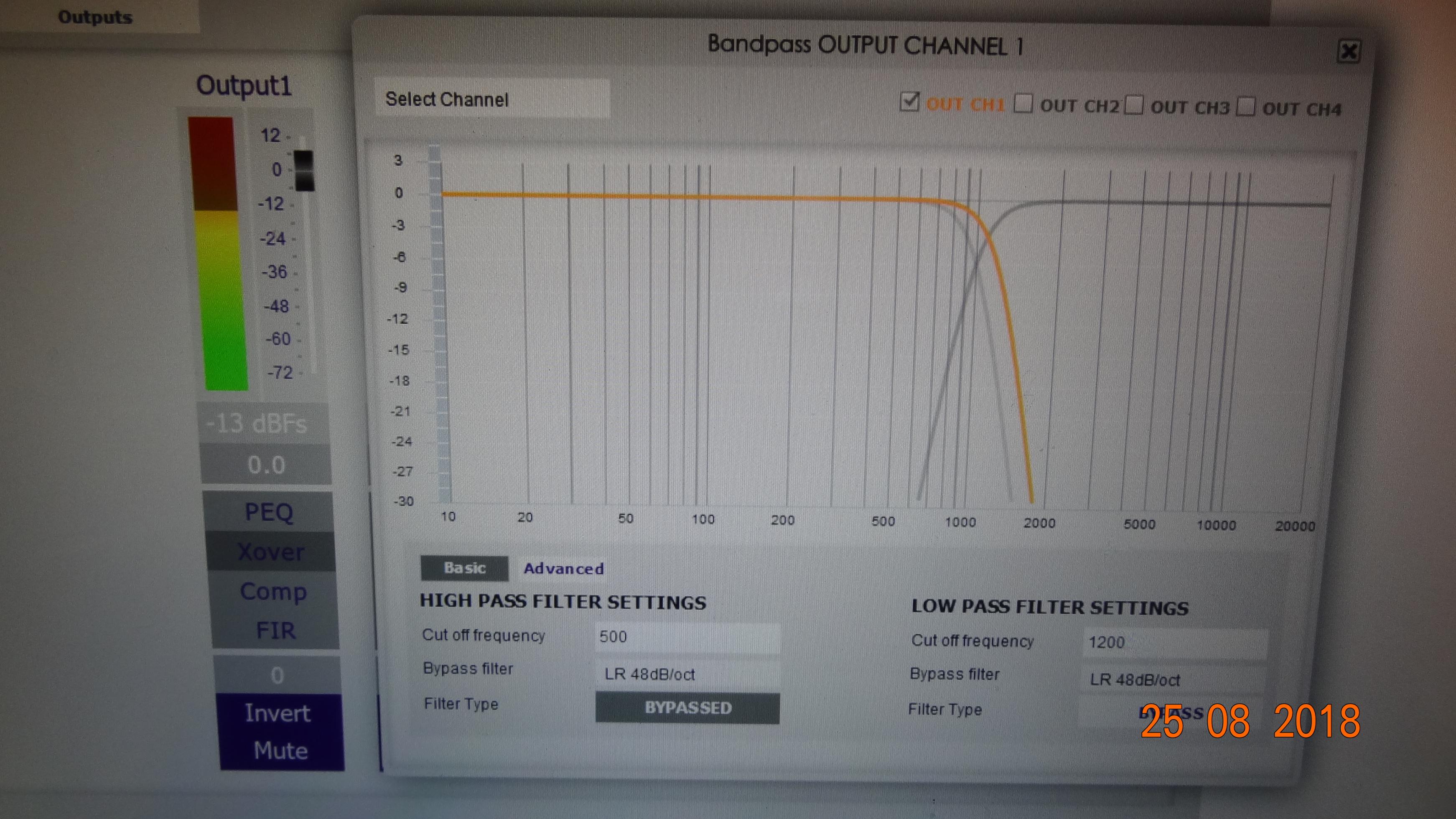

I used a function generator with 16 bit oscillator. Then ran it thru a miniDSP filter.
With no LP filtering
1KHz LP filtered
I checked with an ULD source and the residual is all from the miniDSP. Maybe better parts/opamp is needed. But shows the idea of adding a LP filter to an inexpensive osc output will produce potentially very low THD.... good enough for sound-card style analyzer use. It works very well. A passive filter could be used also. But not as flexible.
I'll find a cleaner DSP filter and try again. Or maybe try replacing parts in miniDSP. I like being able to dial in any LP filter freq with the miniDSP.

the opamps used in the miniDSP are limiting it, also. The opamp ___2068 which is spec'ed for typical thd of -100 (,001%). But -110dbv shown is usable for a lot of products as it is.
I have ordered OPA1612 to replace I/O opamps. If that is all it needs, then we have a nice clean variable filter to use with cheap variable freq generator (Hantek HDG2012B. A nice general purpose Arb. function generator).

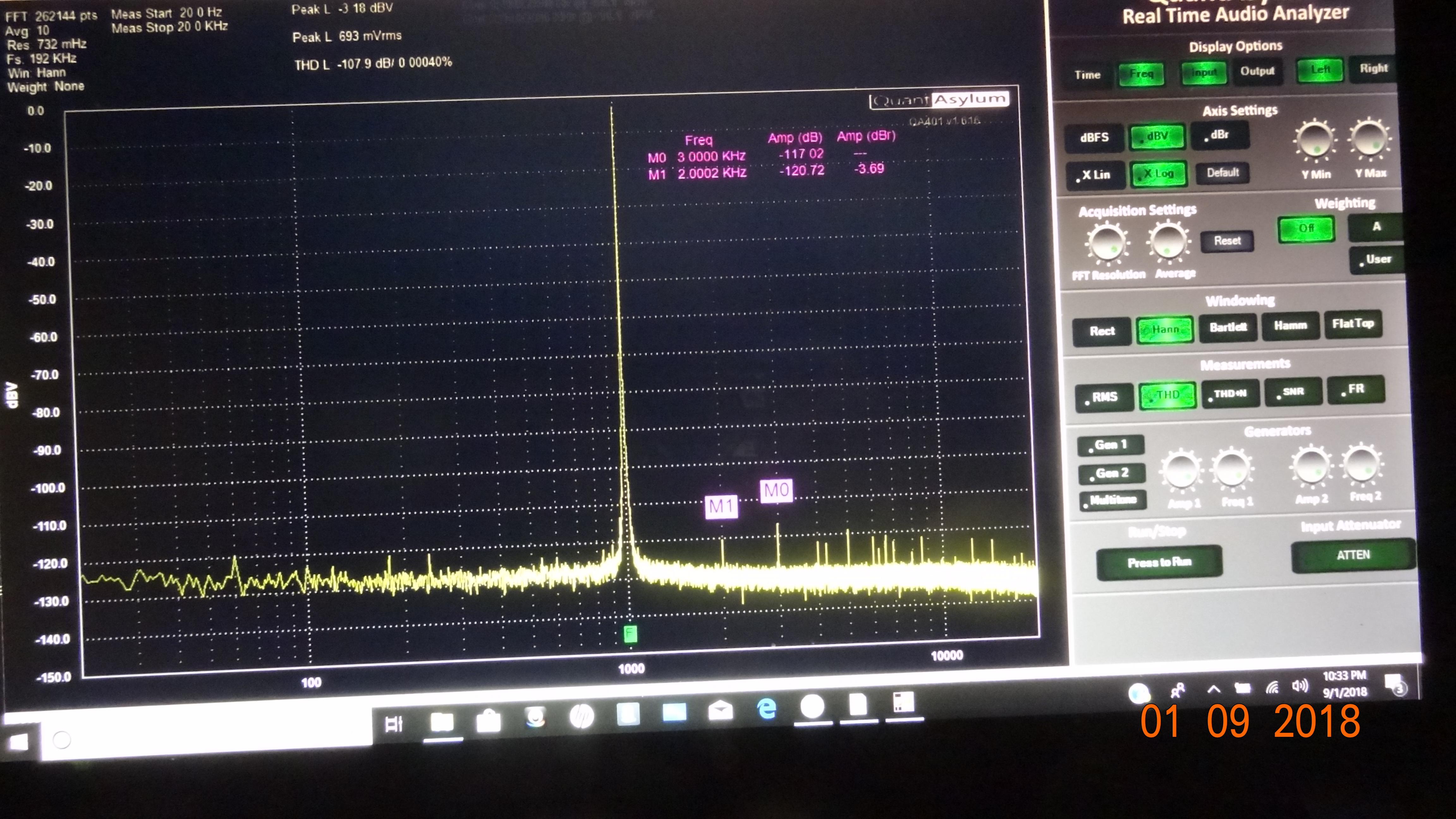

Here is the minDSP variable LP filter with its output opamp changed to OPA1612. and using a better gen. (also variable freq).
2H and 3H are near -120dBv.
