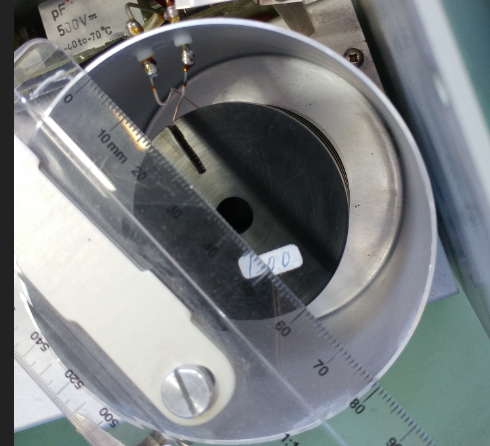

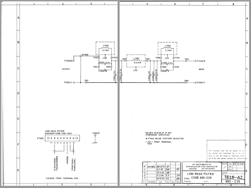

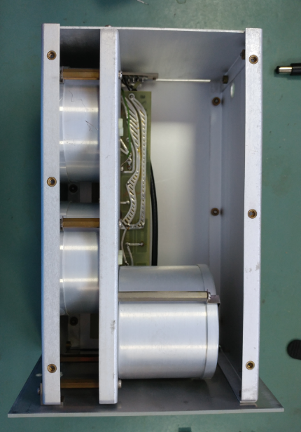

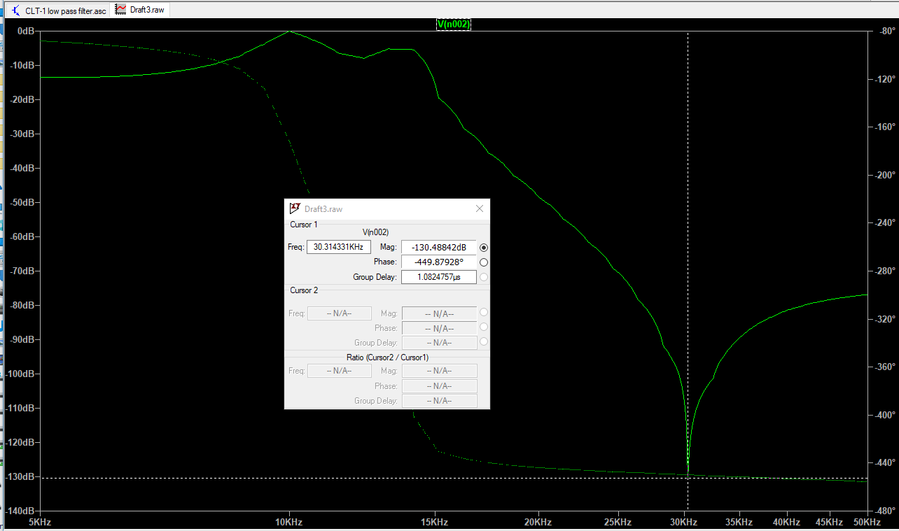

Here is an example of a passive low pass filter. In simulation, it gets down to -130 dB at HD3. At HD2 its -80dB. Photos of the physical implementation are included. This is for 10 KHz. The core for the inductors seems to be something like Delrin.
It could be scaled to 1 KHz. Below that would probably be pretty crazy.

That looks good you could run a really good DAC at 15K through that and get 70+dB at all harmonics, again how do you verify it? The 1K version was a pain I used 100's of feet of #18 copper wire, the Q was not as good as that but I managed -40dB over the SoundTech 1700 (~-106dB).

The simulations I am working on are elliptic filters, where a zero can be placed at either the 2nd or the 3rd harmonic - or somewhere in-between. The 3rd harmonic is typically the highest for the AK4490, so that is probably where I will start.
In the simulations the 3rd harmonic (3 kHz) is attenuated by around 48 dB. The 2nd harmonic is only attenuated by 14 dB in this case.
The filter is a 3rd order filter.
Higher harmonics are attenuated by at least 30 dB.

Per your request- The CLT-1:
Double shielded 19" W X 24" H X 12" D (for something made in a Metric country it surprised me that the dimensions are exact inch). It also weighs about 40 Lb of all aluminum construction. The case is two layers. The output is transformer coupled for all ranges except the center one.
Per Scott's note, how do you verify the performance? At -160 even metal film resistors can exhibit some distortion. Actually, at those levels it's more of a modulation effect from the signal than a material nonlinearity. However, everything will start to show some impact at those levels. You really cannot seperate the source from the analysis.
