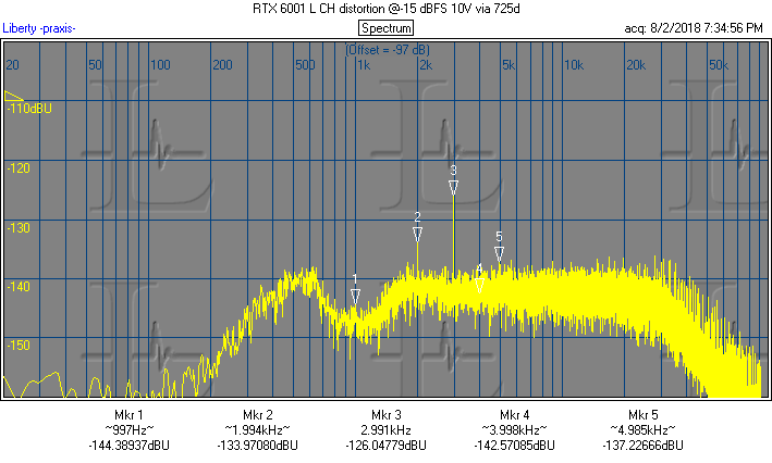

Here is the distortion of the source side of the RTX 6001 via the 725D. Its scaled so the levels are corrected. HD2 is -133, HD3 is -126.
While cancellation seems like a good trick an analog filter may be able to get there with less hassle. This is at about the best level (-15 dBFS). You have about +/- 3 dB before the performance is degraded. So visions of digital level etc. are probably not productive. Ideally a passive filter would be a great solution. J Curl has suggested just putting a good cap across the output will get 6 dB at F2 and 12 dB at F3. The CLT-1 uses a passive filter with inductors to get to -160+ (mine seems to get to as much as -170 dB) but those are not off the shelf inductors. They a big pot cores and it runs at 10 KHz only.
P.S. The ADC/Analyzer side of the RTX is lower distortion than the source, but I wanted to remove any questions about the measurements.

To put this into perspective there is probably no recording or reproducing chain with enough performance that this setup cannot evaluate its total performance. Certainly, no analog chain and I don't know of a digital chain at this level. So while better performance is a good thing it's not going to reveal much.
