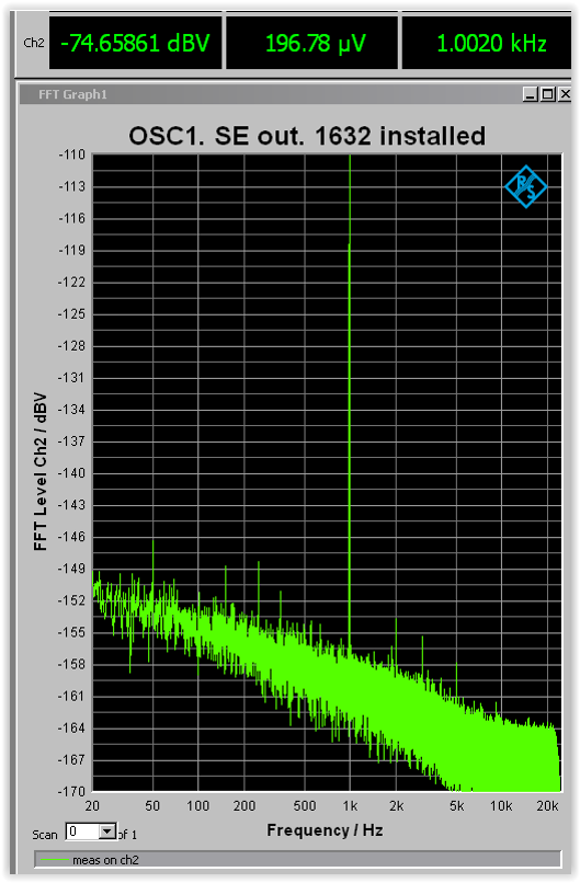

I just bought a 1kHz oscillator from Victor and made a notch filter to measure it using an R&S UPV Audio analyzer.
Here it is at 2V RMS with a passive notch that has -10dB at 2kH and -5dB at 3kHz.
Adjusting for the 10db drop from the notch and the signal of 2V (+6dBV) this translates to 2 order of: -153,5dBV + 10dB - 6dB = -149,5dB.
3 order is: -155+5-6 = -156dB.
Very nice result indeed.
Please note that the distortion we see can be from my notch filter using C0G capacitors, so the actual distortion migh well be even lower.

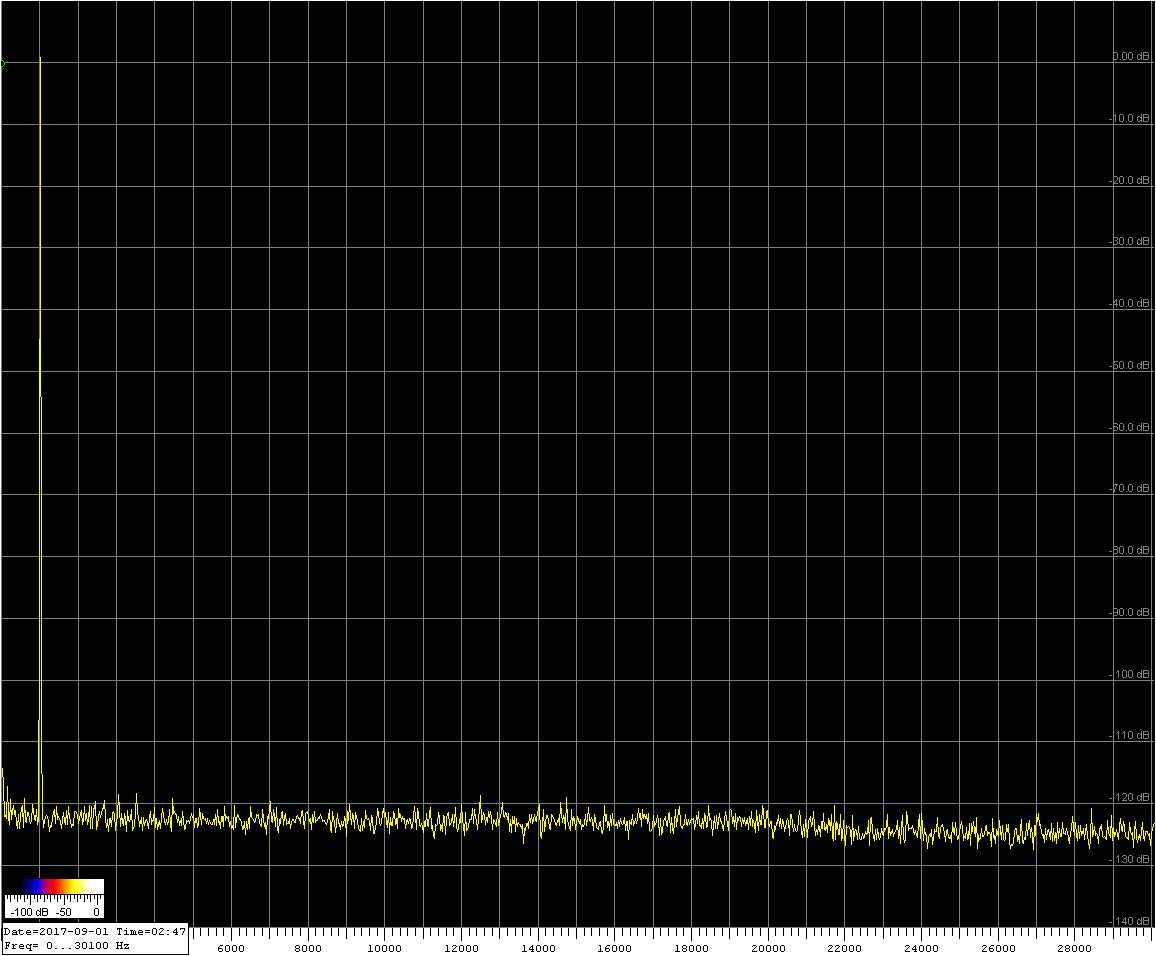

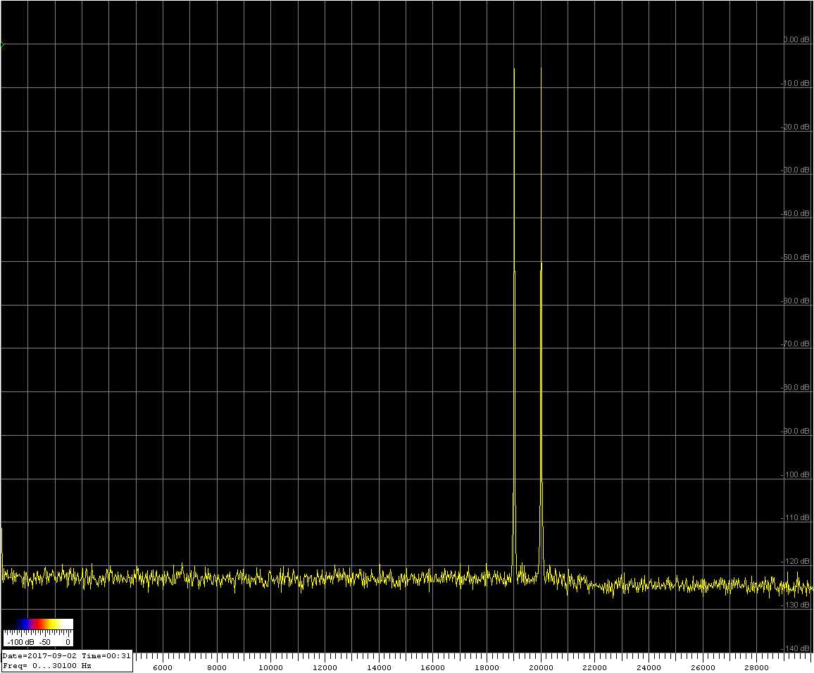

Here is an interesting digital approach..... with LP filtering and the high number of bits used, should be ultra low distortion and very repeatable and precise:
DASG - Digital Audio Sine Wave Generator
THx-Richard
THx-Richard
The precision and repeatability are definitely there, but the THD would be that of the PCM1794 DAC that he uses, i.e. -108dB at best.
