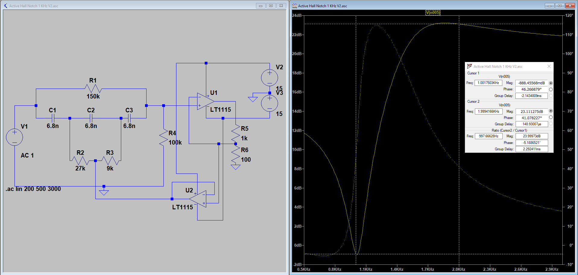

20 dB low Q notch to go in front of an analyser
Off and on for years I have been looking for a low Q notch I could put in front of a conventional analyzer to increase its sensitivity. The problem with the passive notches (and the active ones) is that the fundamental is essentially removed leaving nothing for the analyzer to work with. If you try to lower the Q usually HD2 is attenuated and the usable passband (+/- 1 dB) is still quite narrow.
The link to the Hall filter writeup PCB for Samuel Groner's low distortion passive notch filter suggested a way through this and at least in simulation it works well. With 20 dB of fundamental attenuation the harmonics from the opamps should not be an issue except for the ultra oscillators discussed here lately. HD2 up is within 2 dB so the instrument will read correctly. Scaling by 20 dB or one order of magnitude is easy to manage.
The low Q means that the fundamental can be between 960 Hz and 1060 Hz without significant compromise in measurement accuracy (+/- 1 dB).
This is different from Bob Cordell's distortion magnifier since this is targeted at sources and extending the performance of conventional analyzers. On paper you can take an instrument with a -100 dB floor to -120 dB. However noise etc. will probably limit the performance.
I have been thinking to use Jan Didden's Autoranger and take the balanced output to a soundcard and the unbalanced output to Samuel Groner's notch filter + a post amp and take that to a second input to the soundcard. That way we still have the fundamental available to the software analyser.
Any thoughts on the idea?

It's an excellent solution if you are up to the software challenges. A quick workaround is to overlay the two channels but you still have some issues with scaling and reading the results. Software to make sense of the two channels would be better but not simple.

I tried this but there is pole canceling effect even with active component buffering. Lower Q is easier to achieve with LCR because the damping is already naturally there. I think we need to dig into more advance filter books and or software..maybe if an inverted version of a high Q notch filter was blended/combined with the non-inverted notch, we can have narrow (high Q) without high attenuation at the notch freq??
