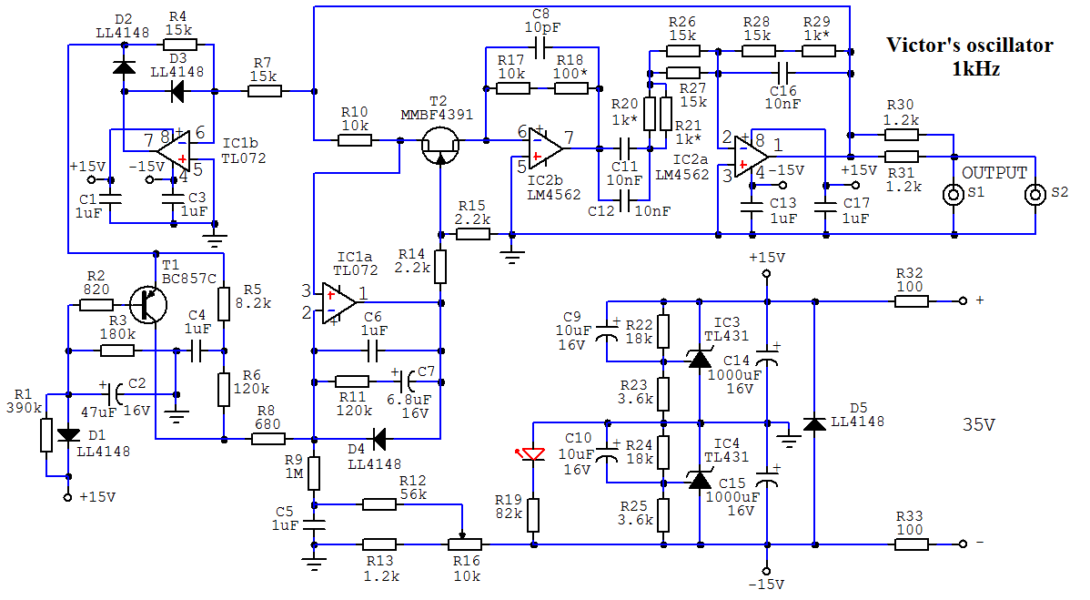

Victor, can I just connect the new +/-15 to appropriate points for the opamps, and leave the TL431 stuff as it is, or will that cause problems?
Have you published a schematic and board layout, I can't find it online.
Jan
If you use the SSW leave the 100 ohm resistor in since the switcher is a voltage source. Any difference above needs to be dissipated.
Caution with the TL431, they can oscillate on the reference pin at about 10kHZ if they are not happy.

Here is the old 1kHz schematic.
If you wish to connect the external +/-15V supply, then you need to short resistors R23 and R25, otherwise the TL431 can be damaged.

If you have better regulators anyhow, why not just remove the 2x TL431's.
Afterall, they are not the lowest noise regulators you can have.
