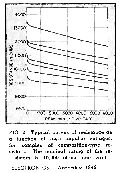

re: resistor distortion... I have not read this whole thread but just saw data from 1945 showing change of resistance with "impulse voltage" (apparently from spark-ignition studies).
Note that the resistance drops very steeply as you come zero to 200V, and curved.
Yes, these are "composition" resistors, today regarded as crap. Film resistors are significantly better; but a hundred dB better? Gotta check.
And yes the steady-state rating of the resistors is being grossly violated. (Practical ignition suppressing wires are glass fiber dragged in soot, spreading the stress over the full length of the wire.)
They say this of wire-wound:
"The fixed arms of the bridge may be composed of inductive wire-wound resistors. The inductance so introduced has only a negligible effect on the accuracy of measurement at the frequency of the pulse wave. A 10,000 ohm wirewound resistor, with zero-voltage coefficient when measured at 10,000 volts, reads within 0.5 percent of its resistance at 6 volts d-c."

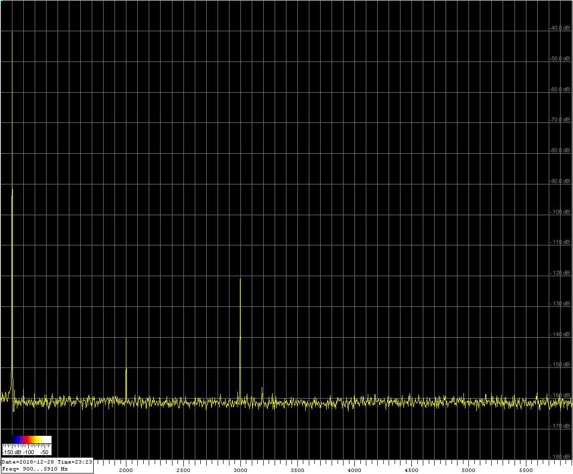

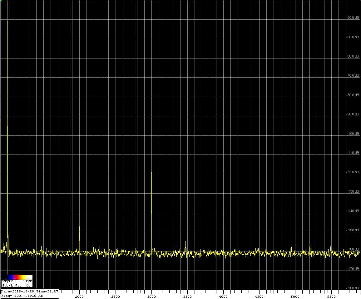

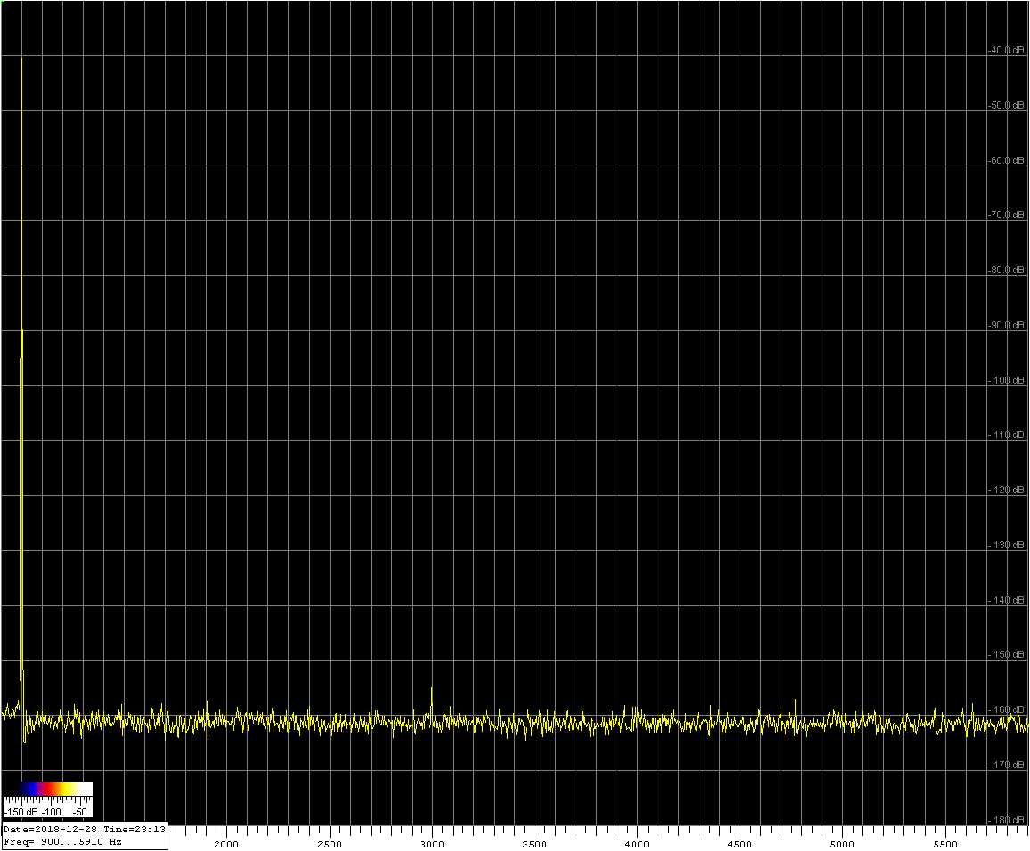

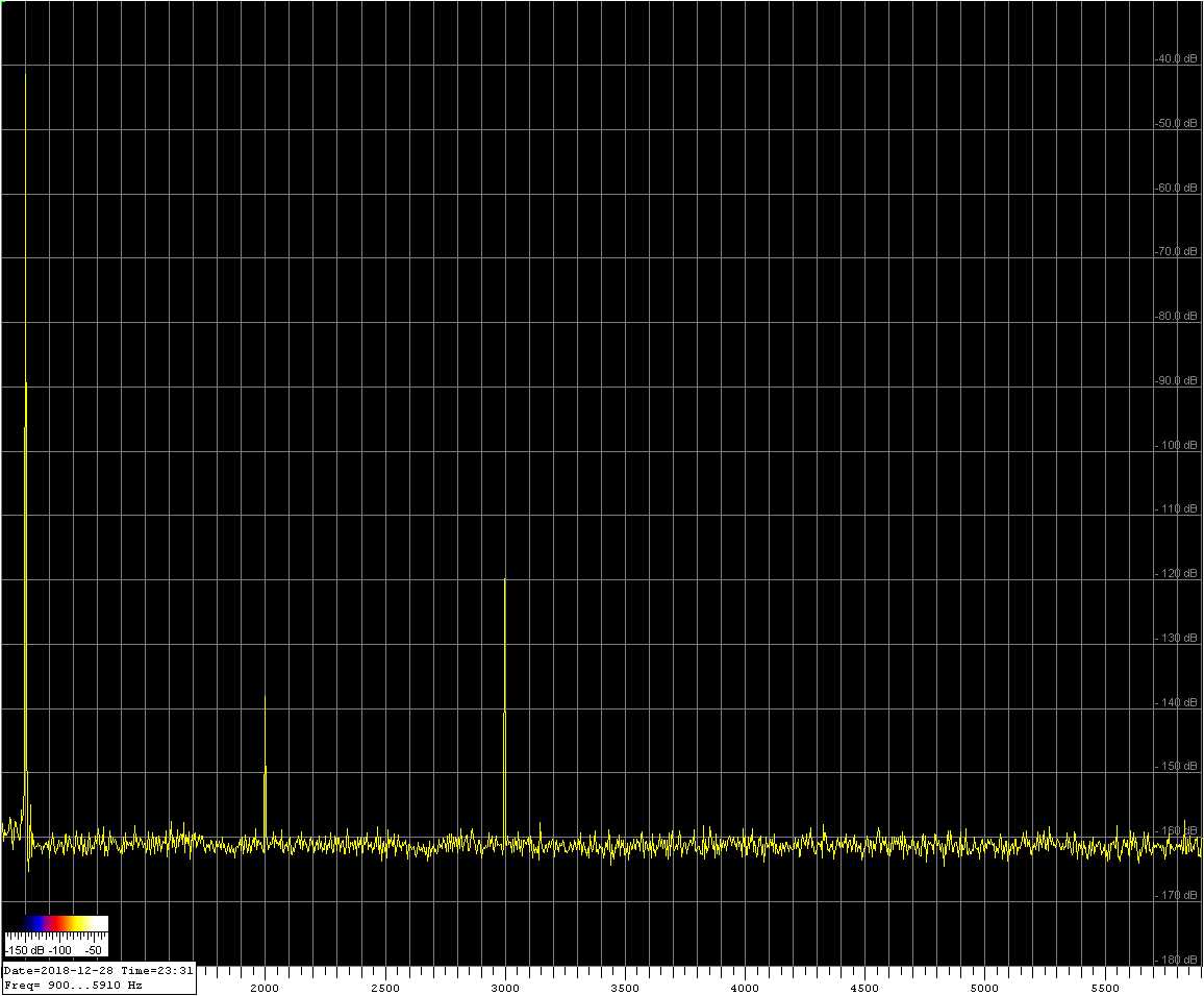

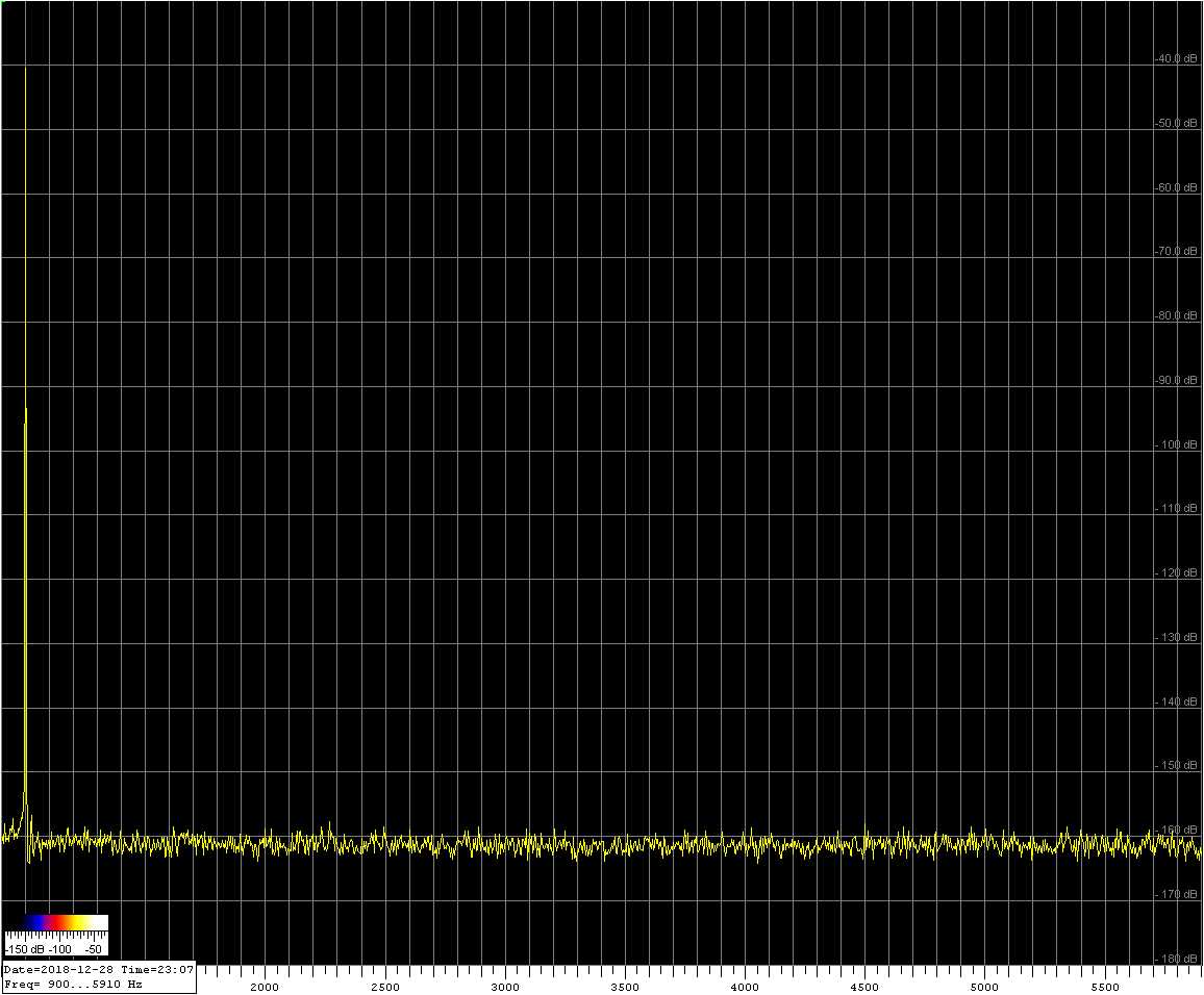

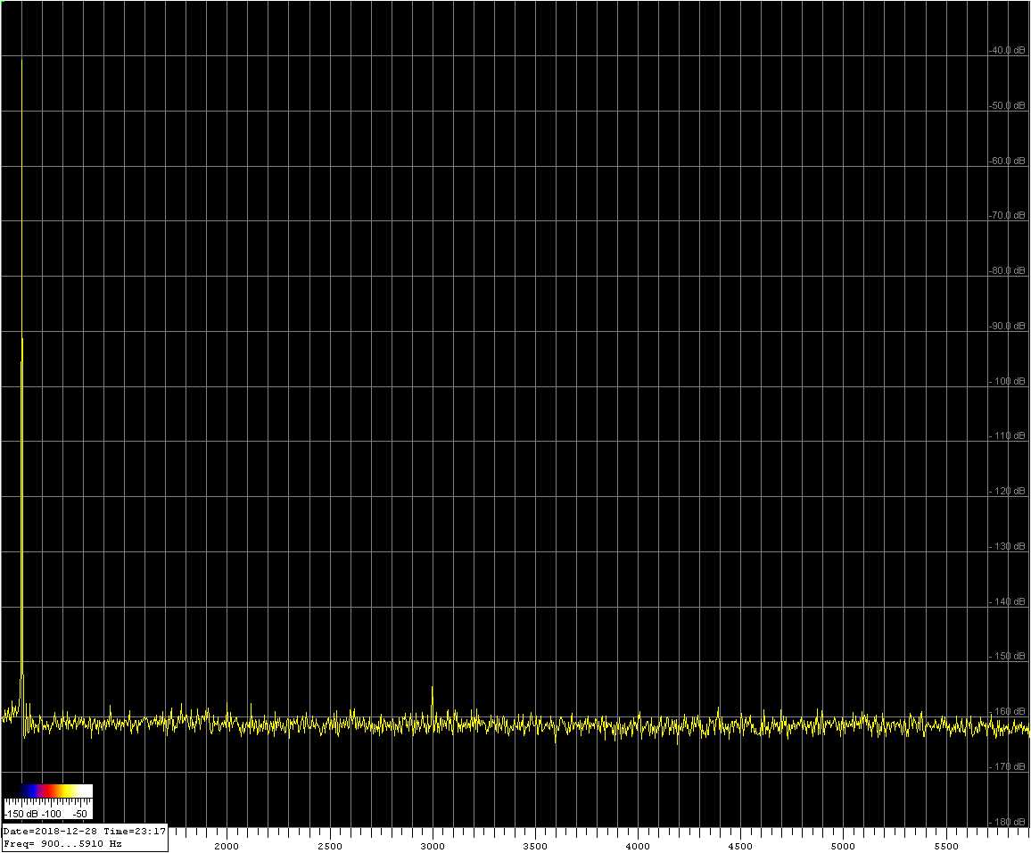

The question about resistors distortions is interesting, and I made some fresh measurements. Spectrum was measured via twin T notch. Scale adjusted at 3kHz, but 2kHz needs to add +4dB. The measurement schematic include 1kHz reference oscillator, LM4562 opamp in the inverted mode and transfer ratio near to -1 with the high grade thru hole metal film feedback resistor. The resistors under test was connected as input resistor. Voltage across the input resistor around 2,5V RMS. Value 6,8 khom.
1) reference measurement was done two times with two different case style high grade thru hole metal film resistors - no distortions visible.
2) Multicomp metal film MELF 0204
3) Susumu metal film 0805
4) 5) 6) probably Yageo thick film RC1206 - three examples from the same cutted tape
