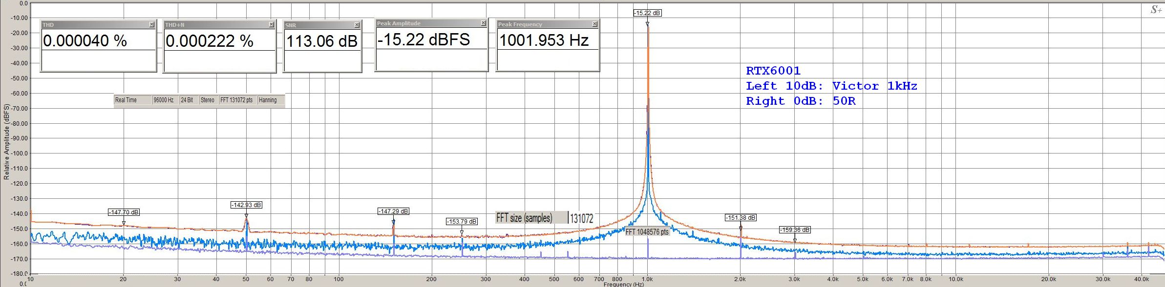

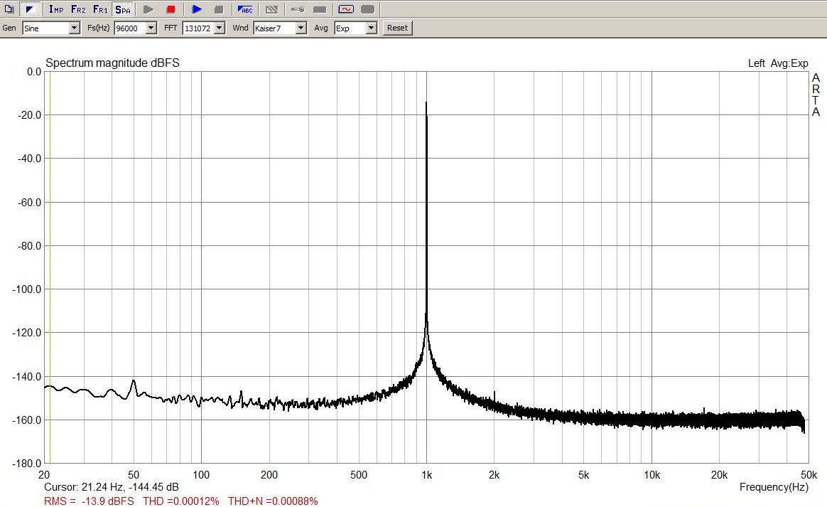

I currently compare various measurement software (Arta, AudioTester, REW, SpectraPlus, WaveForms). Your Low-distortion Audio-range Oscillator serves as a kind of reference.
Would like to share Arta and SpectraPlus curves with FFT 131072 vs 1048576.
BTW:
I didn't observe significant differences between 4x 9V batteries and an >30 years old Voltcraft lab psu feeding the Low-distortion Audio-range Oscillator.

If you are pursuing supply noise related issue or checking ultra low distortion analyzers the power line noise can be an issue. The -140 dB spur at 50 Hz is an example that should be completely ignorable except for the above cases. I have 3 oscillators from the first gen and they all work fine. I'm running them from a battery and constant current source to get more life from the 4 9V cells (they get expensive fast). The only issue I have noted is a steady downward drift in frequency. The 997 Hz oscillator is now 994 Hz. The noise floor is limited by the 600 Ohm source resistor. The internal noise is lower. and the PSRR of the opamps is enough that the '431s are not a real issue. I don't think you can just bypass them easily. You could disable them by shorting the sense terminal to ground. One of the great tricks is the floating supply which reduces the potential supply noise getting into the circuitry. The oscillators should run fine from a single 35V floating output switcher. Not that this is a great solution but this is available for $0.75 XL6009 *1Pcs DC-DC Adjustable Step-up Power Converter Module Bette r than LM2577 | eBay and I may switch so I can use rechargable LI batteries. Unfortunately its not isolated so no easy implementation. . .

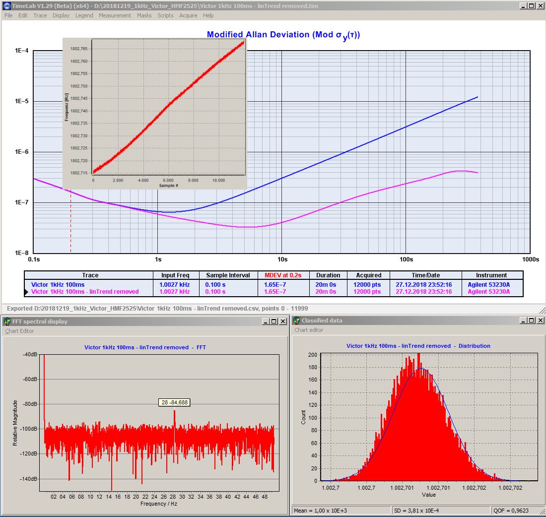

I noticed that the Low-distortion Audio-range Oscillator frequency is a bit unstable: in SpectraPlus the marker can be set manually - they have to be aligned after about 15-30 min.
Measurement done with 53230A confirms that observation (see attached image).
  • TimeLab used to collect data
    - collected data do have a linear trend (blue curve)
    - trend removed gives the remaining instabilty (purple curve)
  • Plotter used for further investigation
    - sample distribution is quite good - more or less just gaussian noise
    - FFT does show a peak @ 28 Hz - no idea what it comes from.
No clue yet how stable such type of oscillator can be made...
Ulli
RC oscillators can be quite stable, even tuneable ones, but a lot of care is needed to use stable parts, preferably ones that have aged some and to match and balance the thermal properties so they can cancel. I have seen the startup shift as well but on mine the frequency increases, starting at 991 Hz and slowly increasing to 994 Hz. I think it thermal aspects of the R/C that sets the frequency. It has not been a big issue but it is an issue for large FFT's since the harmonics change during the measurements and sometimes just go away as it drifts from bin to bin.
Ulli
Hi Ulli,
Nice measurements.
Of course the RC oscillator is sensitive to the temperature drifts. The Wima FKP2 capacitors have 200ppm/C. If the highest frequency stability is needed from this oscillator, then the board must be placed in a closed box, needs to wait app. 20 min. after start up for warm up and the room temperature also must be stable without the non stable air flux.
Regarding the short term frequency drifts. The oscillator runs on the "thin line". Every noise variations can affect. Practically all the LME49720/LM4562 opamps have the small "popcorn" noise components. Also the AGC system has different reaction depending of the adjusted output level, because the adjustment runs via AGC for to get lower distortions. The AGC is more stable in higher output level positions and becomes more inertial and unstable when the output is low. Mechanical vibrations also can affect the board and an the EMI of course.
