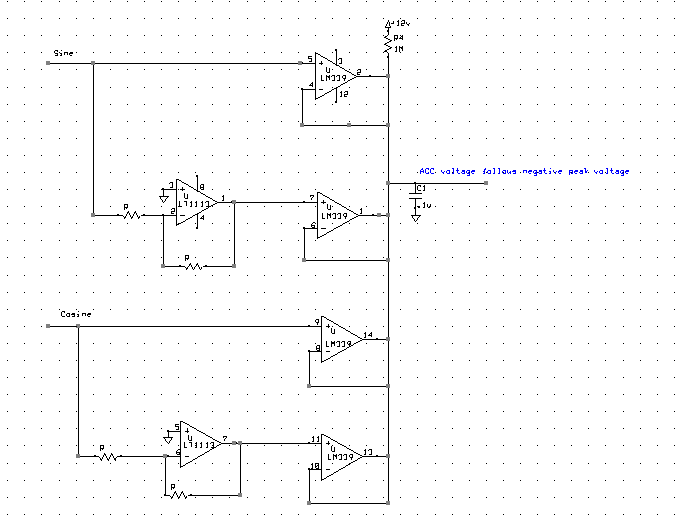

I'm not sure how to get a 45 degree phase from an SVO or maybe I'm overlooking something. Here is the low parts count 4 phase solution I used. It takes advantage of the open collector LM339 which will behave as an amplifier with pull down but no pull up. No diodes or diode drops to deal with. Trimming to get 4 peaks at exactly the same level would be an issue. Speed up tricks etc. to be added. Still not as good as a sample and hold-track and hold but fewer parts and no fast edges.
I haven't seen the LM339 used as a rectifier element before. Did you see this in an app note somewhere. It is a clever, low-parts-count idea.
What about the speed/delay of the LM339? For each one, when the signal at its input goes below the stored output level, the comparator turns on and drags the output level down until the output level is as low as the negative peak of the input signal. However, in a quiescent state, when the oscillator has stabilized and needed corrections are very small, the amount of charge that needs to be removed from the storage capacitor is very small - simply the amount of charge that the pull-up resistor put into the capacitor since the last correction (in the case here, 1/4 cycle). Moreover, the 339 open-collector output turns on hard, so a lot of current can flow over this very short turn-on interval.
This leads me to wonder how small a very narrow pulse can be made by the LM339 at its output so as not to cause, at minimum, errors in the rectified value. This would also seem to be more of an issue at higher frequencies, like 20kHz or even 200kHz.
Here are some LM339-base comparator peak detectors I've used dating back to the 1970s at Micmix. They make very good peak detectors but not so good absolute value circuits. I would not want the high-speed edges in an ultra pure oscillator.

Internally the LM339 is part of an opamp. You can actually trick it into working as a crude opamp with a pullup resistor. None of the internals are logic and they don't seem to saturate which is important for a comparator. Its quite similar to a rectifier with feedback. Since its running in the linear mode when charging the cap its plenty fast.
Here are the more conventional ways to get there: http://ww1.microchip.com/downloads/en/AppNotes/01353A.pdf
As you can see above its not a new idea. I don't think any of the genuinely fast comparators would work for this. They all have internal logic and no linear path from input to output unlike the LM339.
The LM339 also has an identical dual the LM393.
They make very fast peak detectors particularly when buffered by external transistors. You can make an OK absolute value out of them by using a small output C and/or current source. As detectors they have low offset and good low-level linearity.

I don't get this logic. While its true that a FWR injects second harmonic, it also injects much higher harmonics as well. A half-wave rectifier injects everything from fundamental on up. The higher harmonic frequencies injected by a given rectifier will receive more attenuation by the control loop filter than the lower harmonics, for a given amount of loop stability and settling quality.
A FWR has p-p ripple equal to the peak value of the signal. A 4-phase rectifier has p-p ripple only on the order of 30% of the peak value of the signal, and its lowest ripple frequency (in the ideal case) is 4X the fundamental, as compared to 2X the fundamental in a FWR. This means that in a first-order control loop filter, its harmonics will see 6dB more attenuation than those from a FWR.
