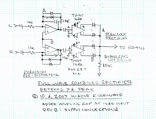

...Here is the low parts count 4 phase solution I used. It takes advantage of the open collector LM339 which will behave as an amplifier with pull down but no pull up. No diodes or diode drops to deal with. Trimming to get 4 peaks at exactly the same level would be an issue. Speed up tricks etc. to be added. Still not as good as a sample and hold-track and hold but fewer parts and no fast edges.
This is a "4-phase" absolute value detector I did to emulate the SSL Bus Compressor "greater of four" peak detector.
The first version I tried used a diode pre-distorter driving 2X THAT1646s to provide anti-polarity outputs feeding un-biased diodes. The pre-distorter overcomes diode Vf. I chose the 1646 because it has precision internal resistors to provide signal inversion and has high-current outputs. The circuit picks the greatest of four peaks in L and R which in the case of an oscillator could be the sin and cosine inputs.
Greater of Four Absolute Value Detector Using A Diode Pre-Distorter.

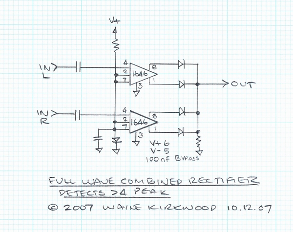

I found a later version which pre-biases the rectifier using the THAT1646 Sense inputs. The sense inputs provide a "common mode" output voltage to bias the rectifier diodes. The THAT1646 differential input is fed with signal. This pre-bias is similar to Bob's approach with diodes substituted for the transistors. Unlike the first example this one is "class-A" with no op amps running open loop. I tested the first one. I flat-out don't remember if I tested this example. YMMV.
Greater of Four Absolute Value Detector Using Diode Pre-Bias.

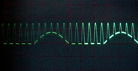

I pulled out diodes to make it half-wave so it could be visualized. One channel has a higher level at high frequency; the other channel about -6dB and lower frequency. (So I know that I built one of these LOL.) The in-phase and quadrature signals in an oscillator would be identical level so this doesn't illustrate how it would look as a 4-phase rectifier.
"Greater of two" peak detector.
The 1646 makes things considerably simpler. You could certainly do the same thing with op amps and precision resistors.
The 1646 output offset with OutSmarts turned off is typically around 5 mV. In an oscillator or compressor/limiter application low-level performance isn't a great concern. The symmetry should be quite good.

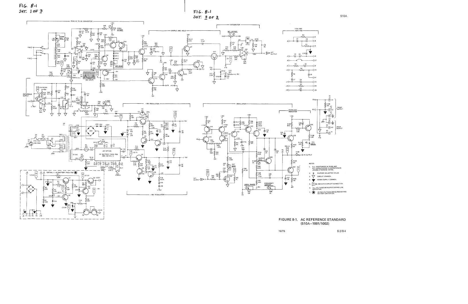

The offset and diode thermals are only important where absolute AC accuracy is important. Getting that right brings a lot more circuitry to the task. The Fluke 510 below has more circuitry devoted to level sensing than to oscillation. I did some tweaks and got the distortions down to the -120 dB level for the harmonics on this.
True. The Fluke looks to sample the peak of the log of the absolute value of Ein.
As to offset from Vf, Smith didn't even deal with that connecting the rectifier diodes directly to the outputs through 100KΩ resistors. Since the rectifier should be buffered for isolation it's not a bad idea to pre-bias them since it only takes a diode and resistor and it improves linearity below a few volts or so.

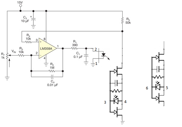

Or you could use a PV cell driving a JFET.

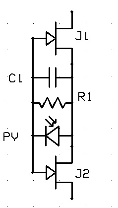

Anyone ever try this? J1 and J2 form a FET with center tapped channel eliminating the need for the resistors to split the drain source voltage. The drive is totally galvanically isolated too. The two FET's and R1 just a short, no PV is used as a nice bi-directional current limiter on amplifier inputs. It looks like a 50-100 Ohm resistor for a FET like an SK170 but limits current to Idss even with no power applied, aerospace loved it.
I think it would make a nice non-clipping fuzz pedal too.
Neat! One could also use a dual monolithic LSK389, since both JFETs can be of the same sex.
Bob
How linear are the series jfets? Would that obviate the feedback usually needed?
Sent from my LG-H811 using Tapatalk
If matched excellent. Note - since the FET's are forced to operate at the same current there might be a self compensating feature and the match of the beta (transconductance) parameter might prevail. This would be good and I never did any measurements, easy enough.
