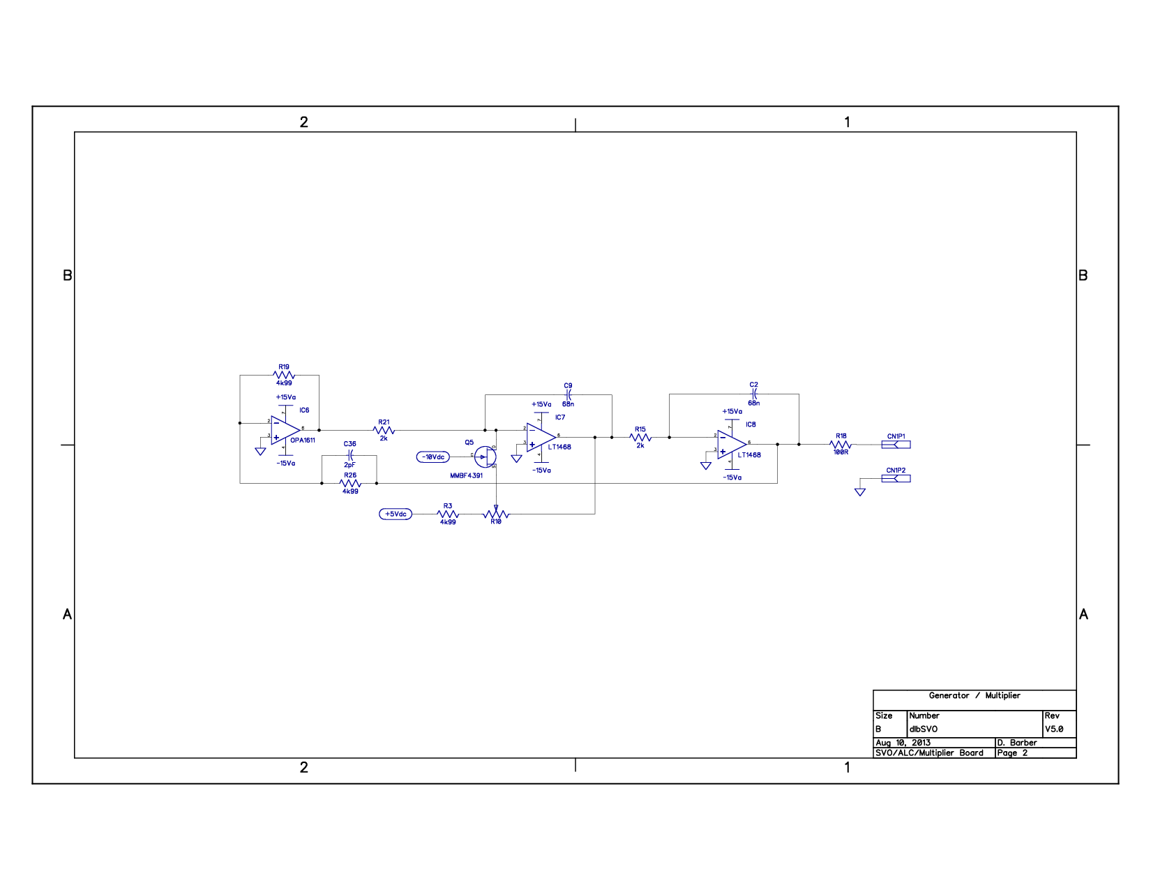

Helper circuits can be used to keep the oscillator under control during large excursion from
mode changes.
The schematic below illustrates a simple circuit the adds damping to the oscillator on negative signal swing. The pot R10 at Q5 adjusts the threshold at which the Jfet begins to turn on.
This allowed the multiplier authority to be greatly reduced by increasing the amount of decoupling between the multiplier and oscillator. The decoupling was increase by 20dB for a total of -30dB decoupling. This lowered the noise and distortion contribution of the multiplier significantly.
This is one example of secondary control.

...modified to use a THAT2180 VCA in a subtractive gain control mode. This keeps the VCA in deep attenuation approximately -45 dB.
Is there any benefit to make it subtractive?
My first impression is that it's essentially equivalent to have the main loop trimmed to within a fraction of a dB of oscillation and have the gain control element decoupled by a certain number of dB, whether the gain control is added or subtracted.
The ability to eliminate an I to V step is nice in your specific implementation, of course, but I mean more broadly.
The VCA's current output allows it to drop into the existing circuits with the least parts. The added bonus is one less op amp and two less noise contributors. If the THAT2180 VCA core were non-inverting I would have done it the same way and the result would be additive.

...I would have done it the same way and the result would be additive.
I read your comment
"...to use a THAT2180 VCA in a subtractive gain control mode. This keeps the VCA in deep attenuation approximately -45 dB."
to imply that the subtractive mode was responsible for the deep attenuation.
I have a half formed idea that the gain control would be best if it was four quadrant, able to add or subtract.
If the gain control path can only subtract, say, then the direct path must be sure to be excessive, so there is a tolerance limit to how close we can trim it and thus how much we can decouple the gain control element.
If the gain control path is able to handle either polarity then I can trim the direct path to be arbitrarily close, so that the gain control element ideally makes no contribution at all.
Was that understandable?
Currently I am inclined to use a FET as a control element on the basis of simplicity, cost and low current drain.
So some kind of Wheatstone B. may be a way to implement this.
Best wishes
David

I read your comment
I can see how you might think that.
What I meant was opposed to it being inline and neither additive or subtractive. The VCA inline (in series) as opposed to operating in parallel with a resistor would have very sensitive control at 6 mV/dB and would be drifty.
Session timed out...
I don't think so based on having built one.
Janasek discusses the narrow lock-in range of the Vactrol version.
The Janasek loop built with a VCA has a huge lock-in range.
By trimming the inverter feedback (1kΩ on my drawing) you can make the VCA operate over a wide attenuation Q-point (around -20 to -60 dB). Though it is subtractive it can add by using less subtraction.
The trim allows the VCA Q-point to be moved for experimentation. In practice it has little effect on THD or lock-in range. (Within reasonable limits I experimented with -30 to -60 and split the difference at -46dB.) The control loop seeks oscillator unity gain with the output level set by the reference current.
There are not large changes in VCA Ec during stable operation.
If the VCA is set for a -46 dB Q-point you will not see it deviate from that unless its recovering from a power-up state.
Varying the reference current allows the oscillator output to vary from a few hundred millivolts to 20V P-P. The VCA attenuation Q-point stays nailed at its set-point as the reference current and output is varied over a wide range.
I see no evidence to suggest that the VCA control range is insufficient even when decoupled by 50 dB or more.
Most importantly adjustment is not touchy and repeatable.

I just checked it with a VCA Q-point of approximately -46 dB attenuation.
The oscillator can start-up from about 300 mV to 25 V P-P. Unless it's recovering from power-up or the reference current is changed and the AGC loop is adapting, the VCA Ec+ line is pinned at -280 mV.
Realistically I don't think there's an issue with control range in a fixed-frequency circuit. We're using the VCA like it was a variable resistor in parallel with a fixed resistor (notwithstanding that its subtracting) and that's no different than a Vactrol except that the VCA has a wider lock range owing to its bigger "delta-R."

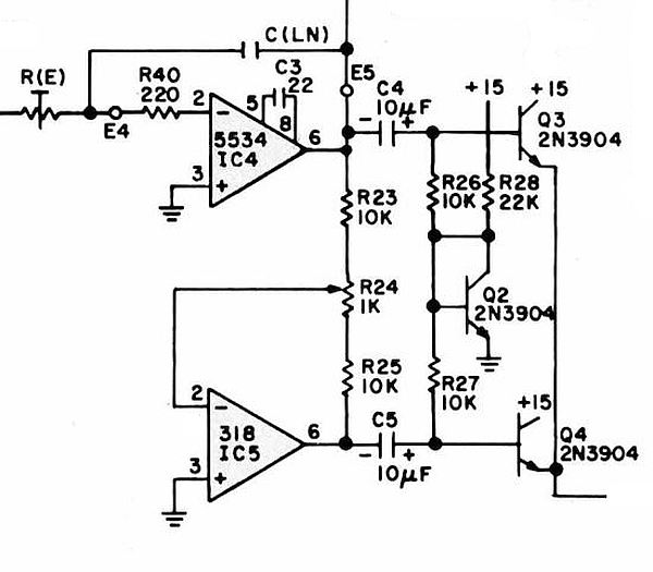

I'm going to incorporate Bob's detector next. No op amps run open loop. The hook may or may not matter but I don't like seeing fast edges in a oscillator requiring "parts per billion" THD.
Cordell Absolute Value
IC4 is part of the SV filter and its' feedback loop is closed off-page.
This circuit should not generate any fast rise-time abnormalities, is elegantly simple and has adjustable symmetry.
