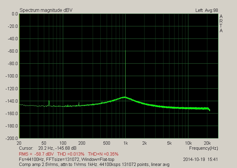

Here are some measurements for an OPA1611 in composite with TPA6120.
This is based on a design that JCX put forth a few months ago.
The first is the generator on it own. Gen output is 2.5Vrms @ 1kHz.
The signal is attenuated to 1Vrms before measurement.
ARTA set to 44.1ksps 131072 data points, linear averaging. Flattop window.

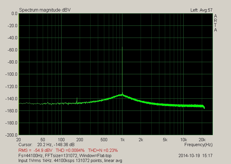

The second is the comp amp set to unity, non inverting input.
Input 2.5Vrms attenuated to 1Vrms. All else the same.

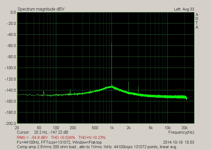

The third is the comp amp with a 200 ohm load added.

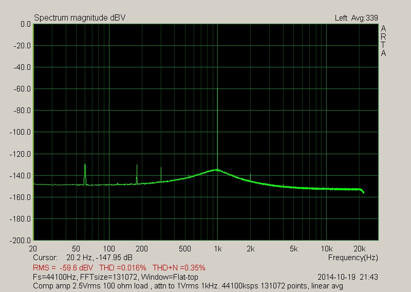

With a bit work this after noon I now have this.
Better but has a ways to go.
First thing was removing the ferrite chip I put at the output. I thought this would improve decoupling but it was at a cost 1.5 orders of magnitude of distortion.
I changed the rest of the bypass caps from grounded to rail to rail The load has increased to 100 ohms. All else is the same.
Here is the result.

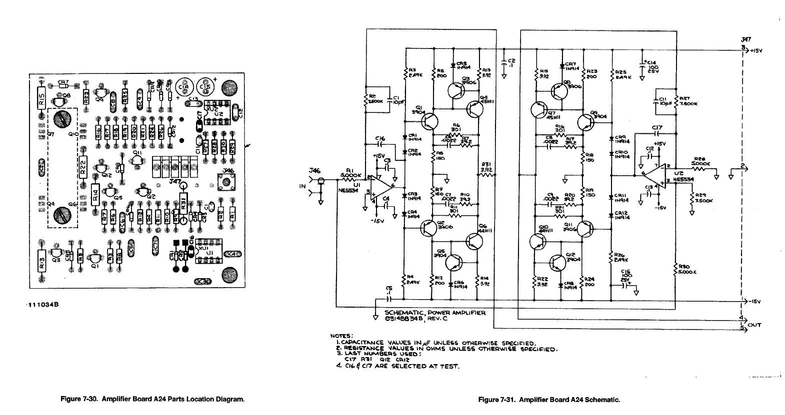

My Boonton 1121 will deliver 16V RMS open circuit and 8V into a 50 Ohm load and it has been very useful. Measuring frequency response with a 600 Ohm source will show the effect of the cable with even no load, its more than you would think. Also I have seen the distortion change with source impedance so its very valid to start low. Adding series impedance is not hard.
Handling the power dissipation is not trivial. The Boonton's output is bolted to a big heat sink. Also the series resistors for the output need to handle the peak power without generating distortion. I attached the output circuit for reference.

Looking at the circuit will show that the output amp is a current feedback design like the TI chip.
