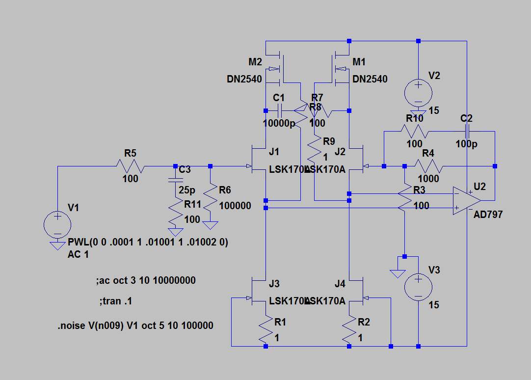

Do you remember whether it was 2nd or 3rd that was too high, or both? The non-inverting buffer is a very difficult problem at -120 and below. I'm dealing with those issues on the Boonton. The differential input is fine on the X1 range, but X10 causes a significant increase in 3rd harmonic. My guess is the source impedance of the divider and the input cap modulation of the opamp are causing the problem. In the Shibasoku they went to extremes to cascode jfets as followers into the bipolar input diff pair. I think this is what it will take to make that buffer work below -120 db harmonics. i don't think this will be easy in an opamp. I have sketched out a discrete/opamp combo for this but it felt like an extreme effort. Below and attached. It felt odd to use so many discrete parts with an opamp.

You can use the DN2530 instead of the 2540 if you want a smaller parts package. I thought the problem was driving something on the output of the opamp, not buffering the input. I would replace J3 and J4 with calibrated current limiting diodes, which will save some effort. You also may be pleased to know that Linear Systems has introduced the P channel complement to the LSK170.
http://www.linearsystems.com/products_details.php?pr=jfet-amplifiers--singles&pro_id=69

I tried several op amps. The one that worked best was the LME49990. Without loading the this op amp buffer combo was transparent. it was both 2nd and 3rd but the 2nd was dominate. Nothing above that harmonic order. But I see this every thing I try.
It was about the same inverted mode and common mode..
I measured a strong second harmonic in the low mV's across the rails under loaded conditions. I think this is getting back into the amplifier. My power supply and leads are giving some 0.06 ohm Z. Not good. Maybe better regulation is required.
At those levels, 2nd higher than 3rd in bipolar circuits is usually due to magnetic effects, so layout, layout, layout... I can't even imagine somebody attempting to breadboard such a circuit.
It all pointing to magnetic effects. This is to be expected when currents become significant.

Demian with the LME49600 I had to go to rail to rail bypassing with a single 0.1u from pos pin of the op amp to ground. This cleaned the grounds up significantly and dropped the distortion a couple of orders of magnitude. I think the demo board decoupling is power pins to ground isn't it?
I still have not received the demo board for the LME49600. The bypassing you describe is straight from Bruce Hofer's playbook. I think the only other time I have heard of the trick was from Scott Wurcer on some very difficult circuit application. If you can get there with the LME49990 and LME49600 combo that would be very accessible and not expensive.
The high bias current of the LME49990 and big input transistors will make for some input modulation issues. You can get an idea of the magnitude of the issue by inserting a 1K resistor in series with the input to the LME49990. The higher impedance allows for the modulation to happen. I was thinking of making a module with the Cascoded FET input, LME49990 and LME49600 as a universal invisible amp module. It would be neat if it fit a dip footprint but the power supply demands probably make that unlikely to be successful

I get a rise in both 2nd and 3rd H inserting a 3k resistor in series with the non inverting input. However driven from 100 ohms with buffer at minimum load > 15k ohm the LME49600 in loop with an opa1611 is quite transparent. I get a rise in 2nd to 5th with a 200 ohm load.
This improved some by adding RC rail filtering to the op amp with 100 ohm on each rail and a 100uF cap rail to rail. The 0.1uF from pos rail to ground remaining. Both outputs of the osc are decoupled with a 100 ohm resistor internally.
