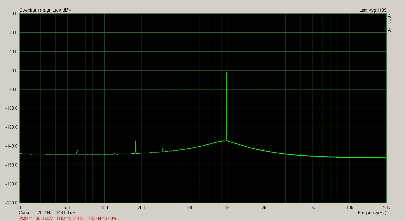

I dont know.... maybe its just a 'why not'? challenge to one's self to push the existing limits. I mean, same question could be asked about 'why <-140dB'? Why not. And, right now it is hard to measure below -140 to see where the harmonics actual are. So, if you dont try, you cant do better. I know David has put in a lot of time and effort and money to find out. And has succeeded.
A couple years ago, I asked myself if I could measure -160dB. I came close - at great time and expense - at -150dB with +/- 1dB uncertainty. But I had to cheat to get there.... I finally just bought it. But, I learned an awful lot in the attempt and so was worth it all. Mostly from the shoulders of others plus getting in there and getting my own hands dirty.

The output Z is fifty ohms. I shouldn't have said loaded to 50ohm. The lowest load is more like 84 ohms. The oscillator won't come close to -140db At 100kHz so there no need for the buffer to this. The <-140db is between 1kHz to 10kHz of individual harmonics namely 2nd and 3rd with an absence of Harmonic above this. The bandwidth should be greater than 100kHz to maintain level flatness. Demian measured the flatness at 0.02dB through the ranges so the buffer should manage this. The distortion rises above 10kHz to < -130dB at 20kHz and the up rising curve continues from there. The distortion rises below 1kHz similarly. The buffer must be very low noise so FB components well under 1k are needed and the output drive must be able to accommodate this in addition to the the output load.
Layout, power supply and decoupling appear to be the biggest challenge at the moment.
