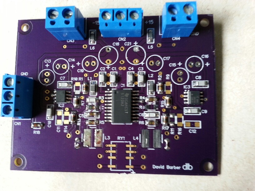

Here's what I've found. These IC solutions work great until presented with a load.
A good one will raise the 2nd and 3rd H with a moderate load. As load increase then we get a full spectrum of harmonics. When ever this is seen it the OPS breaking up. That is the only thing that can produce a full spectrum of mostly odd order. Even order junk is just noise or stress on the power supply.
I understand that's it's not possible for and IC manufacture to use class A in an IC. It's been attempted by Japan with the STK package amps but this lead to grief for them as the pack would fail, mostly from lead stress. Just can't handle the heat.

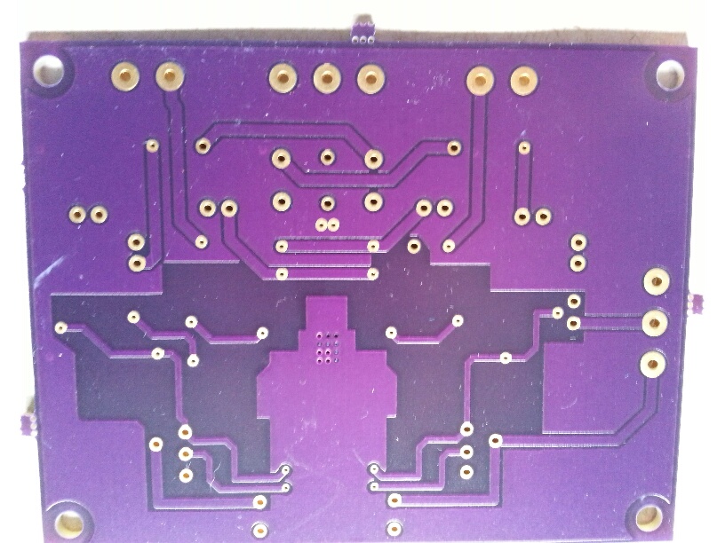

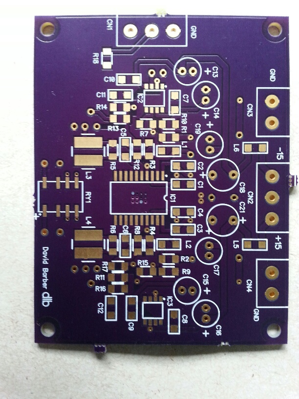

Okay fare enough.
The lay out is a copy of TI's evaluation board with the addition of OPA1611 for the comp.
The design is pretty much what you proposed a few months ago here and on your thread.
The only difference is it's running at a gain of 3 or so and in non inverting configuration.
The board is designed as an development board and can configured for either a non inverting or inverting mode.
The usual supply bypassing power pins to ground is not working. I'm finding better success with rail to rail by passing of the larger electrolytic.
I'll post some pics of the board.
Here are some pics of the board unloaded and mostly loaded.
I have the larger bypass caps removed to try an alternative rail to rail bypass.
