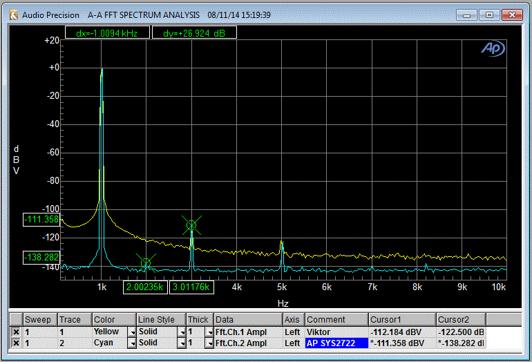

Just ran this:
How did you get cursors and readings on A-A FFT?
Right click on the graph "Show Cursors"

Just ran this:
You'll need to use the notch filter of the AP ahead of the ADC for meaningful low-distortion measurements. I've posted a screenshot of the settings, but can't find the link right now.
Samuel
Yes, I always wanted to see, if the AP2722 is able to resolve Viktors 1kHz h2.
Should be at ca. -155dBc.
Thank you, I forgot to click on graph legendRight click on the graph "Show Cursors"
Samuel
Samuel
