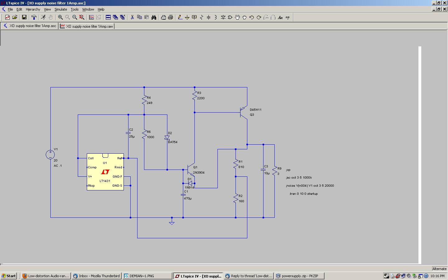

The regulator circuit I used here: http://www.diyaudio.com/forums/digi...sb-interface-audio-widget-52.html#post2810970 is for low current but a bigger pass device with current gain can handle 1A in simulations. If you have enough supply compliance a darlington pass device would work OK as well. The noise really measures as below 1nV/rtHz.

If you look at the circuit the TL431 is used as a servo with a long time constant. Its isolated from the base of the amplifying transistor by a large resistor and cap. The noise at the base is well below .1 nV/rtHz. The transistor is the dominant noise source. The TL431 steers the base voltage but slowly. The stability and accuracy of the 431 is great, especially for the price. The isolation is also good from around 10 Hz to 500 KHz.

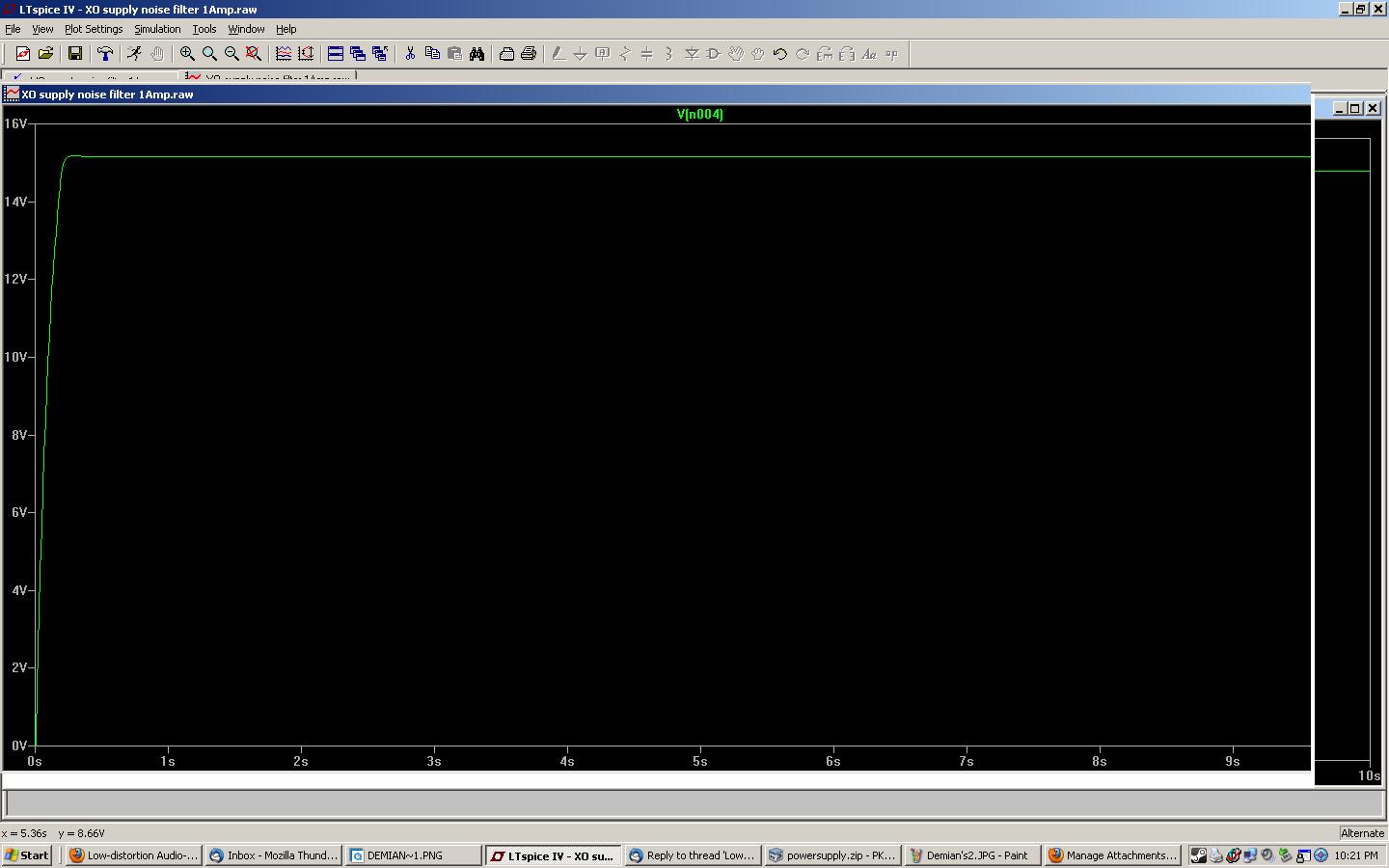

Come to think of it your regulator might be just the thing. The Jung is too sensitive to capacitive loading at high frequencies. I think the pass transistor will get taken out at power up. I've seen this before with fast emitter followers. Just got to figure out how to get larger pass transistors to work with yours. Okay back to spice.
There has been some back and forth on C3. I get fine results with a .1 uF on the assembled units but the simulations suggest a much larger cap like 100 uF is necessary.
I have attached a zip file with the LTspice model and a 1A variation I did some time ago. Playing with the value of R3 will trade output Z for lower noise (as its also the bias current on the transistor). I am currently using the circuit with the 2.2K R3 to run all of the logic of a PCI sound card with no problems.
This sim seems to run ok. Must have been my model of ZR431.

That's probably where the 100 uF cap is important. I just scaled the sim to 15V out and 18V in. Change the following values and I don't see oscillations- R4 to 1K, C2 is .1u, voltage divider is 12.5K and 2.49k for 15V out. Load is drawing 150 mA. It seems to be pretty forgiving, which is good since I'm pretty abusive of this stuff.
C2 has a huge influence on the wide band output noise. Dropped from about 3uV at 0.1u to 87nV at 100u.
