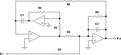

There is another filter structure you might look at called the Akerberb-Mossberg.
I don't see it much, or at all, around these corners but it may have application here.
The most interesting thing about it is the positive integrator which may or may not have any benefit.
If you Google the name a ton of stuff will come up on it.
The following is a bandpass configuration.

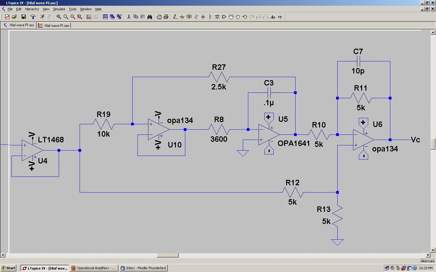

This is an analog equivalent of a pulsed integrator PI controller.
It has the same advantage of self adjusting with frequency like a pulsed integrator but doesn't produce the transients and noise from switching. No timing required. One advantage it has over a switched topology is the exact proportion the integrator changes is controlled by the ratio of R19 and R27. The integrator acts as a servo on it's input signal driving it to zero and outputting the exact amount to the summing amplifier where it's summed with the proportional error. This makes tuning the PI controller simpler because the controller is no longer sensitive to the integrator TC. It can't over shoot which can cause level hunting. The integrator TC can remain fixed and doesn't require changing with oscillator range.

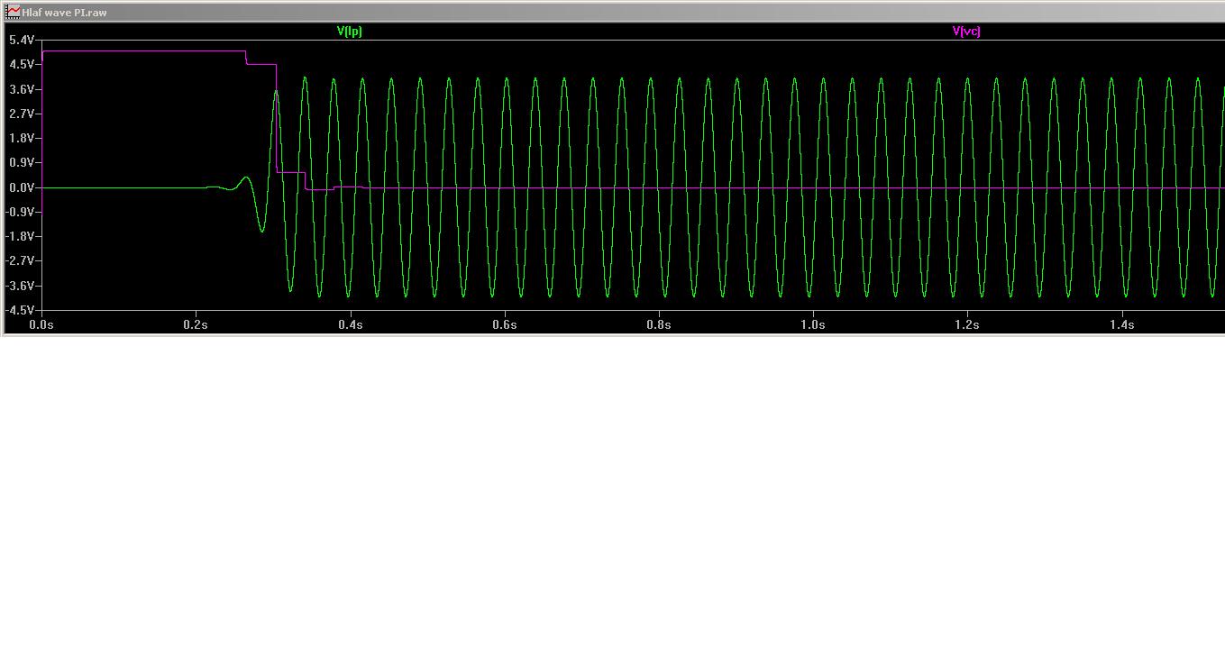

Here is the circuit and a sim of an SVO at about 25Hz. Settling can't be better.
This is a simple form. A second integrator with a shorter TC can be added to handle the servo with it's output driving the PI integrator.
This controller will work equally as well in any AGC loop regardless of rectifying method.
Beautiful application with excellent behaviour. Fast even at 25Hz. very nice idea.

Thanks Rick.
I really did not want to use a pulsed integrator because of the switching noise. At such low levels it shows up in the output of the SVO. But this left a problem of how to tune the integrator TC with frequency change. I came up with a lot more complicated ideas before this. The only reason the integrator is in there is to drive the error to zero. This is a better filter.
David, I'm afraid I don't understand how your controller works - it seems a fixed time constant, low-pass filtered, proportional controller; a gated-gain integrator is actually an integrator whose gain tracks the oscillation frequency, so that the overall ALC loop gain is proportional to oscillation frequency. How a P controller with a little low-pass filtering can replace a gated-gain integrator?

Hi coluke.
It's one of those post I wish I hadn't put up there. As it is it doesn't work because of the differentiating of the servo. This can be cured by the insertion of two reverse diodes in parallel but the lose through the diodes leaves a large error. Using a second integrator for the servo section enables a shorter TC which give shot of charge to the PI integrator.
To make this work it becomes so complex one may as well just use a pulsed integrator and put a lot of filtering on the power rails to deal with the switching noise. With careful lay out
it can be made to work.
The concept is for an analog solution to the functional equivalent of a pulsed integrator.
Something that will effectively adjust the integrator TC with frequency without getting ridiculously complicated.
At ultra ultra low distortions what I'm finding is distortion is created from AGC functional-component noise and not the oscillator itself. This includes ripple, switching noise and anything that generates harmonic within. This enters the oscillator in combination of direct injection, power rails and strongly by EMI. The best way to deal with this kind of noise is to not generate it in the first place.
