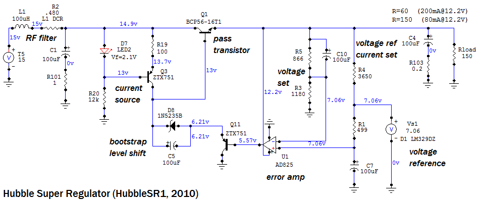

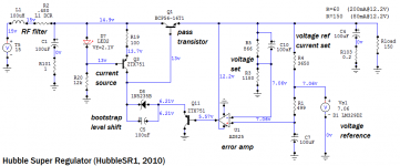

I was wondering about doing it this way when I came across this.
Well, be aware that the 334 is all-discrete circuitry with +/- 25V supplies and that just replacing the discrete amps with opamps is far harder than you think, with possible performance issues remaining in any case, as I found to my sorrow. Not saying you can't do it, just that it's no day at the beach.
If its discrete -- Discrete is not so hard for me to improve, also.
