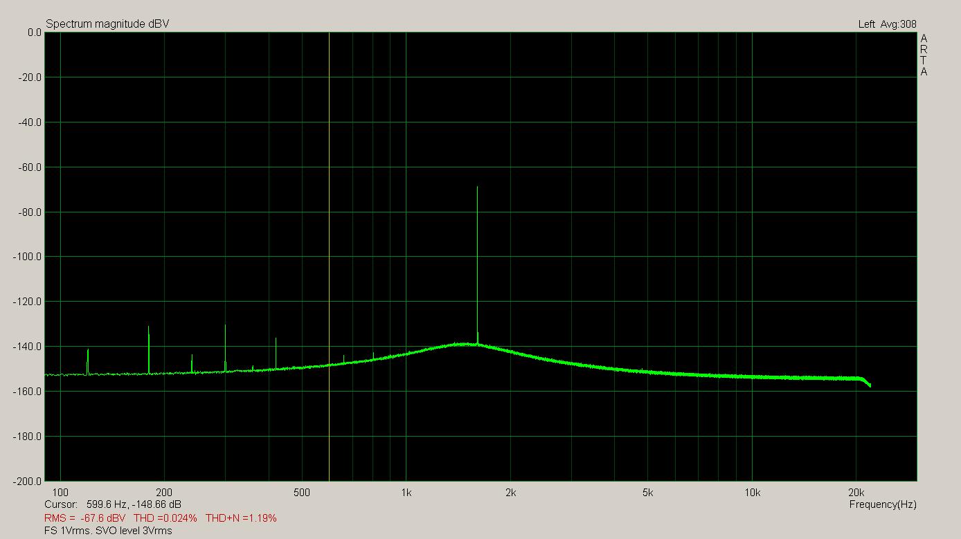

Rick you were asking for some numbers.
The SVO is running at 3Vrms. ARTA FS is 1Vrms. THD reads 0.00001%.
Noise floor is limited by the Twin T.

Hi Rick,
I not much of technical writer. But if some else wants to write it up I'll do the footwork.
To get distortion this low the output must be unloaded as much as possible. A good low distortion buffer is required. Op amps just don't have the drive current available. I know the LME's go to 600 ohm but I just don't like them.
Most SVO's I've seen run well below 3Vrms. The distortion drops in more than linear way below this threshold. I need to run it higher for now so I can see the distortion.

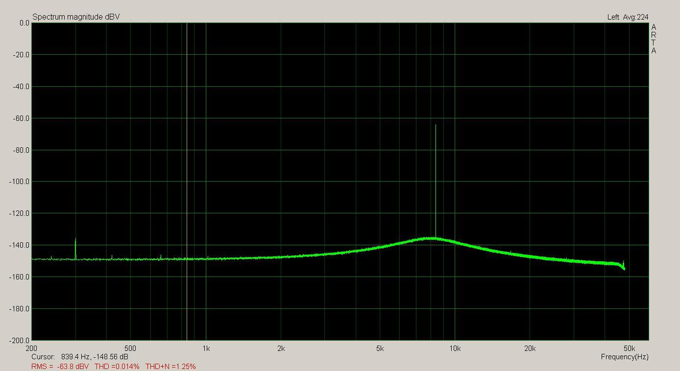

I would not worry about 600 Ohms..... a legacy relic of a bygone era. And opamp buffer will be fine for those 600 Ohms equipment. Or do as Krone-Hite does.... have an output directly off the osc and another output thru a buffer for low Z drive.
The K-H 4402B does 4 zeros and a 5 (with a few changes). Victor's is about half that. At 1KHz.
What does your design do at 10KHz?

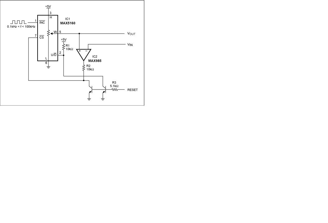

I came across this circuit a couple of years ago.
It's a droopless peak detector using a Maxum digipot and comparator.
With a little modification it could be converted to a tracking peak detector Using a window comparator and a proportional amplifier to detect a zero and control the up/dn pin
It's basically a digital integrator.
If the input signal is used to generate the clock the integration TC is adjusted with input frequency.
http://pdfserv.maximintegrated.com/en/an/AN1163.pdf

You can't do a proper transmission line with low Z. Your load would have to as low as the source Z. Direct from the output of an op the load would be so low there wouldn't be any signal at the end of the line. But we are spitting hairs here. Yes 600 ohms is a relic. It could have just as easily been 50 ohms. The 600 goes back to tube days. But there is no standard to replace it.
You asked for 10kHz. This is close.
