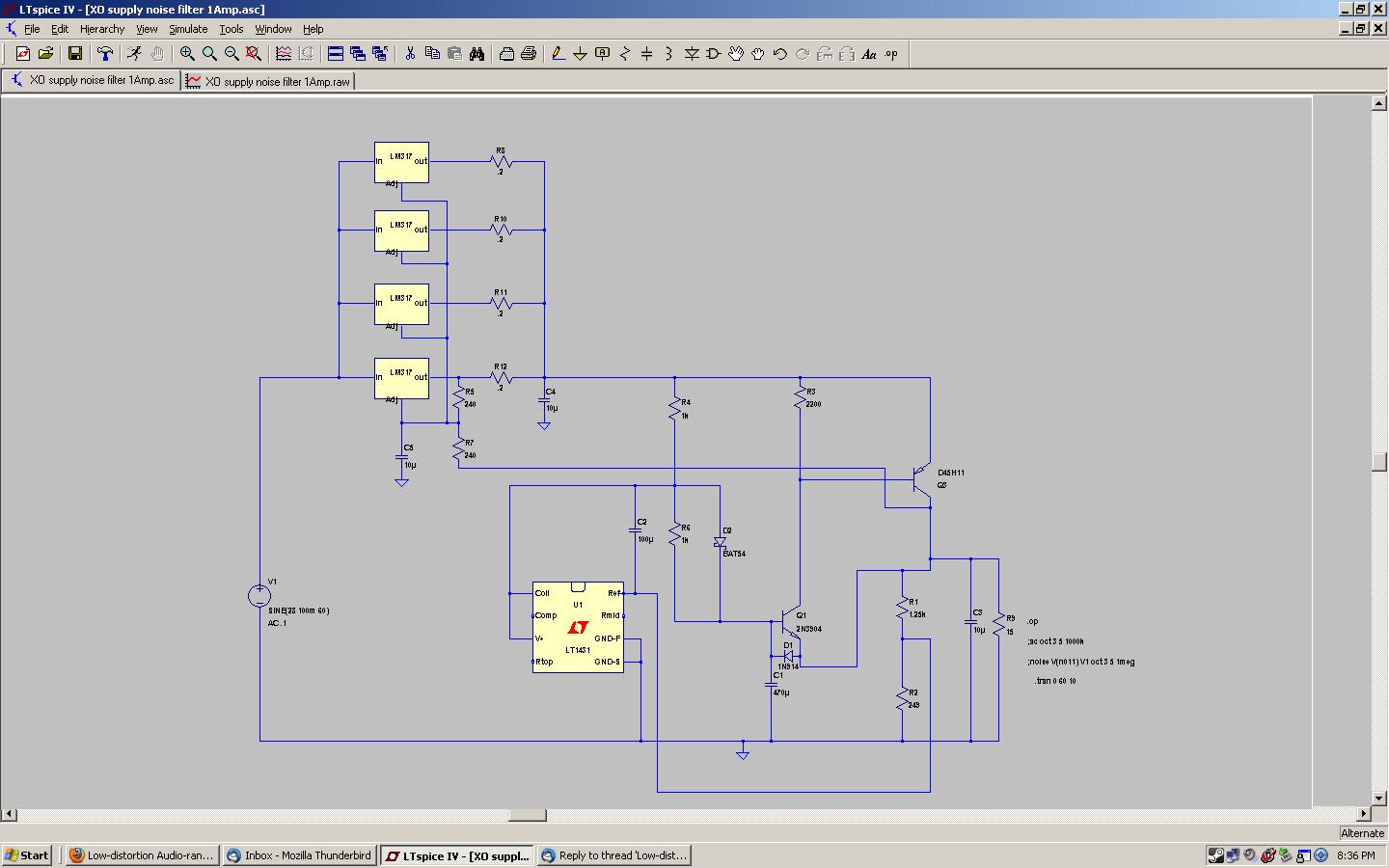

Measured or sim? Measuring noise that low is not easy. I also think the model for the TL431 doesn't reflect how it operates in this configuration.
I'll set up one of the production units and measure it.
Simmed of course. I'm not that fast at putting circuits together. What is it in reality?
I added a bit to it. I can't get a spectrum from it 10 seconds after settling.
The four LM317 are because of a current limit in the model.

I have measured it. I had to build a transformer input "pre-preamp" to be able to measure something. It was in the 1 nV/rtHz range but I'll redo the measurement and document it.

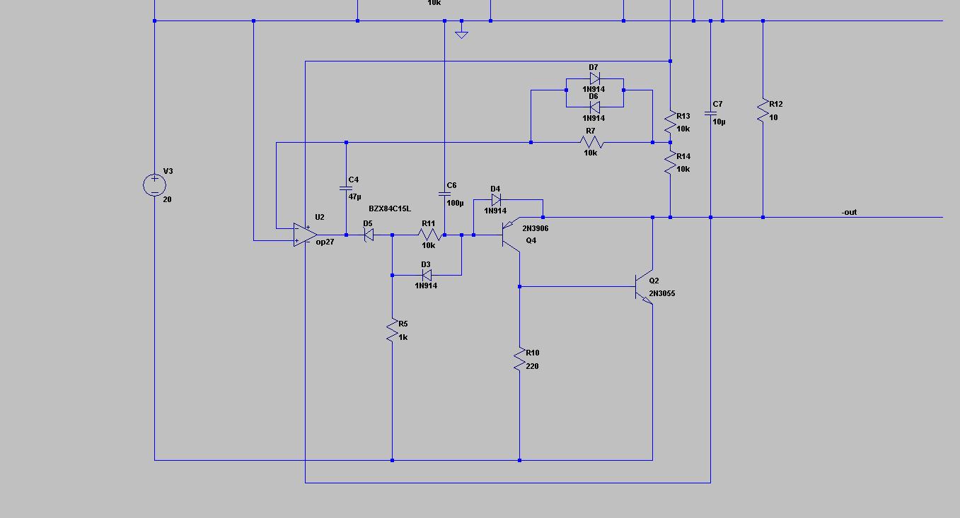

Let me sketch a negative variation. I also did a shunt variant but have not built it. Do you need tracking? I think that would be important in some applications.
May as well add the tracking. I plan to put the power supply in it own enclosure.
I want to keep that transformer as far away from the oscillator as possible.
Also see what the influence on noise of C2 is. It not costing much to make it a high value.
In sim the settling is a few hundred uV so who cares.

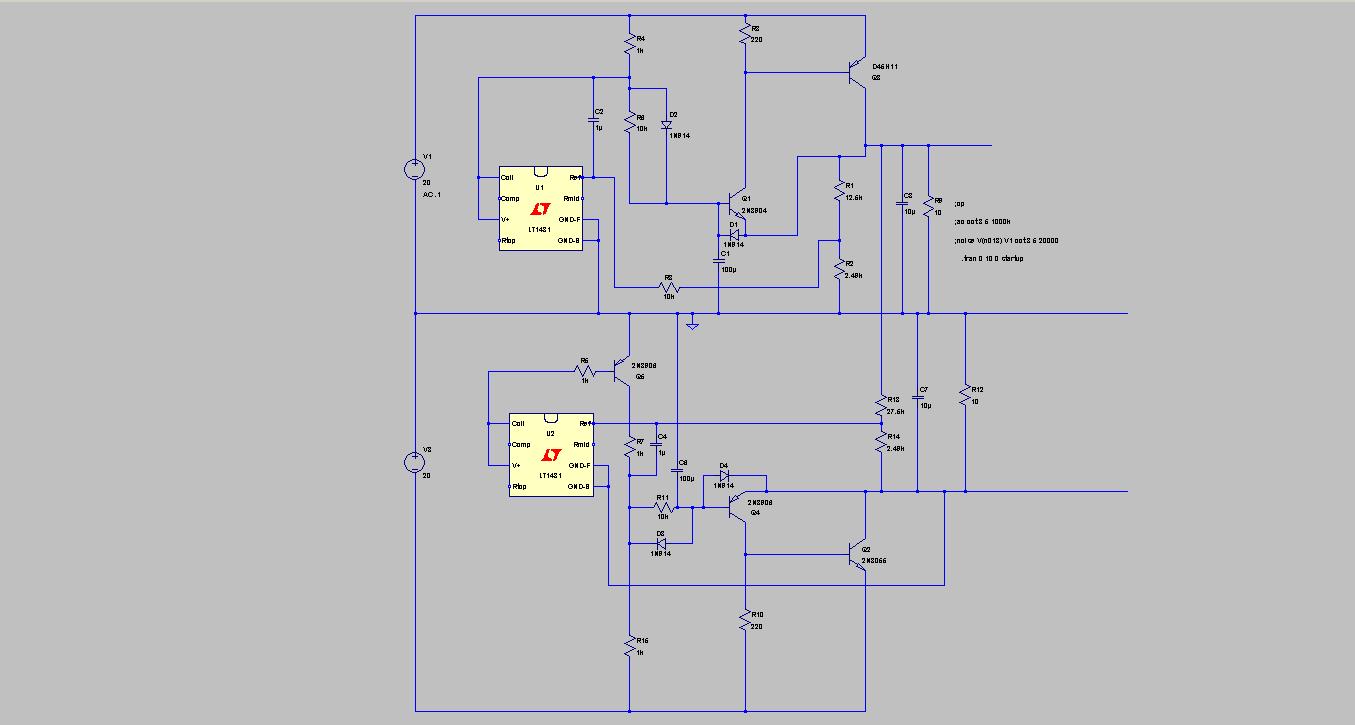

Split Supply

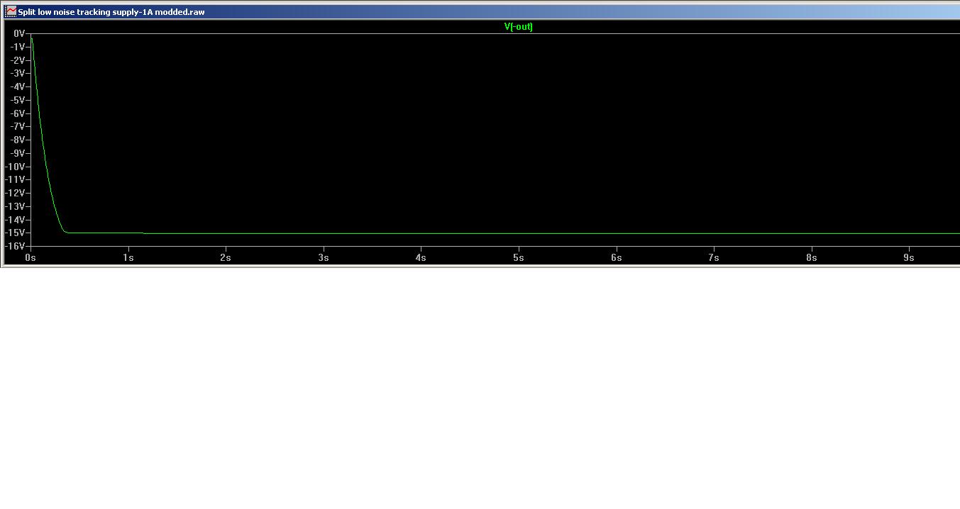

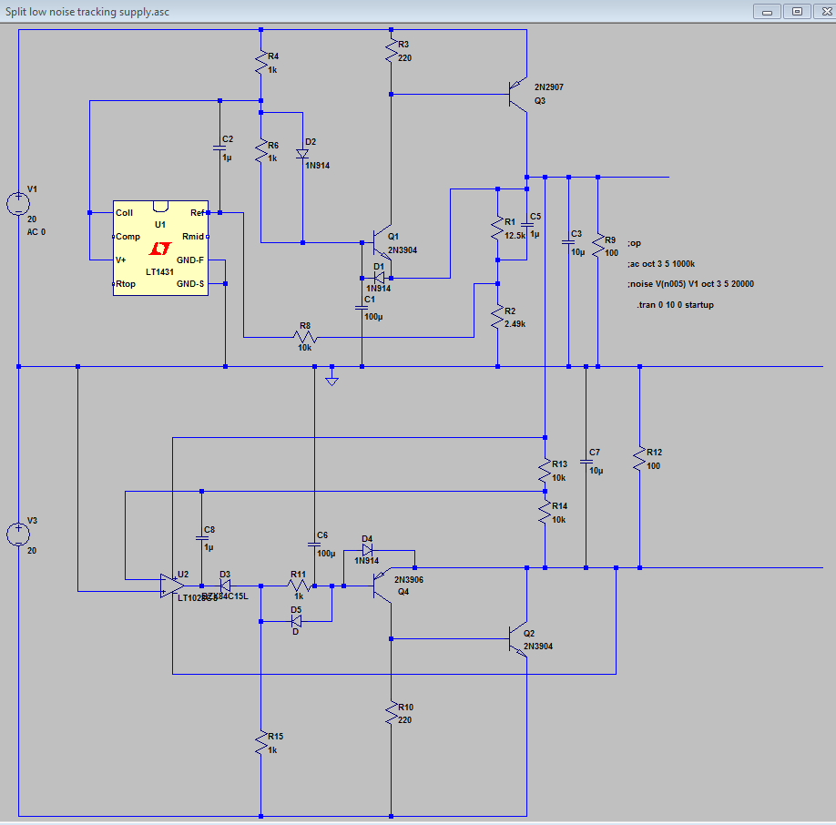

Here is a first pass at it. Making the cap on the TL431 larger really slows down the startup. I did some tweaking but still room for more. The opamp can be pretty much any generic if the tracking doesn't need to be perfect.
I will "noodle" on an alternative solution that may work better. can you run the unbalanced loads from a different supply (Relays, ADC/DAC etc)? That will allow for almost zero ground current.
The unbalance load is not quite so unbalanced. There is a strong negative current, almost equal on the one of the -7V legs which should balance thing up. The shunts can be adjusted
to make up the difference. I don't care if a bit of current gets pissed away doing this.

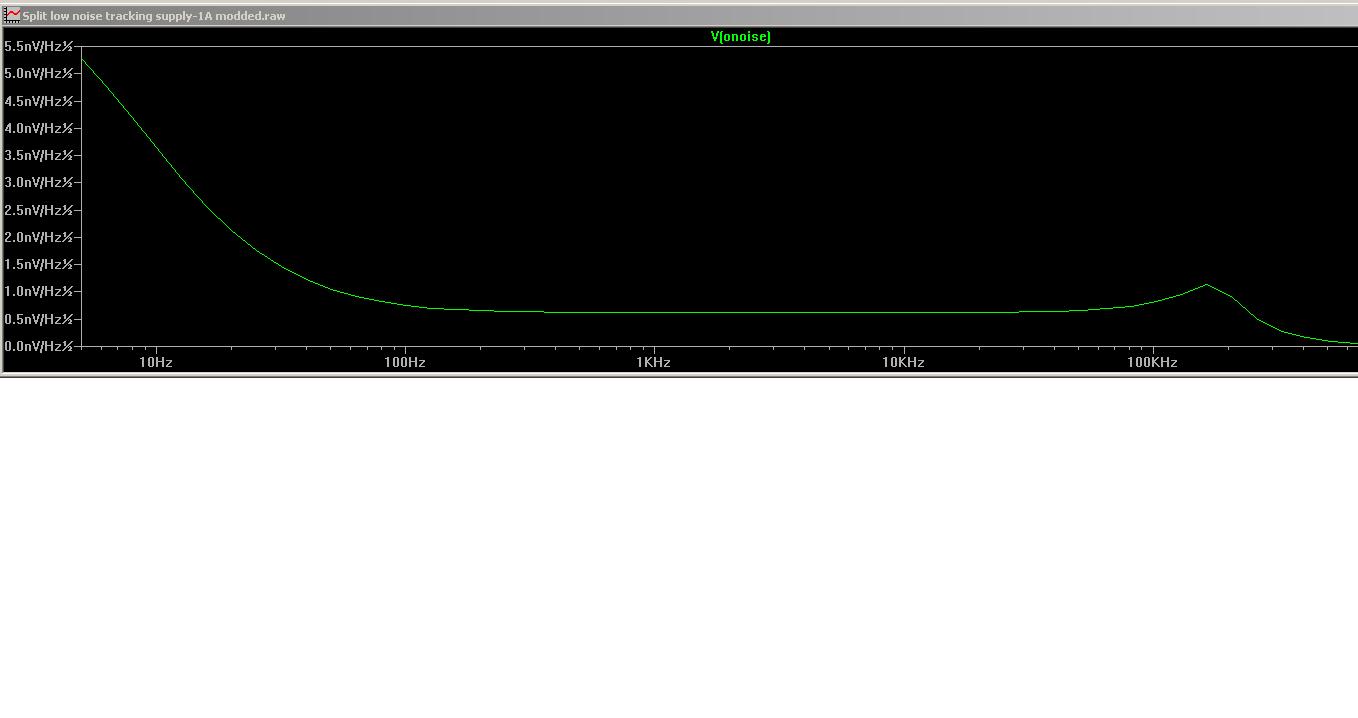

I like the addition of the 10k to reference and smaller C2. It's here the noise gets amplified.
It also reduces a parallel path for noise. Remove the cap across R1 and change the cap on the TL431 to 1 uF. In the simulation the turn on transient is much better behaved.
I substituted some larger transistors and increased the load current here. I think it needs more analysis before going live. I can add current limiting with some simple parts I think.
If the unbalanced currents are small I think an active center tap and a floating supply will be lower noise from external stuff and easier to make work well.
Don't worry about current limiting. I'm going to pre regulate with 317/337 connected in a tracking manner as in the sim posted. The 317 keeps the voltage across the pass transistor constant at just few volts above. This lowers the dissipation in the pass transistor and dumps current into the output. In sim I input a 5Vpp ripple and the two regulators in tandem removed it completely.
The 317/337 provide current limiting as well as thermal shutdown without raising the noise. So no need for this.
Together they provide better line regulation.
It needs some work on the negative side noise profile.
Too many active parts. That extra transistor could cost $0.10.
Actually tis not bad but the lower TL431 needs a resistor to ground from its V+ to work properly I think. And the balance will be questionable on startup, because of the bias/reference requirements of the TL431.

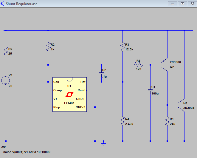

Here is a shunt regulator based on the same core-
"Too many active parts. That extra transistor could cost $0.10."
LOL.
But your are right it is to noisy. Too much fuss.
You're also right about the resistor to ground. Somehow it disappeared between edits and copying the screen.
I've seen your shunt version before.
