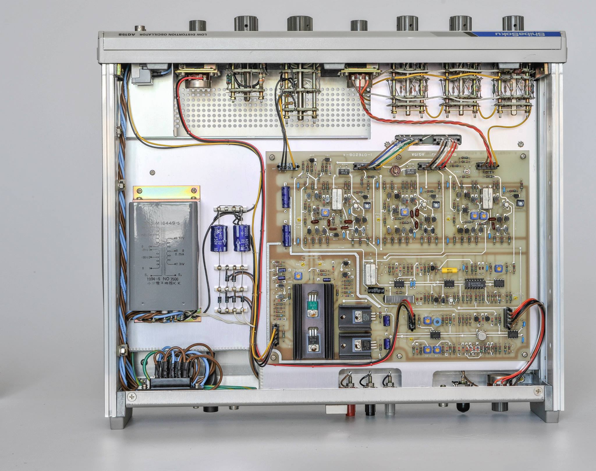

Can you take the lid off and tell us what's inside?

The Shiba Soku A15B
The Shiba Soku is in the house..
Best regards..
Thomas
