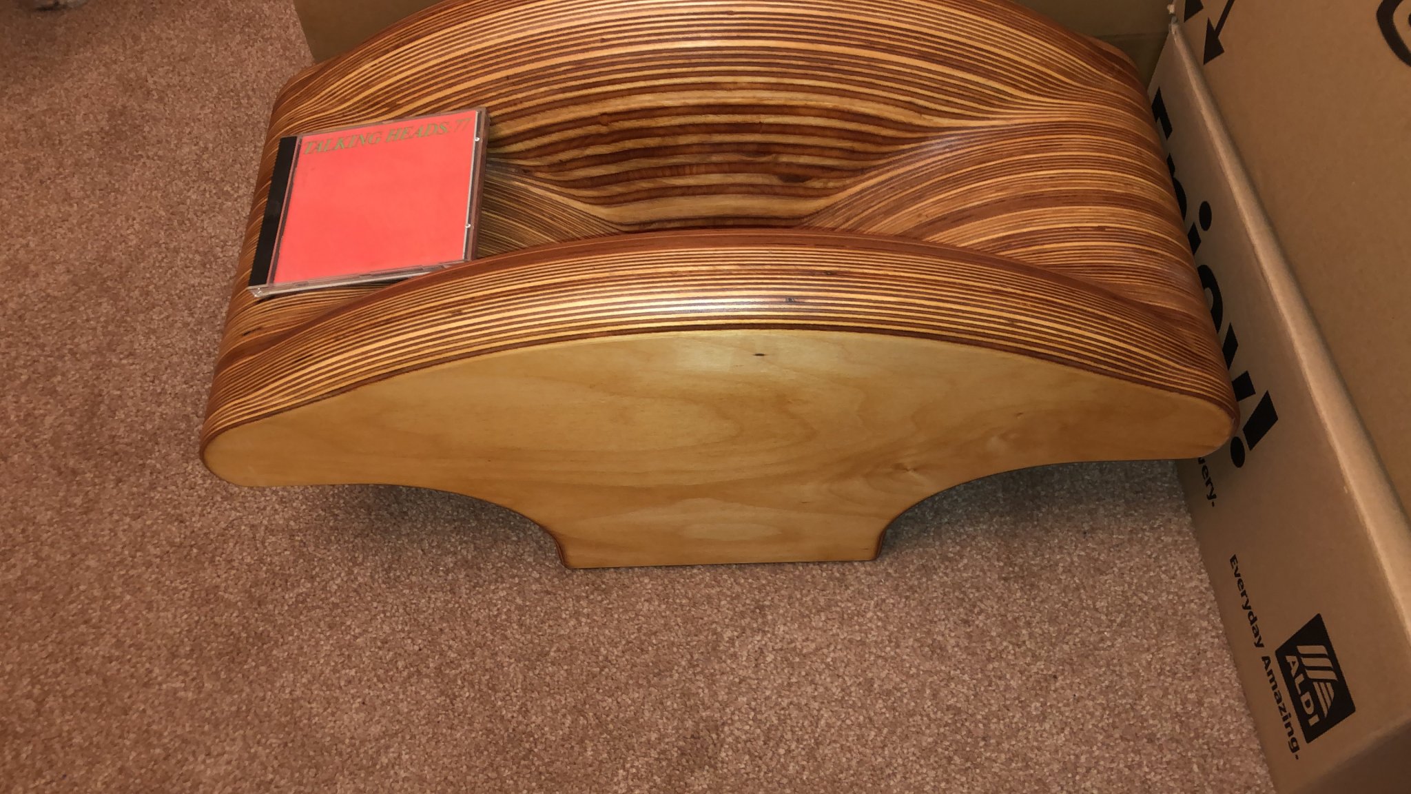

I made the horns according to the old method, with cadastral templates. 😀

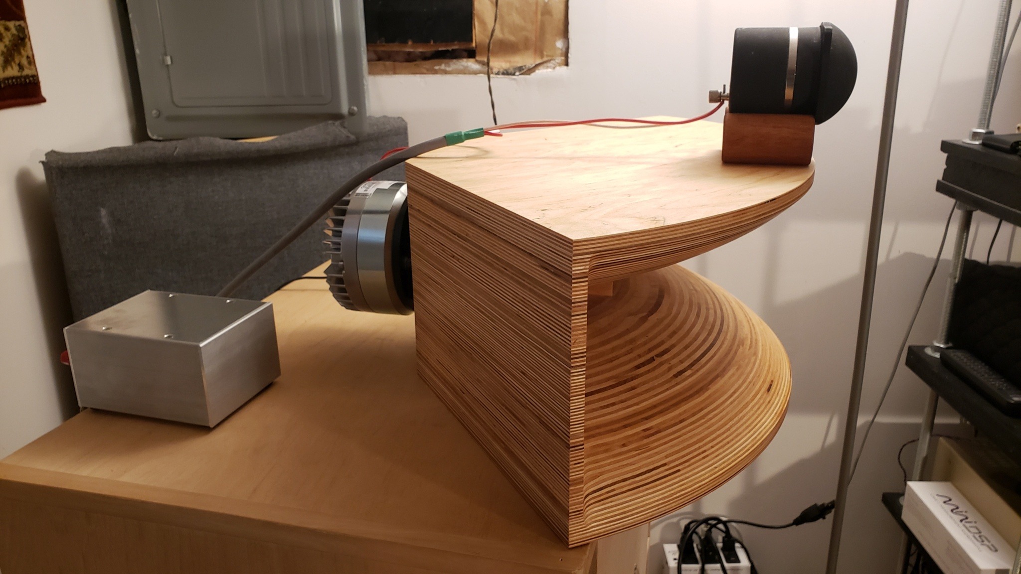

The other news is I have made a decision, and have been in dialog with Athos, and will order Yuichi A-290 and mounting bracketry for the T825s within weeks and the fun starts again.. LOL
I just wanted to let everyone know I got my Yuichi A-290 clones from Athos a couple of weeks ago, so far I am very impressed. The build quality is very good, and the sound quality is definitely a significant step up from the 2380As they replaced. (My subjective impression is that there is more detail, better delineation of multi track vocals, more low level and background detail, less distortion, and a lack of resonances in the horn structure - that CNC'd plywood seems to be pretty stiff.)
The target curves I used for EQ are exactly the same ones used for the previous 2380A horns, new room measurements of course. (Dirac3 running on a MiniDSP SHD). The equalized response should be very similar at the listening position as there have been no other changes to room or system in this time frame.

I had some Athos Yuichi A-290 clones delivered earlier this year as well and I have to say they were a great investment. My 4001s have never sounded better. I thought long and hard about whether it might be easier to have them made locally, or 3D print them, etc. and I think this was the right way to go. If I had a full workshop I would try to DIY it, but you know, I don't...
I have had my A-290s now for a few months and have been working hard to integrate them into the system along with a pair of FaitalPro STH100 horns on HF10AK drivers, and addressing a room which it turns out is even less good than I thought.. LOL
The improvement in performance is pretty significant, but of course no direct comparison is possible since the JBL horns were removed from service and have gone on to a new home. I don't miss them.
Overall a big step forward.

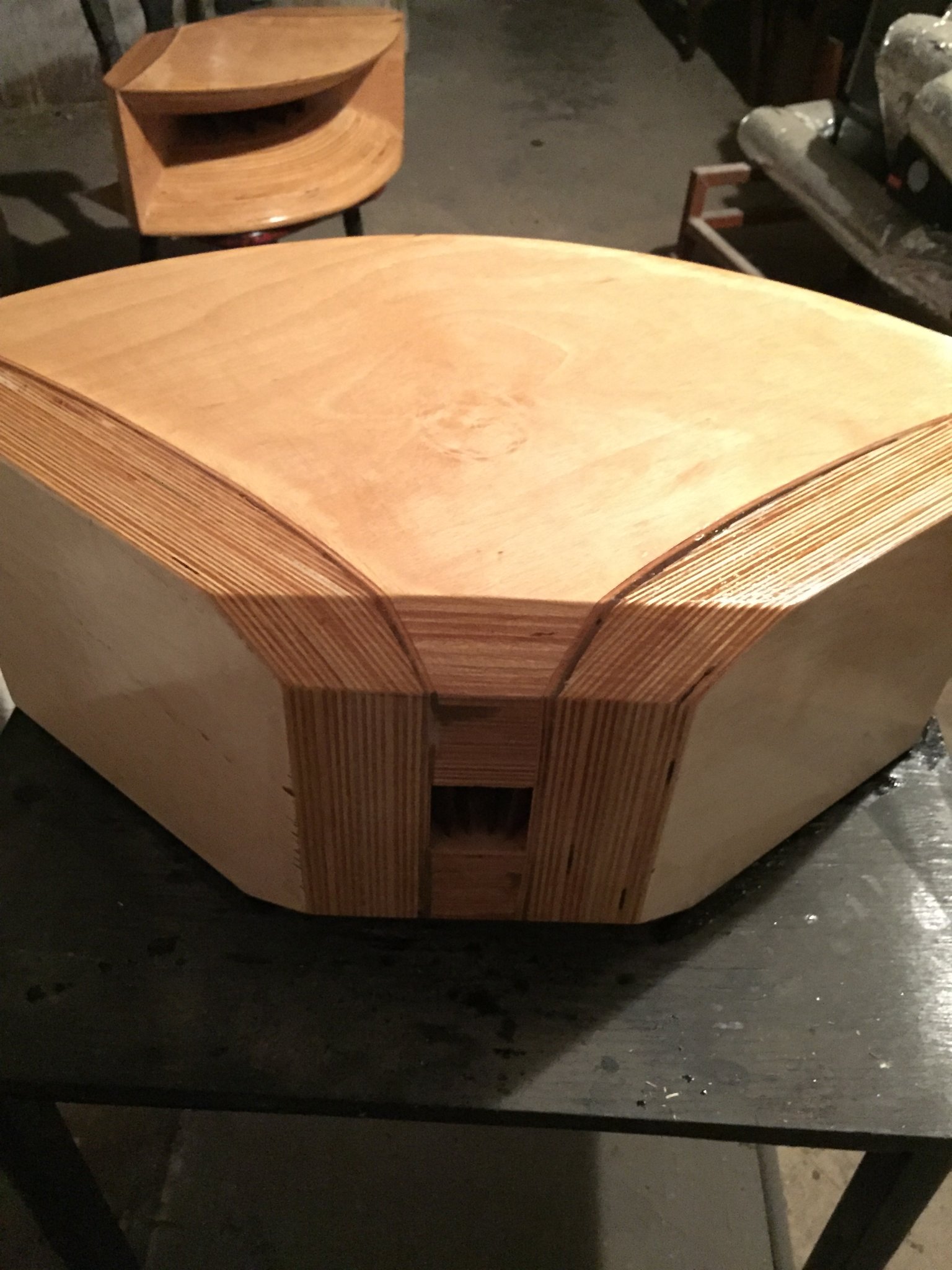

The TH4001 is an extraordinary good horn. Maybe the flare version (Yuichi) are even better but I have no experience.
The magic of the Th-4001 must be in the horizontal dispersion and above 600hz
What you can expect from the horizontal radiation polar was found by our collaboration with @DonVK, @fluid using AKABAK:
It took some time for us to find an appropriate way how to model the different channels inside the horn and we tried many different models with or without interfaces/subdomains. The result is with a 2" round driving source and an appropriate adapter (round to square).
The main difference of TH4001 to Yuichi is that Yuichi has the horizontal flare added which helps to avoid midrange issues. It is not entirely perfect but reasonable good for such a horn.
