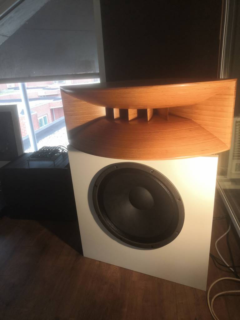

I purchased mine from a vietnamese seller on ebay. I believe they come from a renown hifi shop there. (picture as part of my test setup) I am still contemplating what enclosure would fit well with my faital 15pr400 both esthetically as performance wise.

Nice! The Vietnamese horns I believe are excellent quality, but quite expensive. Whatever I end up with will sit on top of my Onken bass cabs.

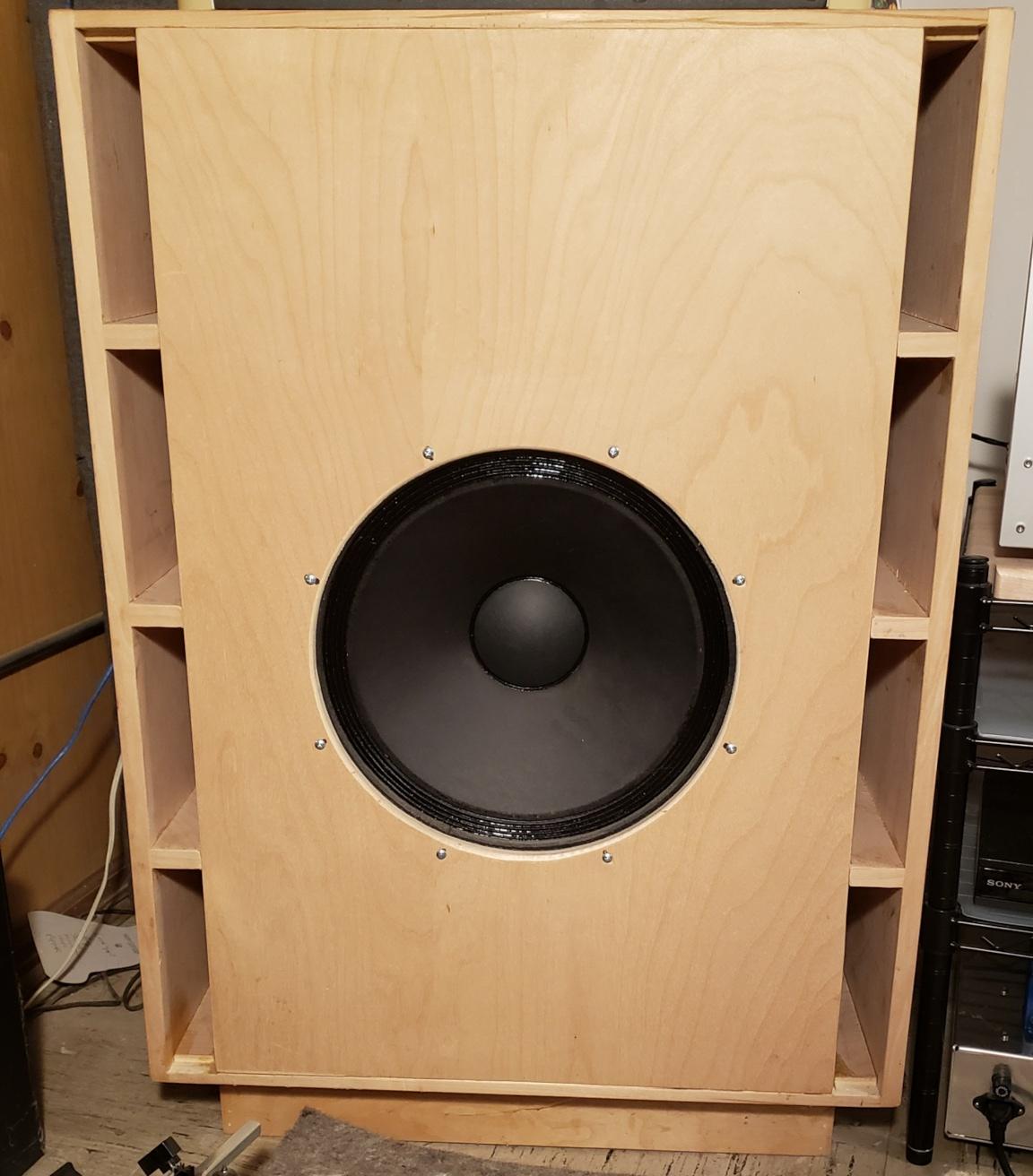

Kevin,
Can you tell us about you bass cabinets? Driver, etc...
I use Iconic 165-8G which is basically the same drive that GPA now sells as the 515-8G. My father in law and I build the cabinets back in 2006 and I did make a design choice that was not the best. Originally I through I was going to mount the mid range driver in the cabinet above the woofer and so I left space for it. I was using the 2391/2392 with 2308 lens at the time and concluded it was not going to be the long term solution - had I known I would have mounted the woofer higher in the cabinet.
There are a number of Onken threads here on diyA and if you search you should be able to find my project. Cabinets excluding the ports are about 11 cu ft (311 liters) in volume, the ports total about 1 cu ft. Internally they have 3 walls covered with 1cm thick felt (carpet backing made of natural animal fibers rather than synthetic, mostly wool) They are made of 95% void free baltic birch plywood. Some internal bracing on baffle and rear panels, heavy cleats front and rear. Baffle is permanently secured from the inside with construction adhesive and screws. Each one weighs >140lbs (64kgs) with the driver installed so I move them infrequently.
The cabinets tuning is in the low 30Hz region, and the R value 2 - 3 ohms (essentially amplifier source impedance.) I no longer remember all of the other details.
I'm happy with them, not perhaps the prettiest ones I have ever seen, but they do work well. (Better than anything else I've owned)
